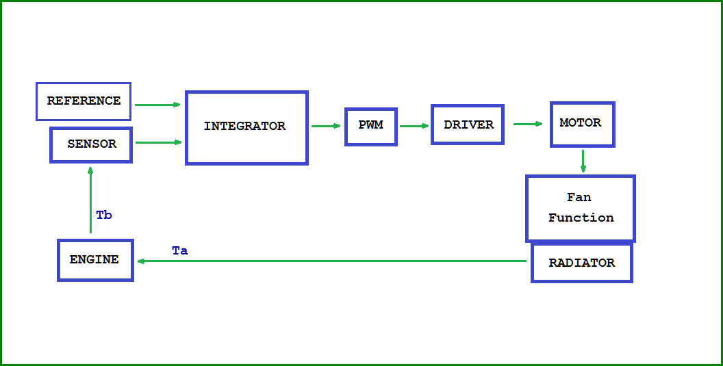

Maybe next we can take a look at a control system block diagram to see what this is all about.

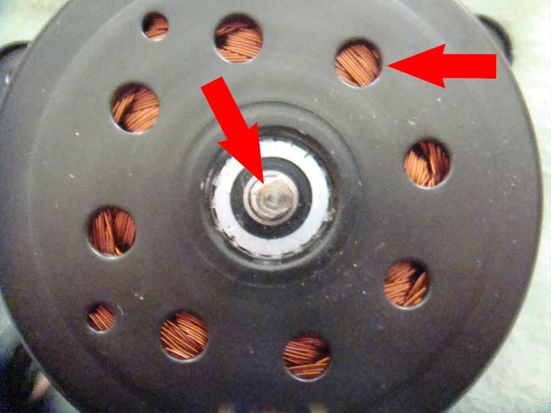

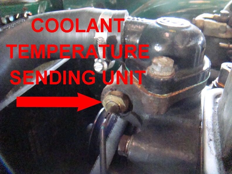

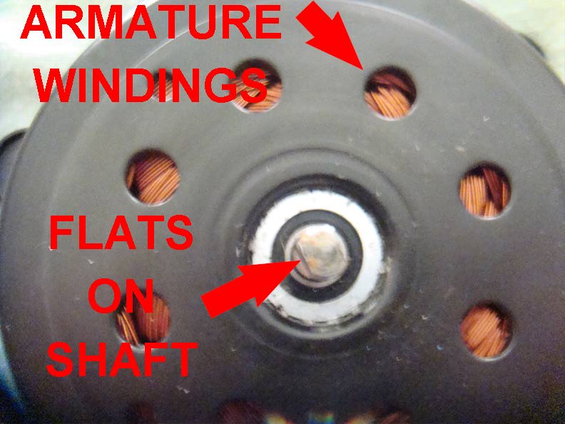

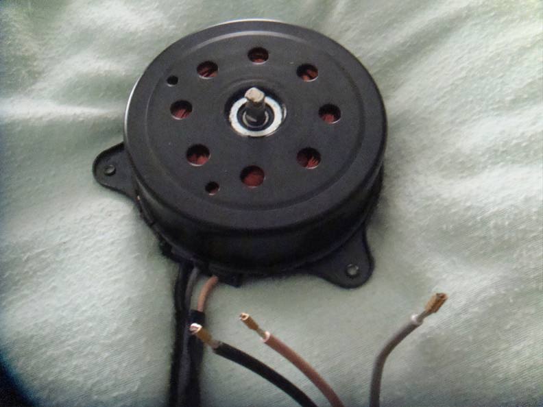

I appreciate all your thoughtful insights, KISS. Here are some photographs.
"MOTOR1" shows the thermostat housing and temperature sending unit mounted to the top/font of the engine. NOT measuring radiator coolant temperature.
"MOTOR2" shows the 3 wires that are connected to the motor.
If you look at "MOTOR3" through" MOTOR5" carefully, you can see how the armature winding rotates with the armature shaft. I assume this means the motor has brushes.

One setpoint can work if it's PI (proportional Integral) control which is what Mr Al suggests in his diagram. We all agree that 0.1 degrees is unrealistic for control.

The Integral term of PI control attempts to make the setpoint and the measured value agree. Think lie a cake mixer. As the load increases on a stupid cake mixer, the speed decreases, so you keep moving the dial. Think of the dial position as the proportion of full voltage. Without feedback, that proportion keeps changing depending on load.
So as the car moves faster, and the same proportion (0-100%) is used, a different temperature results.
e.g. %out = (Setpoint-measured value)*kp)*100 The value of kp, the proportionality constant will change based on car speed, ambient temp etc. The Integral term (not shown), attempts to add or subtract from %out depending on the error.
The integral term can be expressed in units of "repeats/minute", so a fraction of the error is added/subtracted every so often, thus changing the amount of cooling.
Just the difference of the setpoint and the measured value is not enough information to control the motor speed which in turn controls the temperature.
The proportionality constant is normally shown in the denominator in control theory.

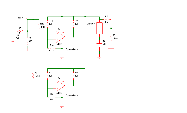

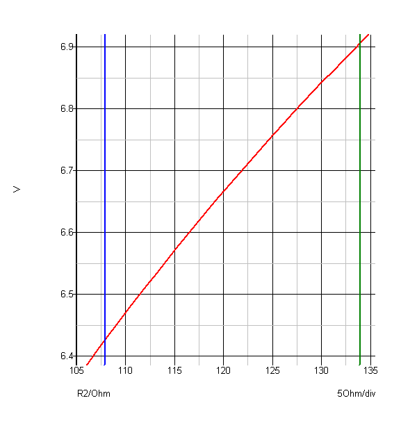

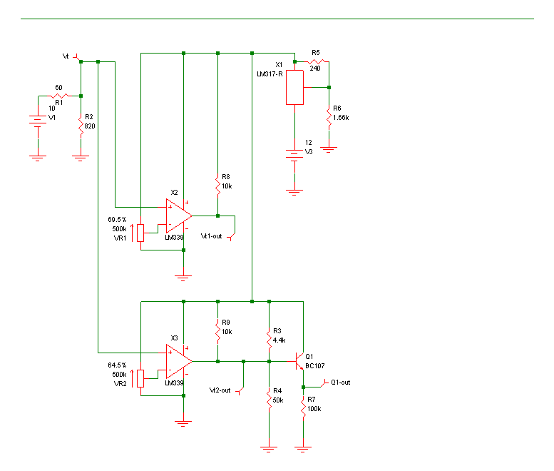

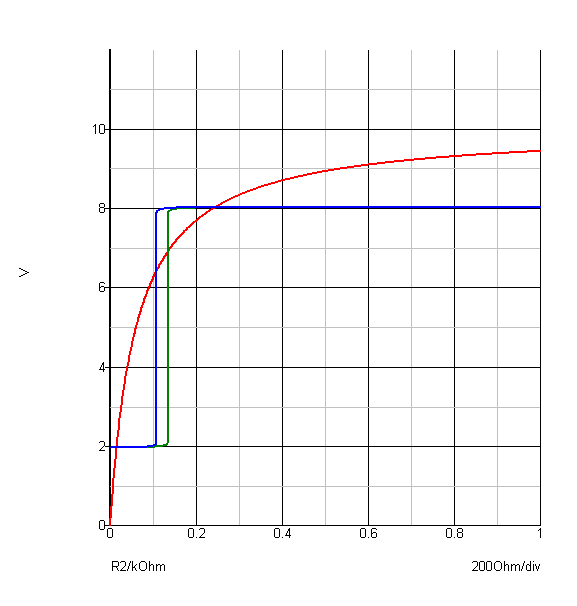

OK, I know when I'm licked. OpAmps are apparently the only choice with regards to efficiency. I'm really trying to not ignore anyone's suggestions. It's just that I need to know what I'm doing before I can try to do what anyone is telling me to do. Here is my latest iteration :
What else do you need to know?
You dont seem to want to go with any suggestions we make anyway, you just go on your merry way back to something that probably wont work. I hate to sound negative here, but you dont seem to like to take advice very well.
For example, who said anything about using an LM318 op amp, where did that idea come from? I suggested an LM358 for a good reason, and i thought i made it clear. Some of the other op amps (LM318 included) do not work well in control applications unless their supply voltages are around plus and minus 15 volts. Also the bandwidth of something like 15MHz is much higher than needed as this will be a very slow control system on the order of 1 second time constant or even longer. But the worst part is the input and output requirements, which make using it that much more difficult. The LM358 works all the way from ground up to about Vcc-1.5 volts, which isnt bad at all. And the output can reach down near zero too and up to about Vcc-1.5 volts as well. The LM318 can not get even close to that with about a 4v margin between supply rails, both on inputs and output. So with a 12v power supply the inputs and output of the LM358 can work from 0 to 10.5 volts, while the LM318 can only work from 4 volts up to 8 volts, but inputs and output.
I am assuming you need op amps, but if a comparator will do then the LM339 should work well.
Your schematic is getting there though. I must say at least now you agree that op amps are a necessity. After testing if you find that you can put up with a little more variation we could always go to simple custom op amps made with transistors. That probably will never be necessary though.

A mechanical bypass switch. During testing it might not go as well as expected. If you are on the road you wont want to have to pull over to wait for the engine to cool off naturally if the control system fails. A simple heavy duty mechanical switch will get you going again even if you have to drive far to get home.
A little attention to detail in an automotive app means we also have to be aware that the power line will be noisy, so some filtering is a good idea and maybe even a zener to protect against over voltage transients.
Also, what are the 1M resistors doing?
The OP said earler that he didn't have a model for the 339. He was also "warned" that the circuit may not survive in the automotive environment.

I'm still not quite understanding why a comparator would be the best choice, since I am going to be using one setpoint for each motor speed. If I could have figured out how to do this part of the circuit using two tansistors instead of OpAmps, I would have. I'm not trying to be so ignorant about this but the simple truth is ...
I am also still considering to use just the hi-speed capability to initially test the basic circuit. If I do that, I may try to allow for a different "turn-off" temperature/setpoint from the "turn-on" setpoint. If I understand properly, this is when it would be best to use a window comparator.
The 1M resistors are my feeble attempt at further reducing any effect this circuit will have on the temperature gauge readings. I'm also attempting to design a circuit that uses the least amount of current as possible and still do the job reliably. Is it totally unnecessary to use any resistor on the OpAmp +(tive) inputs ?
I'm defintiely there already with at least one of your suggestions, MrAl. I installed an override switch to operate the aftermarket fan motor relay manually, 10 years ago. I also included a dashboard mounted indicator light that turns on, whenever the fan motor is running, whether manually or automatically.
My next step in designing this circuit, providing there are not any other glaring errors, is to put in the power resistors that will either connect directly to the motor windings or to relays. I will definitely add components as needed, to help prevent brown-out problems as well as protection from voltage spikes and filters electrical noise from the circuit once I have a "mule" that I can physically test and it works.
I can't thank all of you enough for the help you've given me already. I'm thinking I would do well to post on the simulation software category to see if I can get more library models to use. Anything to avoid pissing off the locals hey ?

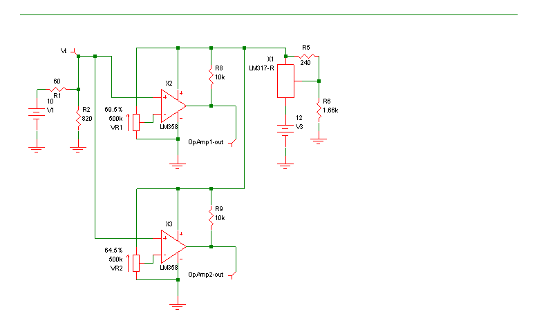

with 358s and variable resistors. 1M resistors removed from +(tive) inputs :
KISS, "Optimized for saturated operation" says it all. ty
Alec T, I look at the Yahoo group, installed LTspice and whoa is me ! It seems the models are not compatible with the software I've been using. It seems I made the wrong choice of freebie simulation software. Now I need to learn how to use LTtspice.
One thing I did learn thanks to Alec T's link is that the LM339 "comparator - not an OpAmp" is in my software's library. It's under "Comparators", of all things. I was looking for it under operational amplifiers. Feeling a little stupid not being able to find it before this. Oh well. Not an unfamilair feeling to me- freshly folded brain tissue.
Guess I need to swap out the 358s with 339s ... with your permission of course, MrAl.

So ok, now you've discovered that there are some serious differences between op amps, and there is some difference between op amps and comparators, and that's very good. For this app the main difference between the LM358 and the LM339 is that the 339 output can reach all the way up to +Vcc (so like +12v with the car engine not running) whereas the 358 can only reach up to about Vcc-1.5v (so like 10.5v with the car engine off). Of course this might not matter depending on what we have to drive with it. For example, we may get away with driving a MOSFET at slow speed, but trying to drive a PNP transistor with emitter connected to +Vcc gets a little challenging because we might not be able to turn it off properly with only 10.5 volts (and base resistor).
Since KISS mentioned that you might not be able to get the LM339 in a wider temperature package (like mil spec) and you can get the LM358 in the right package, we can easily equalize the two by using a resistor and NPN transistor at the output of the LM358 which turns the output into an open collector output which is the same as the LM339. We'll wait on that and maybe we wont need that.
As to any other differences, i know that the LM358 works ok as a comparator as long as the output is ok for the application because i have used it as such in a lower frequency (60Hz) application. Since this project will be very low frequency (1Hz or maybe even lower) the speed should not be a problem.
Driving a MOSFET directly however may or may not be a problem, depending on how much power each switch cycle adds to the MOSFET package. It should not be too much though i dont think because it will be switching so slow (1 second or longer intervals with proper design).
The slew rate of the LM358 is about 0.5v/us, which means the output can go from 0v to 10v in 5us, which should be more than fast enough.
So if you would like to use LM358's or LM339's we should be able to adapt either to this project, as long as you can get the packages in the right temperature category for automotive use (mil spec parts would be great here).
I also dont know what your outside temperature extremes are where you live.
As i was saying in a previous post, a window comparator is made from two comparators as you are doing i think. Normally this is used to switch an output on or off when the signal level is *between* two set points. But for a fan controller it has to be a little different because we want slightly different operation. When the fan turns on it has to latch on, until the other set point is reached, then turn the latch off. That's because the output changes state at times we dont want to switch anything on or off so we have to have a latching mechanism of some kind. This can be a simple latch or we can make up an analog latch with another comparator section. That's up to you. If you look at one of my previous posts i had drawn a schematic of the basic setup. The only difference really is that your circuit would run the two outputs to the latch Set and Reset inputs, that's all.

Difficult for me to get models from the Yahoo LTspice group. As an example I grabbed the first NPN in my library. It's being driven by X3, the hi-temperature/hi-speed control (bottom comparator). If I add one more stage after this, add a transistor which would be powered from 12 V and can adequately deliver enough current to energize a relay at Q1-out, is this how the circuit would look ?
MrAl, Once I have something that works in simulation, I will begin looking for physical components. I understand there will likely be some give and take as far as getting the best I can, according to what is available etc.
