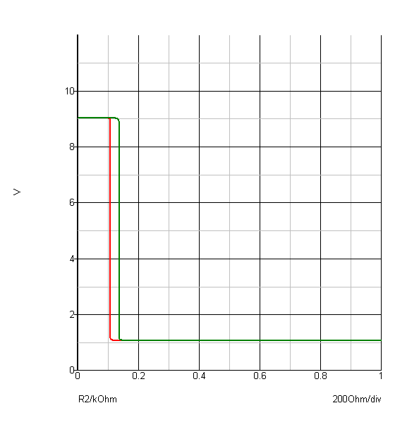

OK, I have run software based simulations on a conglomerate of components and wires. The software is a freebie spice type simulator and I had to learn a fair amount about how to use it, just to get to where I am now.
The circuit I have so far, taps into the wire that connects to the temperature sender. The car, a 1976 Triumph TR-6 uses a heated bimetal piece to move the temperature gauge needle. The heating element is in series and presents around 60 ohms to the circuit. There is a mechanical voltage stabilizer which will be replaced with a standard ic voltage regulator rated for 10 Volts. These "modern" solid state 10 Volt regulators are available specifically for these cars. The temperature gauge is then connected to the temperature sending unit which is a thermister that goes from around 1Kohms cold (below 70 F) to about 53 ohms when the engine is overheating. The thermistor is grounded via the cylinder head that it is screwed into. The gauge and the sending unit make up a voltage divider.
I have determined that the voltage range which I am interested in from this voltage divider, is between 6.2 and 7.2 Volts. I do not want the temperature gauge circuit to be affected by the radiator fan control circuit if at all possible so I selected a MOSFET (2N7000/PS ) from what was in the model library of the freebie simulation software. The extremely high impedance of the 2N7000/PS gate is hopefully what I am looking for in order to buffer the gauge circuit's voltage divider from the rest of the fan controller circuit. The output (source) of the MOSFET runs from about 5 volts when the thermister resistance is at it's highest (1K ohm, engine stone cold) to about the full 10 Volts when the thermister resistance drops to zero ohms (engine super heated to the point of vaporizing).
The MOSFET is powered via another voltage regulator with 10 Volts connected to the 1N7000/PS Drain. Thus the 10 Volt maximum output at the 2N7000/PS source. Also powered by this 10 Volt regulator are a pair of OpAmps (LM741/NS) again from the simulator library. The two 741/NS OpAmps are setup as single supply on-off switches. They are both connected in parellel to the MOSFET output (source). The MOSFET drain is connected to each OpAmp's negative input. Each 741 has it's positive input connected to it's own voltage divider.
What I have now is OpAmp #1 turns off when the Mosfet output(drain) voltage reflects when the thermister reaches a preselected temperature. OpAmp #2 has a slightly higher preselected temperature when it turns off. Next I need to put these two OpAmps outputs to use to drive the fan power curcuits. If you are following this thread closely yo uwil lremmeber that I have a two speed (two windings) fan motor. I want the lo-speed to kick in at one preselected temperature and the hi-speed to kick in only when needed, but at a temperature that is several degrees higher than when the lo-speed turns on.
If I could figure out how to post the schematic, I would. Any suggestions how ?
OK, I just surprised myself. Here is the schematic. I need help obviously. Make any suggestions you want.
OpAmp #1 output is green, #2 is red verses Thermister R2 resistance in the schematic.

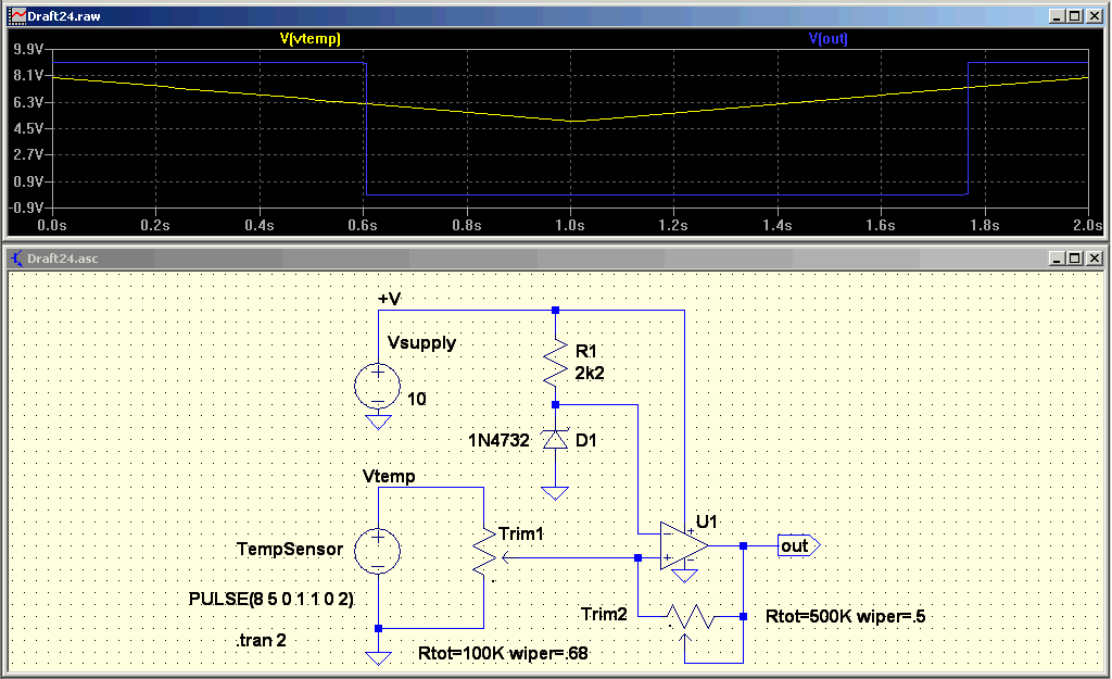

IMO you don't really need the FET to buffer the temp sensor voltage. Providing the circuit input impedance is > ~50k the temp gauge reading will be affected < ~2%.
Here's how you could use a single opamp with hysteresis to determine whether the voltage is in the 6.2-7.2 range.
Trim 1 sets the lower voltage trip point and Trim 2 sets the hysteresis amount, hence indirectly the upper voltage trip point. There is some interaction between the two trimmer settings.
Hi Alec thanks for the help. I'm not sure 2% is an accurate measure for how much this circuit would affect the gauge reading. I think adding another resister/path to ground between the gauge and the thermister (trim 1 in your schematic) would throw the gauge off by the value of the resistor. Here is some more info that maybe I should have included previously ; at 176 F the thermister has 142 ohms resitance, at 194F the thermister has 106 ohms resitance. I think I did the math correctly with 60 ohms from the gauge (R1 in my schematic) to arrive at the 6.2 to 7.2 Volt range. Give or take a few degrees. The 820 ohm resistor (R2 in my schematic) is the thermistor at 77 degrees F. I've been using the sweep funtion of the simulator to run R2 from zero ohms to 1k ohms, in order to see what happens as the engine coolant/thermistor warms up.
In giving the 2% figure I was assuming a worst-case scenario of 1k for the thermistor and a 50k load in parallel.
Trim 1 is 100k and the opamp has a much higher effective input resistance, so 100k in parallel with 1k and the opamp input gives a change of only ~1% in the effective value of the thermistor resistance. You wouldn't observe any change to the gauge reading unless you have Superman vision :D.
Alec, I need to look at the math of what you are saying. I'll incorporate it into just the voltage divider R1, R2 (60 ohm gauge in series with the 0 - 1k ohm thermister), portion my schematic. If I add a 100k resistor in parallel with the sending unit/thermister, I believe the resitance will go from 820 ohms for instance (as shown for R2 at 77 degrees F) to a different resistance according to the formula for two parallel resistors. please pardon my lack of using k in the following paragraph.
R(total) = (820*100,ooo)/(820+100,000) = 82,000,000/100,820 = 813 ohms. 820-813 = 7 ohms. 820*.01 = 8.2 ohms. OK, I see it now. Very little difference. If on the other hand, I use for instance 106 ohms (R2 at 194 degrees F) then the math goes like this R(total_ = (106*100,000)/(106+100,000) = 10,600,000/100106 = 106 ohms, actually a squosh under. OK, I get it. Very little difference. Less than 1% in both cases, just like you said.
Resistances in parallel have a funny way of doing that I guess. What can I say ? DUH ! During my mental contortions putting together this circuit, I did not realize that well enough apparently, when I decided a MOSFET would be a good choice for the buffer. Presumably the trimpot will always show as 100K being in parallel with my R, regardless where I set the turn-on temperature. Am I correct in making that assumption ? If so, then I agree. The discrepancy is so slight that it will hardly be noticeable if at all ... even if I put on my 3.0 "Geezer Goggles" to look at it.
