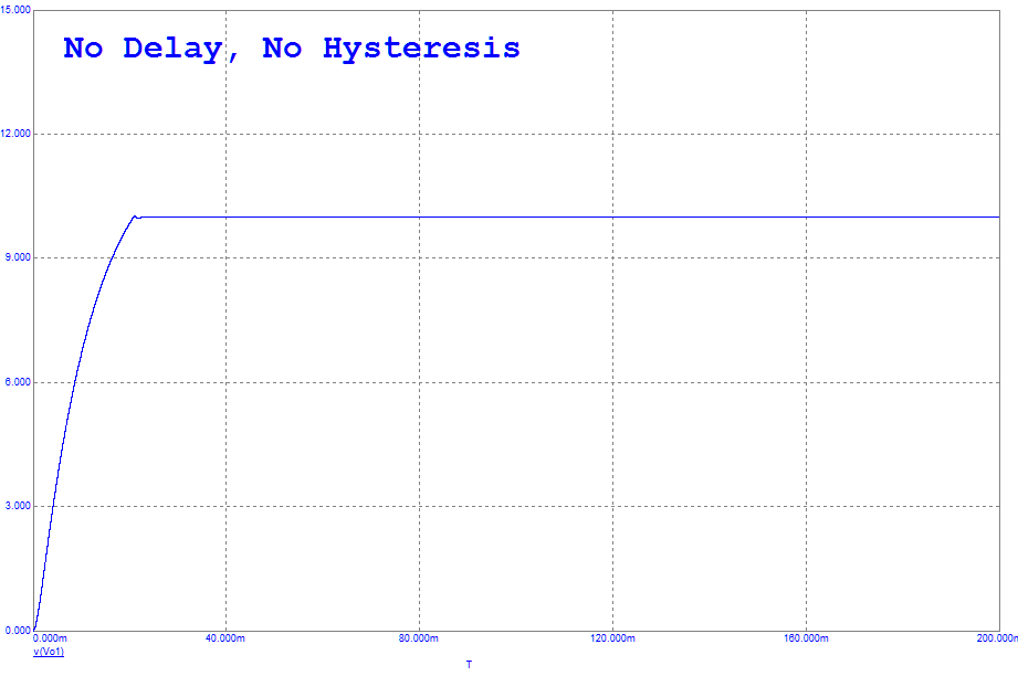

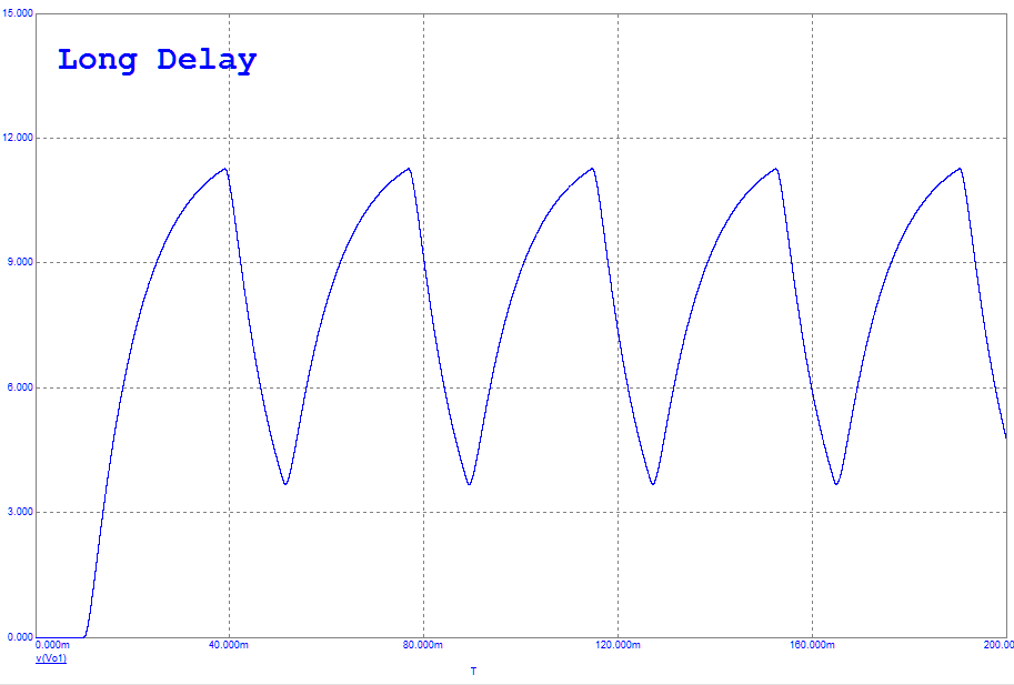

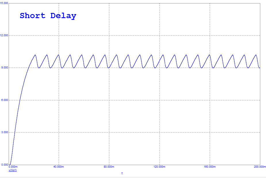

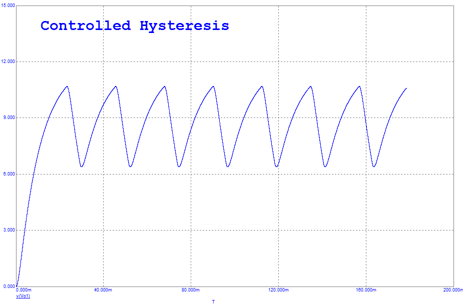

Here are some simplified simulations of the fan controller. The waveforms shown in the diagrams show the variation in temperature of the water at the sensor.
The temperature appears to the left of the graphs, but it is scaled by a factor of about 20, so multiply those values by 20. So 9.0 comes out to 180 degrees.
There are four diagrams, showing:
1. No Delay, No Hysteresis
2. Long Delay
3. Short Delay
4. Controlled Hysteresis
#1 is to show what a linear system or fast PWM system would do.
#2 shows what we see with a single comparator and a long delay between radiator and sensor unit
#3 shows what we see what a single comparator and a shorter delay
#4 shows what we see when we use one or two comparators with built in hysteresis that we can adjust
#1 Controls the temperature pretty well, but that's probable impossible, so we have to use one of the others.
#2 Shows the temperature going up and down quite wildly, but the important point is coming.
#3 Shows the temperature going up and down much less than #2, but the important point about these two (2 and 3) is that the upper and lower temperatures are NOT controlled by us, they are controlled only by the delay, and we have no control over the delay in a real automotive system.
#4 Shows the temperature going up and down quite a bit too, but here it is almost entirely controlled by us in how we adjust the upper and lower setting.
Note that #2 and #4 look almost the same, but the difference is we dont know what the delay will be so we can not really predict that waveform in #2, it might be turn out that it is really looks more like #3.
Note also that the delay varies according to engine speed, so the upper and lower temperature will vary with engine speed. With #4 however the upper and lower temperatures will still be close to the same no matter what the engine speed is.

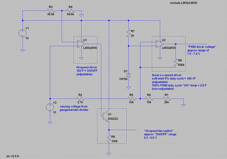

I WANT R8 there to deliberately MAKE that 1/4 of the LM324 to run in the linear range. The lo-speed will be driving a PWM to operate the fan at low speeds/low temperature, if I'm successful.
I removed R3 and R4 from the other 1/4 of the LM 324 which I WANT to MAKE run in the digital (on/off) range. It will be operating the fan hi-speed "on" and "off". It still works exactly the same, without the resistors ! Thanks for that tip.

I'm nearing completion of the .asc file representing the circuit I have, so far. The circuit that seems to work with the other simulation software. I'm still bogged down in utilizing non-LT componenets. I found what to do to get the LM324 op-amp but am now grappling with the BC107 npn bjt. I'll be back with another progress update when I have made some ... progress, that is.
Personally I wouldn't be picky over which transistor model I used, provided it's somewhere in the ball-park. A sim is not real life; just a guide.
I have to agree that picking the transistor for this app probably isnt that critical. In some apps it is but for this one it probably wont matter too much. Just pick one with a similar CE voltage rating or higher and collector current rating or a little higher. Also watch the gain.
For that BC transistor it looks like a 2N2222 would do for now.
It works ! In simulation anyway. This is what I have for now after working with LTspice. Probe the two outputs "PWM driver voltage" and "Hi-speed fan switch". R1 and R2 are my attempt at getting the two outputs somewhere near where I predict they will need to be.

You seem to have mastered the basics, including making use of the 'include' command :).
I realise you're still tweaking things, but why not combine R2,R5; likewise R1,R6? And add a bit of positive feedback to U1?

Since you got that far then you may want to experiment with a little hysteresis in one or both comparators. The attached drawing shows the connection for one comparator and the other one would be done the same way.
The resistor RS can be maybe 1k, and RF can be say 100k. Since 1k is 1 percent of 100k, the percent hysteresis is about 1 percent. That would mean that if the sensor voltage at 200 degrees was 2 volts and the voltage at 300 degrees was 3 volts (perfectly scaled) then the percent temperature hysteresis would be 1 percent, so roughly 200 degrees to 202 degrees, or maybe 199 degrees to 201 degrees. But it's usually not that simple so 1 percent hysteresis does not translate to exactly 1 percent in temperature but could be more or less depending on the sensor. For example, if the voltage is 5v for 200 degrees and 6v for 210 degrees, 1 percent of the difference voltage (6v minus 5v is 1 v difference) is 0.01 volt, and the difference temperature is 210 minus 200 equals 10 degrees, and one percent of that is 0.1 degree, so you see in that case it would be much less then 1 percent temperature wise. If 5v was 200 degrees and 6v was 600 degrees, then the difference temperature is 400 degrees and 1 percent of that is 4 degrees.
That's not exactly how it works but that gives you an idea of how it does work, and some experimentation is a good idea just to see what you actually end up with, unless of course you want to calculate everything more exactly. To do that we would need to see the full curve of the sensor vs temperature, or at least three relevant measurement points.
In the drawing you see RS is simply in series with the non inverting terminal, and RF is the feedback from output to non inverting terminal.

Alec-t, Thanks for hanging in there with me. R5 and R6 comprise a 20k potentiometer. I could not find any symbol or Spice model for a variable resistor/pot.
The Yahoo group has one.
You're right about the LM324. That, and many other opamps, are too slow for PWM at, say, 20kHz (which you may need if you don't want to hear your fan whistling).
