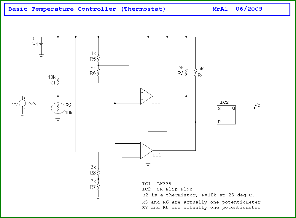

One thing about a window comparator. Strictly speaking, a window comparator puts out one logic level when the signal is between two set levels, and another logic level when the signal is outside these two levels. So that in itself does not make up a fan control circuit because we want slightly different operation. We want the output at one logic level when the input goes above some set point, and we dont want it to reset until the signal input goes below another level, where the second level is lower than the first. So we have to use a sort of modified window comparator.
For a quick illustration, see the two attachments. In the schematic, V2 is a test voltage used to test the control circuit. The output that would be used to turn the fan on and off comes from the output Q of the flip flop.
In the other drawing, the result of testing the circuit is shown where V2 is varied up and down and the output recorded. It's just a test of the control circuit.
See if this makes sense to you. Note that the sensor in this circuit would have an output voltage that DECREASES with increasing temperature, such as a properly biased silicon diode. This type of operation can be easily changed to an increase with increasing temperature though.

The bang bang type of control is of course much simpler which does not require PWM unless we want soft start too.
