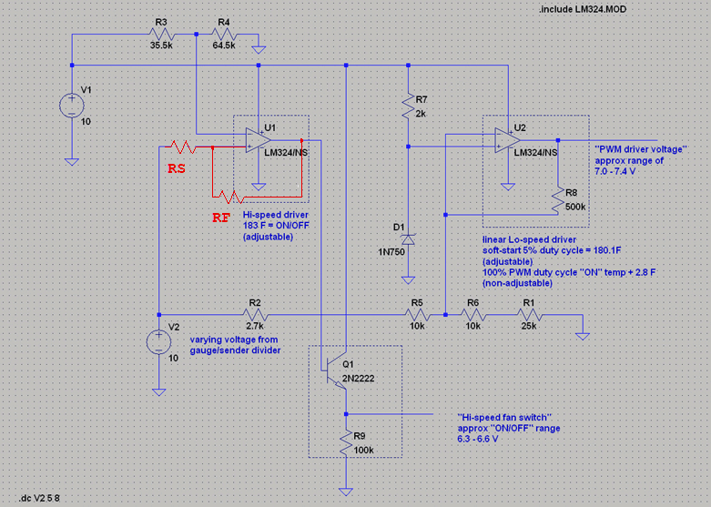

I thought i had attached it but maybe not so here it is again...

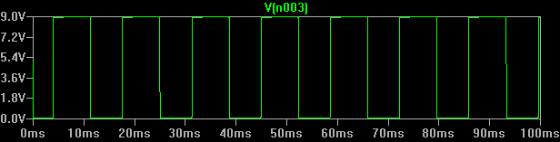

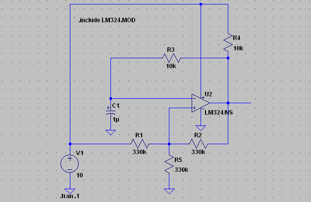

The 5ms square wave shown is the best I can get from this circuit. I have not ahd a chance to try adding components to reduce the voltage. I've taken a step backwards to learn more about rc circuits.
Here is the square wave generator circuit I have come up with using an LM324/NS. It will probably not be what I end up using but it does make a square wave.

Oh ok, well that's very good. It's good to experiment with this stuff and we are lucky that today we have simulators that mimic the behavior pretty well. Not perfect, but we dont need perfect to learn from it anyway. When i first started out many years ago there were no simulators so any experiments had to be done in the lab even if they were fairly simple like a one transistor circuit. Not that we should rely too heavily on simulation alone, but it sure is a good learning tool.
Just one small point. The 'pullup' resistor is not needed with a op amp. A pullup is usually required with a comparator because they usually have open collector outputs. But then again the pullup is usually smaller than 10k because a large pullup creates a problem with the output waveshape. If you feel like looking at that you'll see the difference in waveshape on the output.
As a rule of thumb without any pressing special requirements, the min half cycle period we would want would be about 10 times the approximate rise and fall times. So as a guide if the slew rate is 0.5v/us and it has to reach from 0 to 10 volts that means it takes 20us to do that. That in turn means we want a min half cycle period of 200us. A min half cycle period is around 200us so that's 5ms, and that makes the whole output period about 10ms, which is 100Hz. So you see how the slew rate can limit the frequency severely.
Lower the voltage to 5v and we can get twice that in theory. Of course this is just a rule of thumb and there will be times when we dont need 10 times the total slew as the half period, such as when the output is followed by a Schmitt Trigger gate of some kind which squares up the output anyway.

A pullup is usually a resistor connected to a terminal of a device that will apply Vcc to that terminal through that resistor (and thus current limited). The reason for a pullup is because that device's terminal can not reach up near to Vcc by itself, yet needs to be about to get to near Vcc in certain modes of operation.
For many comparators, they have a open collector output and so the output can not source any current, it can only sink, and so it needs a pullup resistor so it's collector can get up near Vcc when the transistor turns off.
A pulldown is just the same except it would be used when the device needs to have a ground level DC signal applied during certain modes of operation. It cant get down near ground by itself so it needs a little help from a resistor.
You might be able to use feedback to limit the output voltage level for an op amp, but why go through all that when you can use a 555 timer IC and have it be done, if all you want to do is generate a square wave.

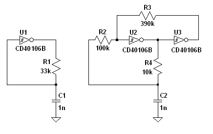

If you want to experiment with square-wave generators, here's a couple, simple in the extreme, which will easily do >100kHz.
Approximations of triangle waves (good enough for use with PWM generators) can also be taken from across the capacitors.
The second circuit effectively extends the hysteresis of the Schmitt inverter to increase the amplitude of the triangle compared to the first circuit, and provides complementary outputs from its two inverters.

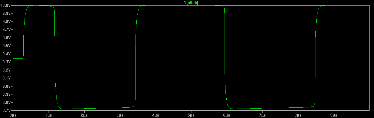

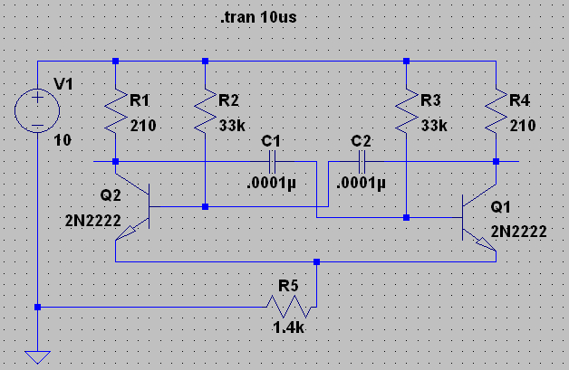

I have an astable multivibrator circuit that makes square waves at 40kHz ... at least in the simulator. I had to make it operate in a narrow voltage range to get the 2N2222 transistors to switch that fast. Maybe I can find faster transistors but for now, I'm going to try to narrow the pulse width "on" time to see if I can increase the voltage swing.
I've already made some attempts at having this 40kHz circuit drive a MOSFET and met with some success ! Problem is that I cannot figure out how to get the MOSFET to turn on and off fully with the square wave (pulse) voltage swing being only 1.3V
