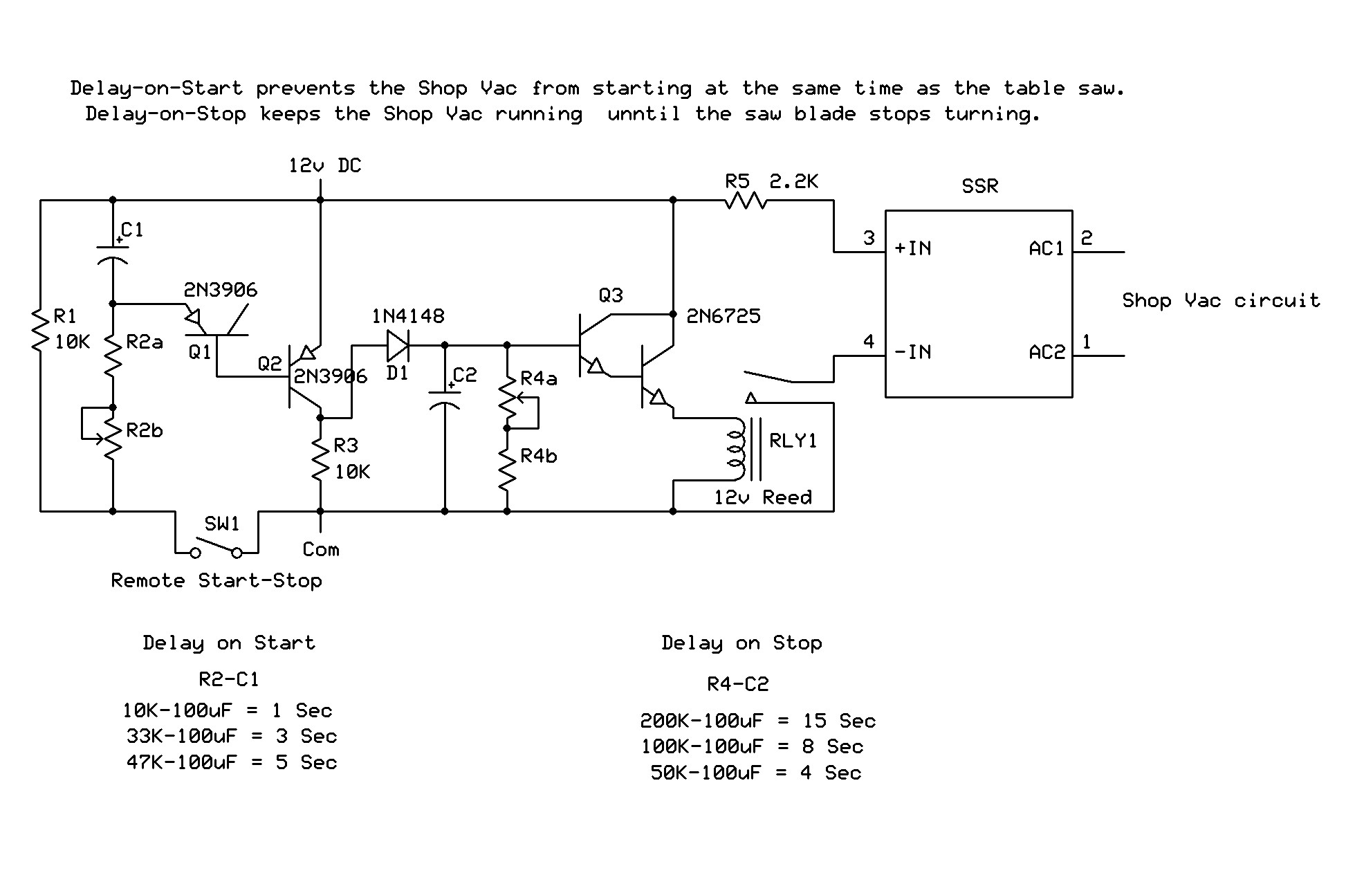

I finally got the remaining parts for this project. I was so excited i soldered one up on a board only for it to have a short somewhere. Even though I tested components for function my eyes are not good enough to see where i crossed a wire or two. I took a breath and bread boarded one up and it worked fine. Well almost. The on-delay is great 2-3 seconds and the 50k pot with the 10k resistor gives a tiny bit of play but not much. My issue seems to be the off delay. It has none. it just shuts off when i simulate an open circuit on the (-negative) side. Im going to post my picks and my schematic in hopes you can help me figure this one out. it could be that im not simulating the switch correctly but my readings show the circuit getting voltage where it should.
NOTE: Take a look at 2n3904 on my schematic. the pinout does not match that of the manufacture. i followed the manufactures pinout. AND on the picture i got from KMoffett does not look like a 2n3904. At least not like mine does.

According to this link: 2n3904 pin#1 is the emitter and #3 is the collector. Maybe you simulator is in error. Other than that and the added resistors and LEDs, it it looks like mine and should work.

You have the contacts of the current sensor connected so it interrupts the power ground to the output control relay, rather than just acting as a signal to the timing circuits.
As soon as that opens, there is no power to the right half of the circuit.
It should only be controlling the charge / discharge of if timing networks and not power to anything.

rjenkinsgb is right. Note where the common is attached in my circuit. Attached.

I have redone the bread board mock up removing all the spaghetti leaving only two strands that simulate the SSR (ran out of room on board)
I am a novice and i place the blame of this venture squarely on the shoulders of the pandemic (and lots of beer) thinking that I can do this. Anyway I have spent lots of time on this and my OCD is kicking in and not allowing me to give up but i do have this issue that i cannot figure out.
Delay on good. Delay off not good. in the simulation of the sensor going back to its rest state of open the relay looses ground. I appreciate the suggestion and i do agree so perhaps a schematic is not the same as the physical layout and i am simply wiring this wrong? This design is of a member and he has this working so i do believe this can be solved. Please take a look at my new photos and help me out with this. I want not only for this to be a sucess for me but for the group as well. i plan on posting the housing plans (box, SSR, outlets, case design) when this is done so anyone can duplicate this for their own workshop.

What are you seeing with the problem boards? Is there any functionality?
The schematic and your sketch appear to agree. Except:
1. The OFF delay pot in the schematic is 200KΩ. In your sketch you have 200Ω. Miss labeled?
2. The OFF delay resistor connected to the pot is 47K in the schematic. In your sketch you have 47Ω. On the board it's a 470Ω resistor.

thank you so much for replying. ive tested all the resistors and pots and compared them to the schematic and they are correct. 200k, 47k.
the fact that you verified that my sketch is correct is a very big help. yes i kept all my breadboard setups. i wont disassemble until ive solved this.
Of the three that i have soldered the last one worked the best. it would trigger the delay on but would not turn off after i opened the switch. i could not explain why it did that. Ill post the bottom of the perf board when i get back. thank you again.
ok i have the pics of the back of the board. i soldered up the components too. i have not tested it yet. my soldering is better partially because i invested in a quality tip. all the joints are solid and shiny. the only connection you cannot see is from the 200k pot to pin 2 of 3904. its on top of the board. i flipped and rotated the sketch to help me make the connections while the board was turned over.
