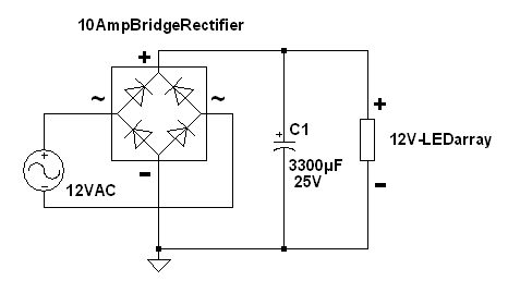

I have a soldering iron and am willing to learn but have no idea on how to do what dougy83 above has suggested though it sounds fairly easy-ish. I'd need a pic of how to assemble something like that to be honest though, wouldn't mind if any knew of a good website where you can learn basics or at least where to start on little projects like this and other 12v LED type stuff.
If you're happy with just rectifying the AC into 100Hz pulsed DC, which I believe is all the first ebay converter unit you linked to does, then just get a bridge rectifier from the local shop. It has four terminals, each labelled with '+', '-', '~' and '~'. The two labelled with '~' connect to the 12VAC from the power supply. The '+' and '-' terminals connect to the appropriate terminals of your LEDs.

Adding the capacitor also increases the RMS voltage, which will increase the power dissipated by the LEDs. Using a 4700uF will double the power dissipated for a single 10W LED string. With 5 LED strings connected, this increase will not be as much (nor will the flicker reduction)

Try without first. If you do decide to add the 4700uF, you should make sure all five LED strings are attached (or use the voltage dropping technique mentioned above). The 16V caps will be working close to their rated voltage, but should be ok.
If you want to try rectifying the 12VAC, here's how you would connect things:
The capacitor smoothes the rectifier output somewhat, to give an average voltage of about 12V across the LED array with the value shown.
There is a trade-off. A higher capacitor value would provide better smoothing (less ripple current) but would increase the average voltage (which the LEDs might not like), would cost more and would be bulkier. You could even try omitting the capacitor (which results in a 15V peak voltage but an average voltage of about 9V).
Wow, that's awesome and shows me how the bits all wire and/or fit together. Thank you ever so much.
What actually is Ripple? is that the fluctuation of voltage between say 9v-15v or something else.
