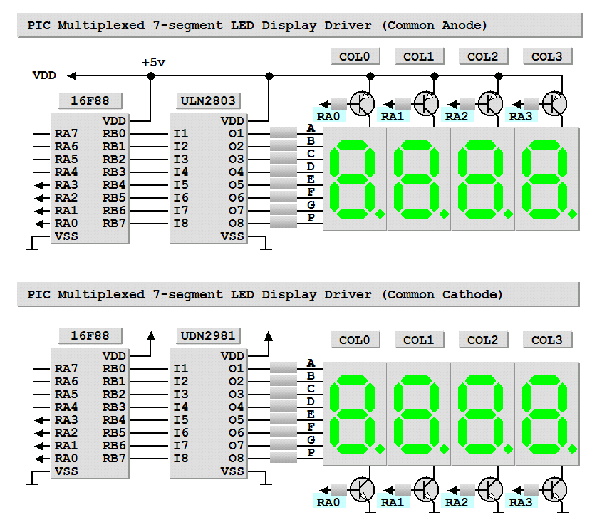

Those display specs' are per segment. If you want the brightness that 15-ma "average" current provides you'll have to bias each segment for approximately 60-ma "peak" current on your 4-digit (25% duty cycle) display. There's no way you can get that much current through a PIC I/O pin.
It's more likely you'll get about 20-ma from each I/O pin which when multiplexed at 1/4th duty cycle will provide about 5-ma "average" current per LED. That's about 160-ma total if all eight segments are lighted in a particular display which is obviously above the total current spec' for the PIC but I think you'll find that it works fine and doesn't burn up the PIC.

Then use one of the many parallel driver ICs or serial-to-parallel driver or constant current driver ICs.
For example, replace the 74HC595 in the drawing below with a 90-ma per pin TPIC6C595 (or an MIC5821, or an A6821, ad infinitum....).

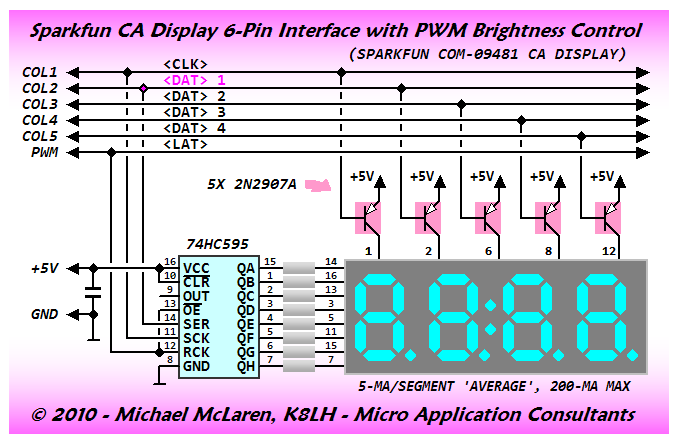

I think that's an awesome solution, once I go C- anode.
Your diagram shows 5 PNP, but I guess the extra is for the colon. Will a regular colon-less display work with 4 pnp?
If so that should just use 5 lines from the PIC, which helps, cause I was 1 pin short overall and was gonna have to do some antics to save a pin.

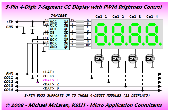

I did attach another drawing for common cathode displays. The only serial-to-parallel sourcing driver that I'm aware of is the Micrel MIC5891.

Would u have a code sample for that application?
I have an example app' for the 5-pin CC drawing but it won't be very useful to you.
Yes, use four PNP for a "normal" 4-digit CA display or four NPN for a "normal" 4-digit CC display.
Yes, five pins for the display. You can also use a single I/O pin to read up to four switches by driving the switches from the four column select lines. You'll need one signal diode per switch. Switch software is a breeze.

I threw together an example program in BoostC for the 5 pin 4-digit Common Cathode display.
If you're interested I'll add the few lines of ISR code for sampling and debouncing up to four switches on a single pin (a column driven switch matrix).

5-pin-4-digit-modular-png.44730

Yes, almost all of the serial-to-parallel drivers are sinking drivers or constant current sinking drivers with open collector or open drain outputs. The only serial-to-parallel sourcing driver I have found is the 500-ma Micrel MIC5891 and it's a beauty. It has seperate VDD and VBB pins and so you can easily drive higher voltage displays (white, blue, or large displays with multiple LEDs per segment) with TTL signal levels from the PIC.

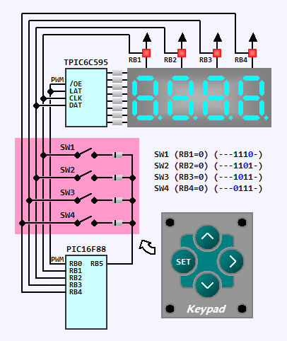

So, you're leaning toward a common anode design similar to this one (16F88 with PWM output on RB0)?
mosaic-1-png.44791
Sample and debounce switches by taking advantage of the column select bit patterns on the RB4..RB1 pins which are '1110' (col 1), '1101' (col 2), '1011' (col 3), or '0111' (col 4). The RB5 switch input pin is using the internal weak pull-up. So you sample one switch during each 1-msec column update interrupt and each switch is sampled in sequence once every four interrupts (once every 4-msecs).

I guess the diodes are to permit s'ware control of the pull up, by floating any low signals?

The signal diodes isolate the switches from each other and from the column select lines. Unlike Colin55's projects, I prefer not to mess up the display when I press push button switches (grin).
