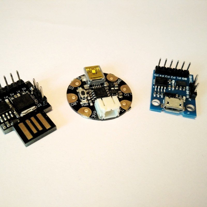

If you need a separate processor to develop the trigger could use an ATTINY85 and
mBlock to do the counting/Vmeasure/sensor interface, here is example sensing V -
You drag and drop functional blocks out of window 2 to window 3, config, and mBlock
will generate the Arduino code to program an attiny85 (an 8 pin AVR processor). Use the
UNO to program the ATTINY then revert the UNO back to its "normal" code. or just use
USB and appropriate driver to do the programming.
Regards, Dana.
