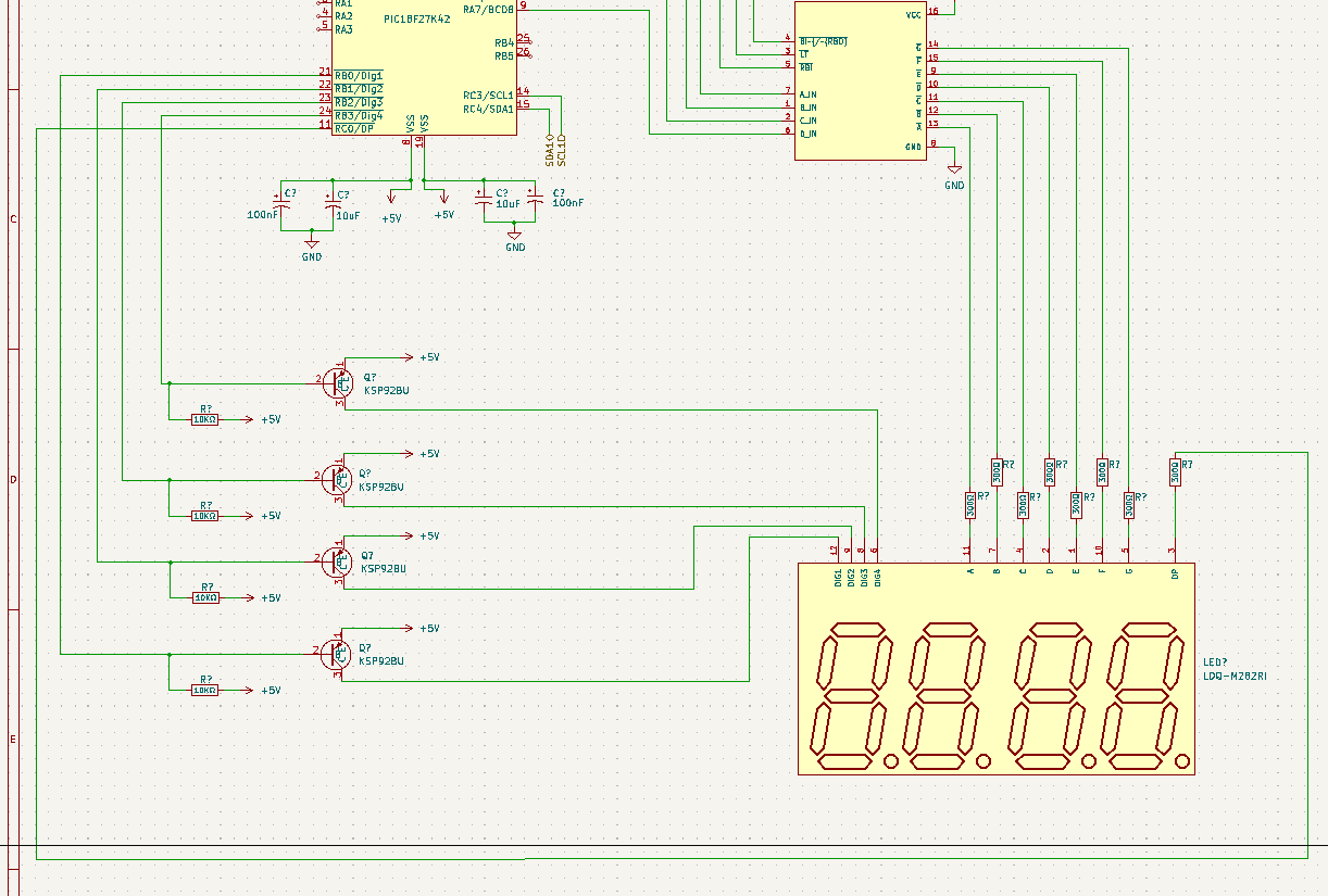

After a lot of reading and research I came up with the following in my design:
I change the transistors to PNP type and added the pull-up resistors.
For the relay as you can see, I sank the coil with a NPN transistor and added a pull-down resistor on the base.

You've missed out the far more important resistor from the I/O pin to the base of the transistor, the pull-down resistor is optional (and hardly ever required), but the series one (as shown in my tutorials is important, and should always be fitted).
Nigel Goodwin I went back and looked at your tutorial and indeed I did forget them. Thank you for pointing that out!

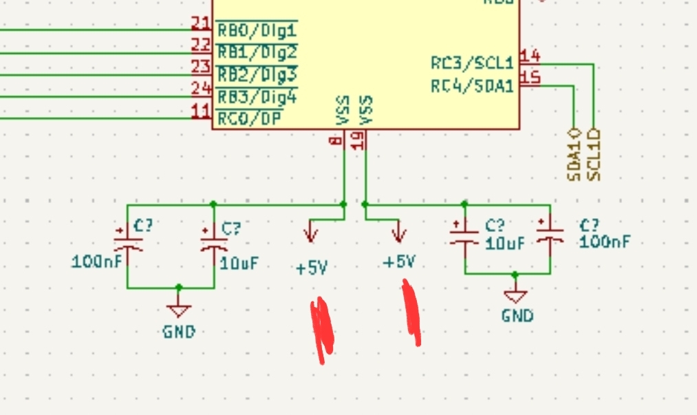

I hesitate to even post this since my previous comments have been ignored....

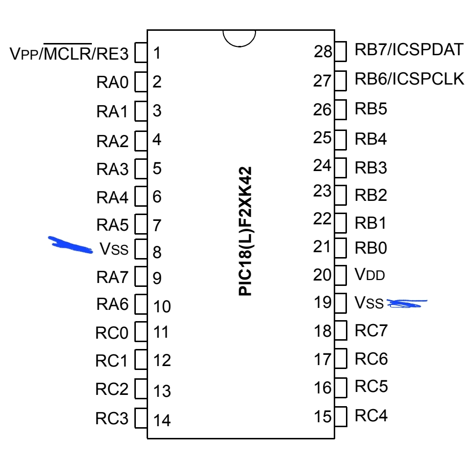

I happened to notice at the edge of your schematic 0.1uF and 10uF bypass caps connected between pins 8 and 19 and ground. Pins 8 and 19 are also shown connected to +5v. Pins 8 and 19 are Vss, which is GROUND. There goes the magic smoke!
Pin 20 is Vdd = +5v supply
Pins 8 & 19 are Vss = ground
You only need bypass caps between pin 20 and ground.
BOTH pins 8 and 19 must be connected to ground.

For The Popcorn I am glad you pointed that out as I have had some confusion on the symbols. One article I read said that Vss = Voltage source & Vdd = voltage drain. I will have to do some more research. Thanks for pointing it out!
It does - but drain is positive and source is ground. The source and drain refer to the FET connections inside the chip (source, drain and gate are the three connections to an FET)

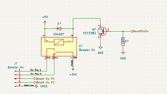

Booster Vlv St & Booster Vlv Op are inputs to the MCU for valve position, do I need a current limiting resistor on an input pin?
No, but you probably want to move those two lines to the other side of the 100R resistors.
Right now the input levels are just going to be the forward Vf drop across the LEDs (so about 1.6-2.2V, depending) which is likely too low to be a valid input logic high level.

I agree with tumbleweed, move the feeds to the other side of the 100 ohm resistors - and are you wanting the LED's particularly bright?, 100 ohm is fairly low, I usually use 330 ohm or 470 ohm for feeding LED's, and that seems plenty bright enough
Adding series resistors would do no harm though, but as long as the 5V feed to the opto-couplers is the exact same feed as the one to the PIC, there's no issue. However, if the 5V feed to the opto-coupler should increase (such as it's fed from a different 5V source that goes high), then that voltage will feed through the protection diode in the PIC and increase it's supply rail, possibly to destructive levels. A series resistor limits the current, and prevents this.
All from the same power supply.
