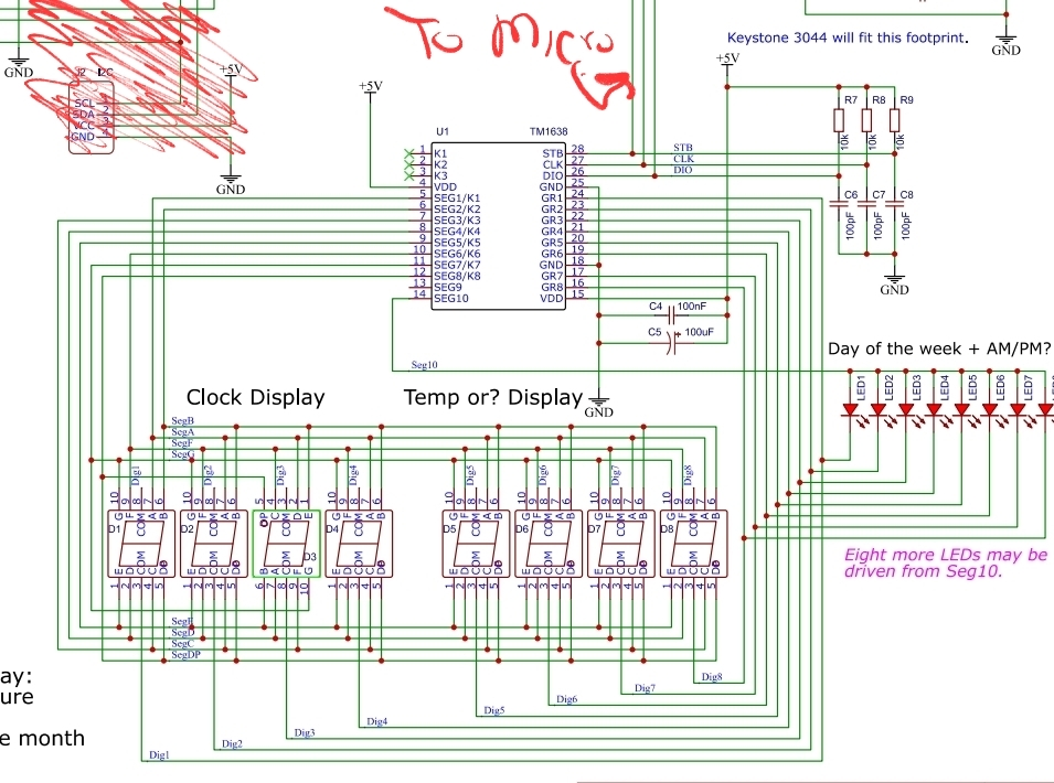

You might consider the TM1638 that I've mentioned in your other thread.
If you use one of these 25 cent chips (available at LCSC), you can eliminate MOST of the components in your schematic for driving the LED display, and simplify your code requirements.
The TM1638 would use a 3 port pin interface to the MAIN micro (eliminate the second micro entirely). It will drive up to 8 7-segment common cathode digits directly (eliminate the shift register, transistors, transistor base resistors, LED current limiting resistors). "Segment pins" 1 – 8 are connected to each digit's A – H segment pins in parallel. "Grid pins" connect to each digit's common pin (i.e., Grid1 to left-most digit, Grid2 to second digit and so on). If you have other individual LEDs to drive, Segment pins 9 & 10 may be used to drive up to 16 LEDs (LEDs connected between a segment pin and a grid pin).
The software need only send 16 bytes, where each bit turns on or off a particular segment, when you want to change what's displayed. Otherwise, no action is required.
The LED brightness is also controllable over 8 steps.
Here is the display section schematic I'm using for a multipurpose clock I'm working on. It might be a bit more clear than the bus nomenclature of the datasheet.
The only weirdness I have here is that the 3rd digit is rotated 180° so I can use the decimal points as a colon for the time. I remap it in hardware so I don't have to mess with it in software.
If you use a multiplexed 4 digit display, the connections are simpler. Eight wires for the segments and 4 for the digit commons.
I'm trying to find the top of my bench so I can get some boards assembled. I'm sure it's down there somewhere
