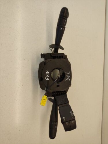

i bought used stalk for 20e on the car trash. connector is the same only this stalk has variabile intermittent switch plus iz has for the rear wipers as well. will try and see
i tried stalk from junkyard one with variabile resistor plus rear wiper and intermittent wiping now works but only if the variabile switch is on the highest speed. the intermittent function is also useles as it takes 4 seconds between wipes, but you need 1 or 2 sec at most.

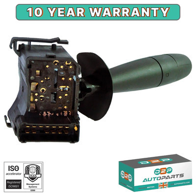

OK, the fact it works at all with the other switch shows that the fault is in the original switch.
Is there a part number label on that original one?
This appears to be appropriate? From that listing, it's the same one for multiple vehicles and fits a Mk2 Master.
yes original stalk has the number 8200481072, the part from the junkyard with varistor switch has the number 8200328895.
with this stalk wipers work as they should but would like to have the varistor switch to be in function since 4sec pause between intervals is too long and not realy usefull.
do you think it can be done with this bcm or would i need to change it?

Searching the original part number actually brings up parts from or compatible with a 2007 Master!
eg.
Re. the wiring, from the look of it a relay with the coil between A1 and ground, and contact between A6 and A3, should bypass the failed contact in the switch and get it working without any additional electronics.
(A1 and A7 are shown reversed on the 03 drawing; A1 must actually be the fused power feed for the wiper to function at all, so A7 is the output to the BCM that is powered in the intermittent position).
