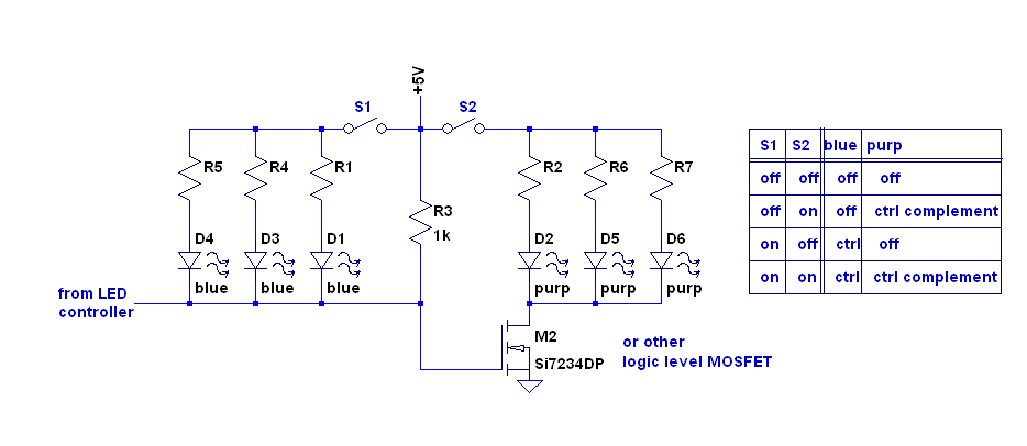

Look at this and see if you think it will do what you want.

Cygnos, I had the same reaction as hero to your first two posts. Your questions were incomprehensible until I found the part number of your controller in your other thread, and then Googled it and found this site, which has schematics of it. Then I understood that the controller was just basically MOSFET switches to ground, controlled by a microcontroller.
I was still annoyed with you, but I understood your frustration and decided to design a solution. I'm still not sure of your requirements, but I think that the circuit I posted will work.
The circuit you posted with the inverter will not drive a bunch of LEDs. I didn't attempt to figure out the functions of the switches.
The circuit I posted does the following (as in the table on the schematic):
1. If both switches are off, all LEDs are off,
2. If S1 is on and S2 is off, the blue LEDs will do what the controller commands. If the controller says fade up, they will fade up. The purple LEDs will be off.
3. If S1 is off and S2 is on, the blue LEDs will be off. The purple LEDs will do the opposite of what the controller commands. If the controller says fade up, they will fade down, and vice-versa.
4. If both switches are on, and the controller says fade up, blue will fade up, and purple will fade down, and vice-versa.
You need to have patience when requesting help. If we understand your wishes, we will try to answer your questions. If we ask question, it is usually not because we are nosy or curious (but sometimes it is). It generally is because we don't have enough information. If you get impatient and rude, we may tell you to piss off.
