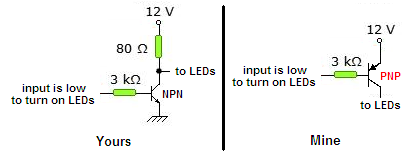

Will this circuit work and do what I want it too.
The transistor blew without the 80ohms resistor, and it is stopping the current feeding them, it's power source comes through the transistor, and when there is a power source going to its base the inverted circuit power flows to ground. Need to have a selectable point for ground because the way the chip is set up, you just have the ground point for all the LED's you want to control connected to a point on the chip, I was told that if I'm using an inverted circuit I should stop it being connected to the controller (going to a ground point on the motherboard instead of grounding via the chip).

You have 80 ohms powering many LEDs then you use the transistor to short ythe LEDs to turn them off. That is backwards.
Maybe when you removed the 80 ohm resistors then you replaced them with shorts. No wonder the parts blew up.
Usually the power is appied to something to turn it on then the power is removed to turn it off, it is not shorted to turn it off.
Your circuits have extra switch contacts switching the ground that does not need to be switched.

It is stupid to short the power source to ground with an NPN transistor instead of simply disconnecting the power source with a PNP transistor.
When your NPN transistor turns on its current is 12V/80 ohms= 150mA. The power that is wasted in the 80 ohms resistor is 1.8W.
In your home do the light switches short the lights to turn them off? What about the smoke that will be created? Who will pay for the tremendous amount of power that will be wasted?

Don't short circuit the LEDs to turn them off. Simply use a PNP transistor that will turn them off when the input voltage is high like this.
Your 60 ohm resistors will need their value increased a little.

Your missing the point, I need to turn the LED's on when there is no input whatsoever, and turn it off when there is an input. When a PNP transistor has no input the switch is off. As I said its a switch not an inverter. The LEDs on the inverted circuit would still be on when the input is high or low, its either on (with an input to it's base) or off (without an input to its base) I need it so the inverted circuit is on when there is no charge to the base whatsoever and off when there is an charge to its base.
Your circuit does not show an input. It shows the input to the 3k base resistor shorted to +12V to turn on the NPN transistor that short-circuits the LEDs to turn them off.
My circuit also has the 3k base resistor shorted to +12V to turn off the PNP transistor then the LEDs do not turn on.
The LEDs in yours and my circuits turn on when the input to the 3k resistor is grounded.
