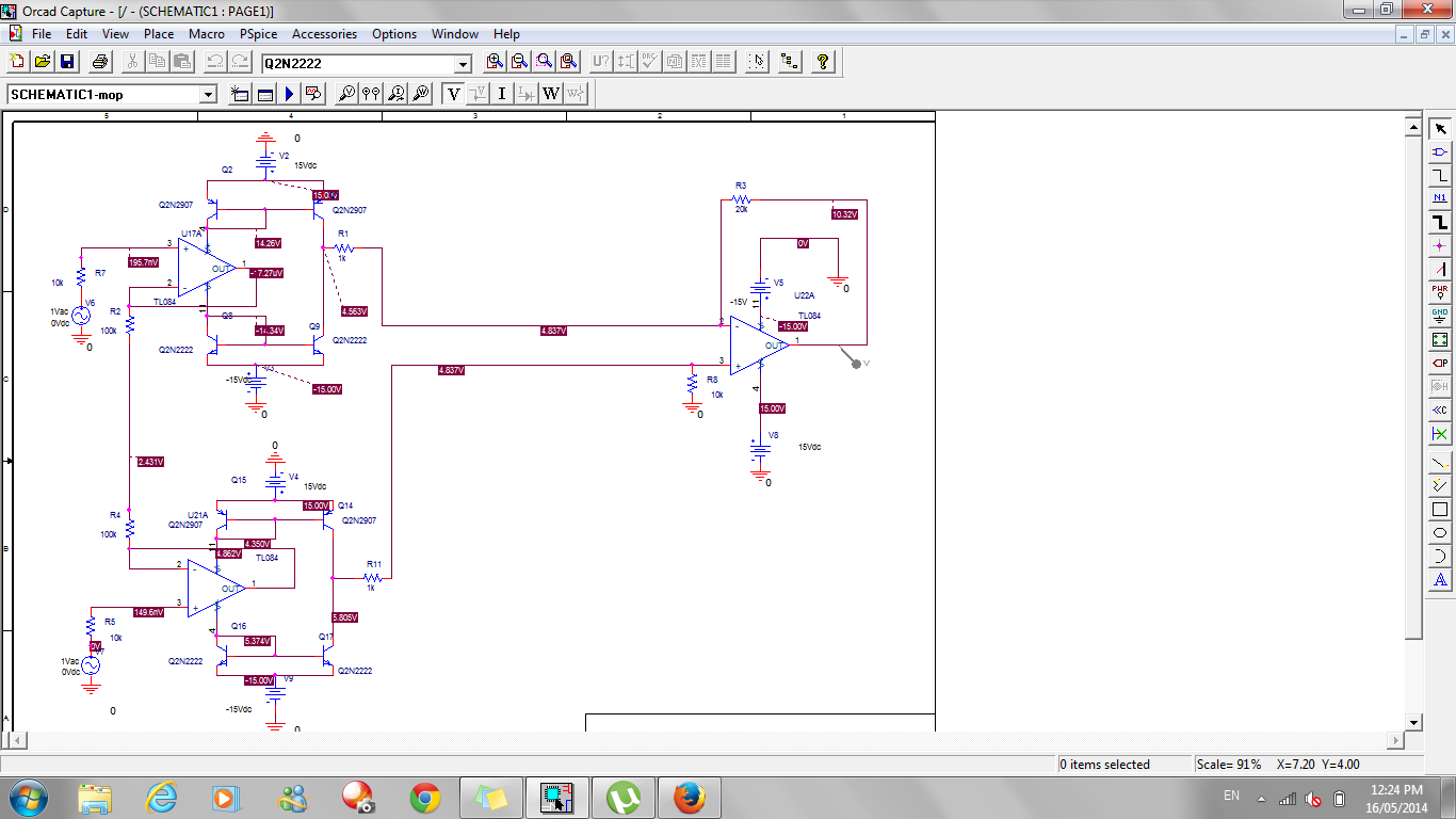

yes, You are right but what's the problem of having high voltage at the non- inverting port of the second op amp? I simulated this circuit in pspice and I got zero volt when both of inputs were (1 Vac)! but I think one thing is wrong in lower current mirrors because base of top transistor has (4.35 Vdc) while the power supply of transistor is 15V!!! sometimes I really go crazy due to the strange result!

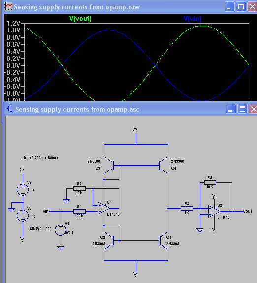

The idea of sensing both +/- V currents, reminds me a design of an analog multiplier with two op amps using the "quarter square" concept.
Anyway, IIRC, the main difference is that the second op amp was a differential one to sense difference between currents.

This is what I got by simulating the circuit with 4 transistors. Am I off track?
Atferrari what are you trying to say there?

Yes you are! I'm talking about simulation of whole circuit not half of it.
Thanks for the exclamation point.
What half of the circuit is not included in the simulation? Vin and Vout are shown as an outcome of the simulation.

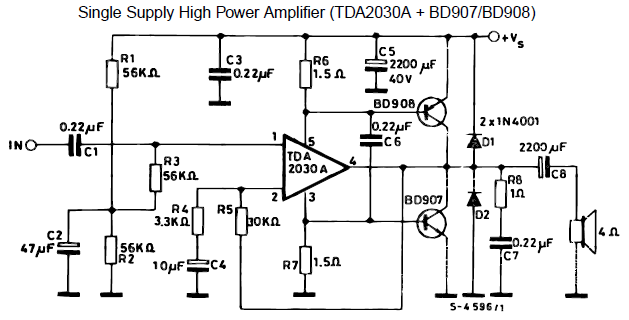

Since your 4 transistors are not included in the negative feedback loop of the first opamp then when the level is higher the distortion might be awful.
Here is an audio power amplifier that has the transistors connected properly:

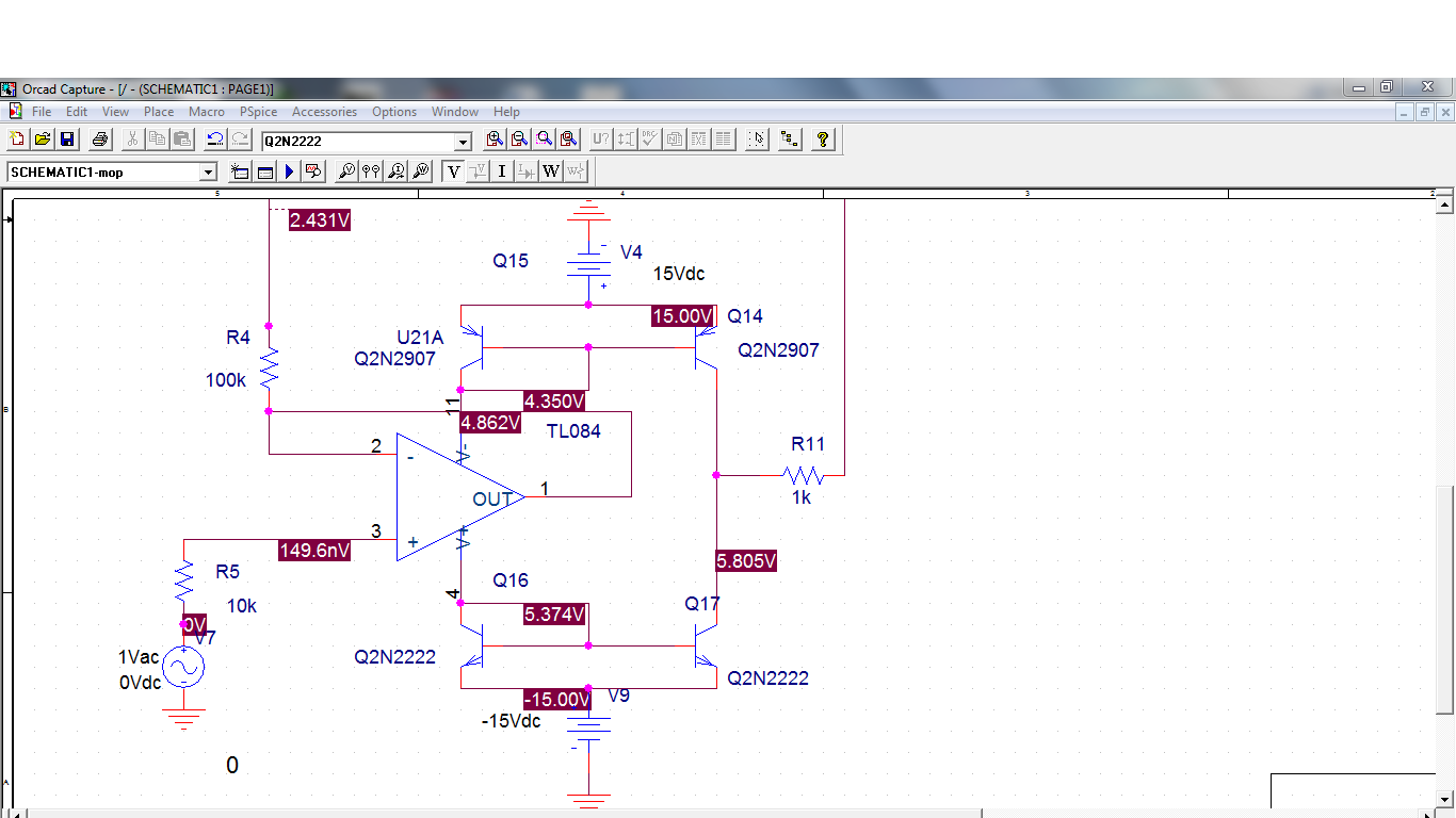

I attached the image of the lower current mirror. As you see the base' s voltage of top transistor is 4.35 v and the lower transistors have 5.37 v at their base. My main question is why these transistors have low voltages at their base while 15 v has been applied to them. Actually I don't know why base's voltage of top transistors aren't for example 14.3 or sth like that because (Vbe) is usually between 0.7 and 0.6. The whole circuit has been attached, too.

The base-emitter voltage of an ordinary transistor is about 0.7V.
Since your simulation program shows 10V or 20V then IT IS COMPLETELY WRONG!
But YOU are also wrong since the schematic with a single opamp shows TWO 15V batteries and THE WRONG battery is labelled -15V. The schematic with 3 opamps has the battery polarities labelled correctly.
Pin 4 of a quad opamp is supposed to have a positive supply and pin 11 is supposed to have a negative supply. Look at the datasheet to see it.

It would be interesting to see the current in that simulation, I bet the current is in the order of tens of amps, mainly because the opamp has the power supply swapped around.
untitled1 shows -15V at the emitter and +5V at the base, that is 20V difference insted of normal 0.7-1V
That's my main problem, and I don't know why?!
We told you that your batteries are connected BACKWARDS!
I repeat: "Pin 4 of a quad opamp is supposed to have a positive supply and pin 11 is supposed to have a negative supply. Look at the datasheet to see it."

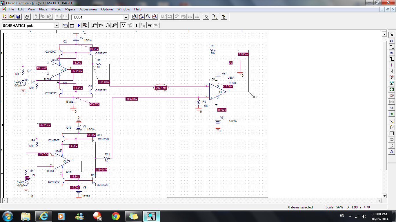

I hope this time the schematic is right. when I try to see DC voltages in pspice. At inverting input of right op amp I have -796.1 mv which is drawn in red circle. I don't know why voltage has been increased after R1. before R1 is -846mv and after that is -796.1 mv.

Why do you have R5 and R7? They do nothing so replace them with pieces of wire.
The top opamp with current mirror has a 1k ohms load (R1) but the bottom opamp with current mirror has an 11k ohms load so they will have different amounts of attenuation because the current mirrors produce a high impedance signal source.
