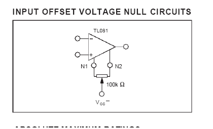

Using an op amp with an offset null input allows you to adjust the output offset voltage. It changes the offset by balancing one of the internal stages in the op amp.
A op amp without a null adjustment means you have to input a small current into say the inverting terminal with a pot and resistor. The current is adjusted and that adjusts the output voltage toward zero. The values depend on the op amp gain in the circuit. For example, if you have a feedback resistor of 100k with non inverting terminal to ground and the output is offset by +0.1 volts, then using another 100k resistor on the inverting terminal to the center arm of a pot where the other two terminals of the pot are connected to plus and minus 10 volts, the center of the pot would be adjusted to 0.1 volts too because with the gain of 1 (matching 100k resistors) that 0.1 volts will subtract from the output offset 0.1 volts so you should end up with zero volts on the output.
If the non inverting terminal is not at ground it's a little more complicated, or if the input requires a negative voltage and the system has no negative supply voltage then it gets a little more complicated too.
There are many op amps made these days that have an automatic adjustment that keeps the offset very very low. These work very well for DC signals. If you do need offset adjustment it is probably better to go with an op amp that has that feature. They have two extra pins for that.

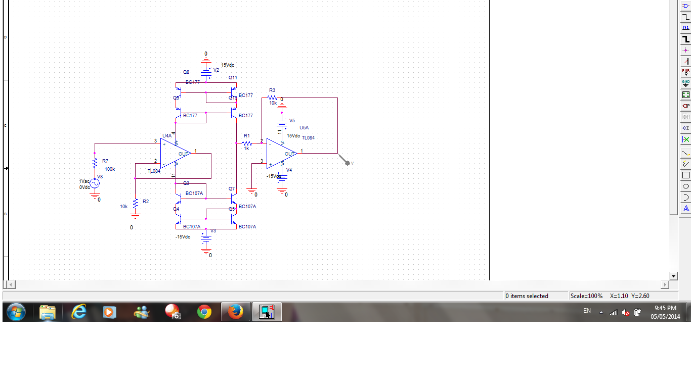

Thanks for ur help :), I uploaded a file shows the circuit that is being assembled on breadboard, I use op amp -tlo81- but I can't adjust offset output voltage to zero volt when
I assemble the whole circuit. I don't know how I solve this problem!? :-((

Try fixing the polarity of the supply voltages first. It looks like both batteries supply a positive voltage when one should supply a negative voltage. Let us know if this helps or not.

Are you aware of this in the datasheet?
OK, sagh. I did not see post No. 7 by MrAl. Yes you should solve that part first.
What do you intend to do with that circuit?
It doesn't help :-(
Ok, then why does your schematic show BOTH batteries powering the op amps with the positive terminals rather than one with positive and one with negative? If that is a sim it will not work that way.
Oh, is that because you specified them as minus voltages (the bottom ones) ? That's ok then.
So then which op amp are you trying to adjust, the first one or second one ?
I set the second one ( the op amp on the right) that's adjusted very well. In the next step when I assemble the whole circuit, I still have offset output voltage which isn't adjusted at all! :-(( I don't know what should I do to adjust it to zero!?
I think I don't know sth important about Op amp, because My problem isn't solved at all. :-( Please help me.
Thanks in advance
Hi again,
Did you try adjusting the first stage first? That would be a good idea.
You may find that there is not enough adjustment range on the offset adjustment.
Also, why is R2 so high in value, is that the right value? That seems to limit gain of the first stage with R1 being 1k.
What is the desired overall gain of the circuit supposed to be?
BTW, what is the advantage supposed to be for using those eight transistors with this circuit?
I modifed the circuit a little bit and I used 4 transistors instead of 8. why is the value of R2 limiting the gain of the first stage?
I think changing the value of R2 doesn't make a big difference on gain of the first stage. But I 'm not totally sure would u please tell me I'm thinking right?
