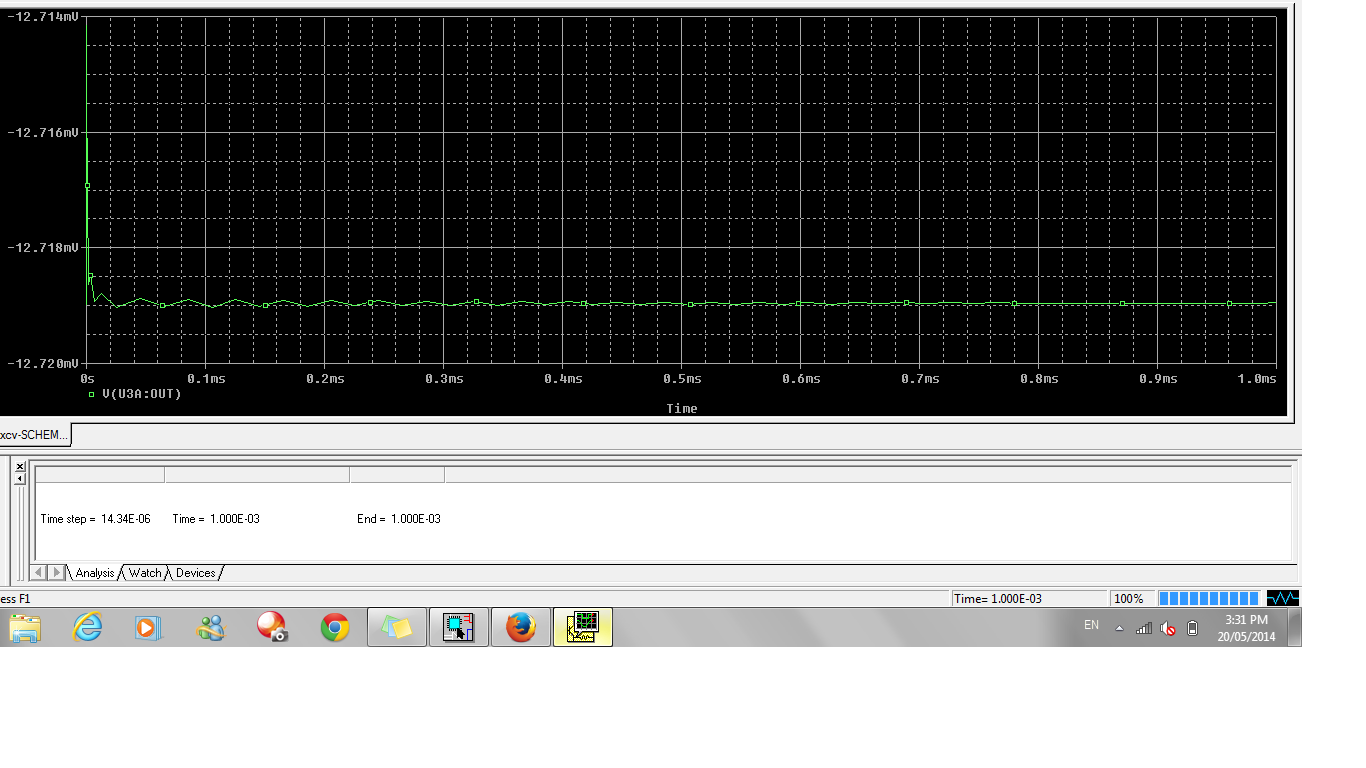

Test this again, using 1vdc on the top and 0vdc on the bottom. You should get -1v (ro nearly that) at the output.
Voltage of output is -0.013.
With 1vdc on the bottom and ovdc on the top. you should get +1v (or nearly so) at the output.
Voltage of output is 0.013.
2v on the top and 4v on the bottom should produce nearly +2v output, etc.
Voltage of output is 0.025.
Something is really wrong in this circuit. :-(

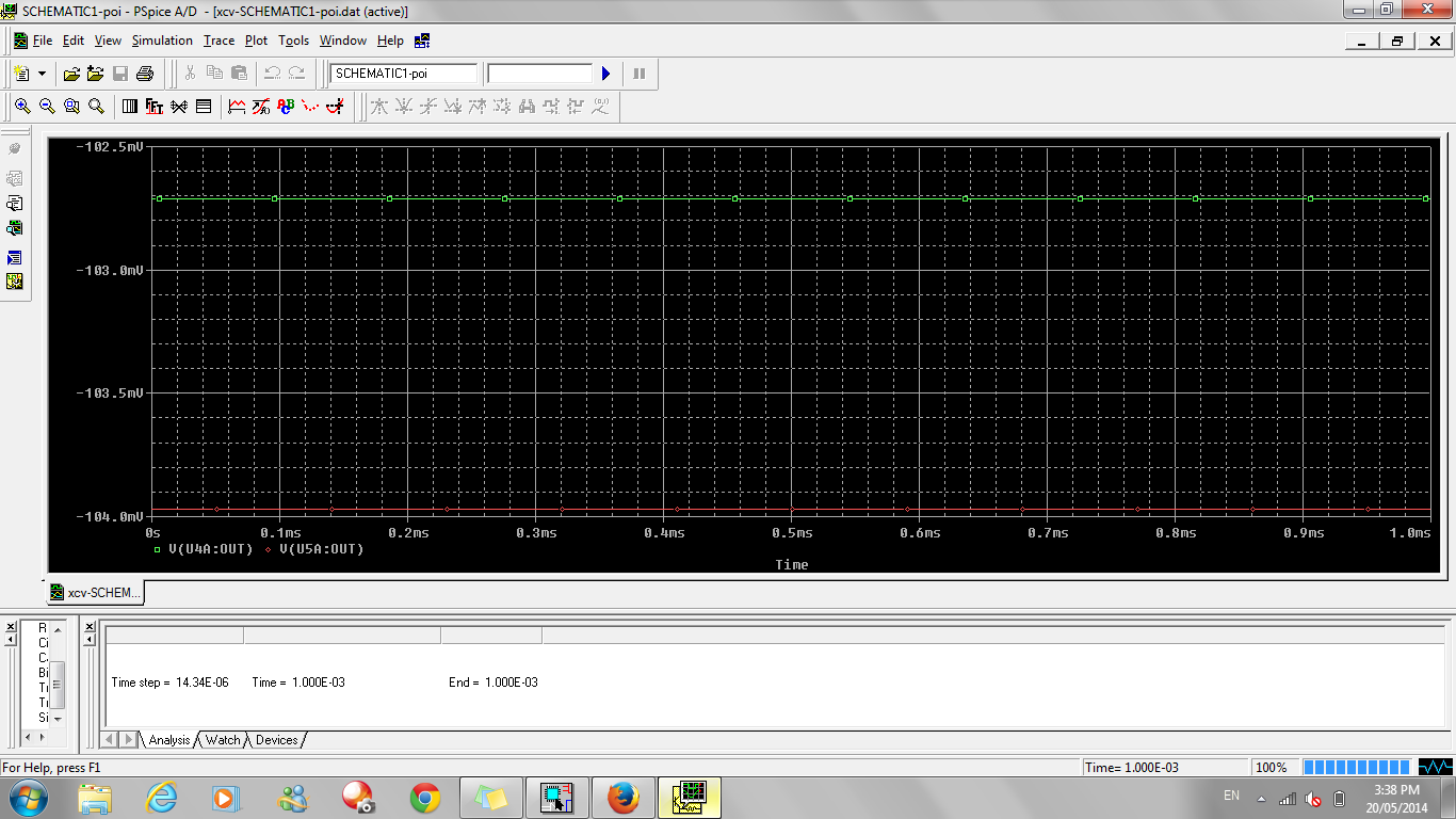

I'm so sorry. I did this test one more time. For +1Vdc, I got ( - 0.103v ) at the output of both current mirrors. For -1Vdc, I got (- 0.105v) at the both of outputs. SO Current mirrors don't work ok. In previous post I didn't see the minus when inputs were +1Vdc. Sorry about that, again :-(
For output of both buffers I got the same values.

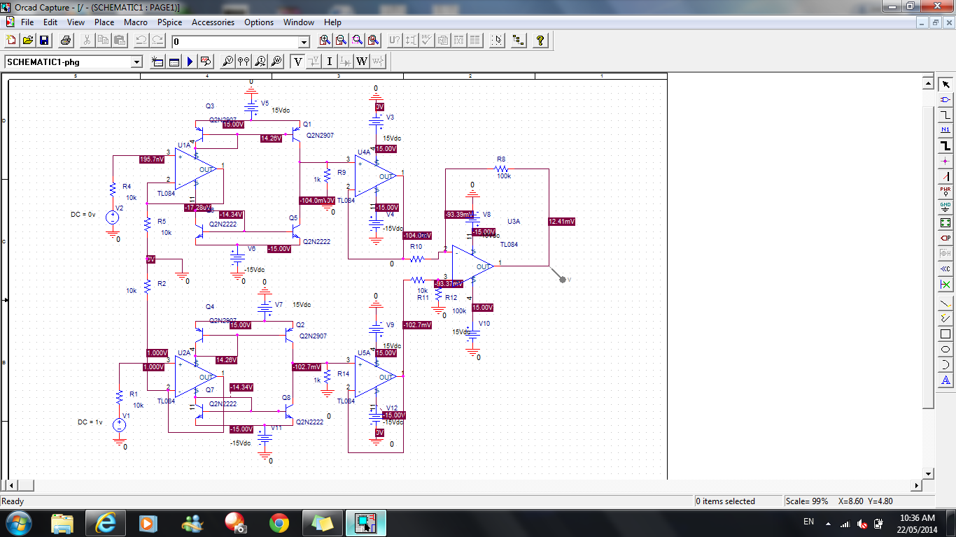

For FINAL output, by applying 1Vdc to lower section and 0V to upper the very last output is 0.0124v. 1Vdc to upper section and 0V to Lower final output is -0.0127v. Voltage of UPPER buffer is -0.103V and the lower buffer is - 0.104V.
Actually When the junction of 10k resistors isn't grounded I still got these values at the FINAL output.
Anyway I attached voltages of all parts of circuit when upper input is 1vdc and lower is 0vdc.
We have to correct the current mirrors I have no idea why They don't work right.

Ok so we've narrowed it down to the current mirrors. But it could be the op amp models, so do you have the model statements handy?
You could try connecting a 10k resistor across the power supply pins of the upper first op amp to see if increasing the quiescent current through the current mirror helps to establish a better operating point. This may or may not help so you have to measure the output of the buffer again for that section.
The ideal operation is that for a +1v input the 10k resistor on the output of the op amp draws a current through the top current mirror of that section and that causes a positive voltage to be developed across the 1k output resistor. The gains are set up such that the output is one-tenth of the input and with the same sign, so we should get +0.1v output when it is working correctly.
I am really suspecting the model now, but i wont jump to that conclusion just yet. If you can provide the model statements we can take a look and see if the model is capable of being used in this manner. If not we might switch to a different model.

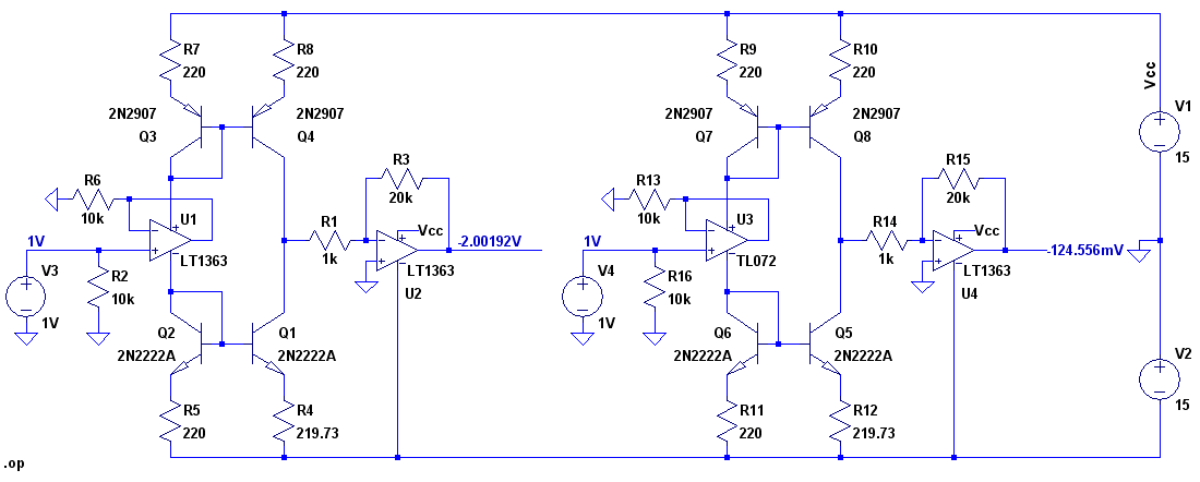

I have mentioned about this in my post 34. That most op-amp simulation models (model statements) incorrectly model the power-supply current.
And this is why this circuit will never work in simulation program. In real life the circuit might work, but I would add emitter degeneration resistors into current mirror.
Here you can see the proof.
If I use LT1363 as a op amp LTspice gives the correct result. But if I change the op amp to TL072, I don't get correct result.
