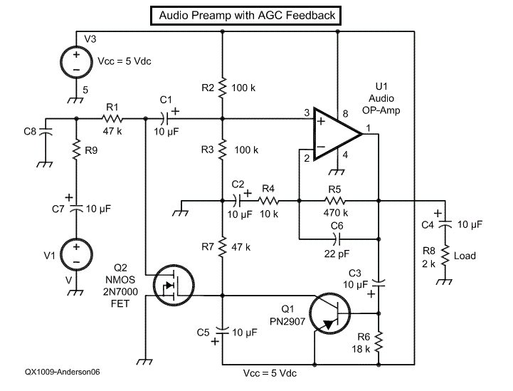

Hi all,
Once in the past with the thread, I searched many JFETs, MOSFETs alternatives to make a simple AGC (audio limitter/AGC). Later I got a nice gift (better chips) by canadaelk. Later I got whole professional set of limitter/compressor too. I am VERY VERY much thankful to 'canadaelk'!
Though, I am still interested to simpler AGC to experiment. Along with the thread we searched/tried to fix a limitter with easy 'available' JFET or MOSFET like 2N7000 but it was incomplete. Today I read the tiny e-book and it's using 2N7000. It looks pretty simple and looks nice!
What about it for 'general' purpose like to play songs through toy FM Tx or recording voices?

From what I built; I like the MOSFET versions better than JFET. Mostly because the MOSFET is linear at a higher signal level.
My opinion; Any limiting is better than not limiting. (ahead of a transmitter)
Too much limiting caused a loud distorted noise from Canada. (AudioGuru) LOL
Maybe poor one is better (at least for experiment) than nothing. Here I attached a LTSpice simulation drawing for expert to test the circuit in precise way. Put command and C8 and R9 as your wish, inject input signal and do not forget to change 2N7002 into 2N7000. I didn't get 2N7000 model in LTSpice so just used 2N7002:
