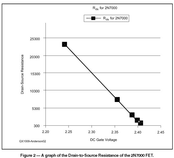

I spiced around with the circuit in spice. The MOSFET I used year ago, made a good voltage to resistance converter. The 2n7002 has a sharp knee. It goes form little attenuation to great attenuation in a small number of mV. I did not get it to work well.

One thing I hate about the circuit is that the "AGC voltage" (more or less gate voltage) starts out a 0 volts and must get up to 1.25 volts before any limiting can be seen. Then from 1.25 to 1.4 is the entire range. Before I added a pot that set the "DC" voltage on the gate with no audio. So I would set the voltage at 1.25 to start out. That way the "attack delay time" was faster. Then to get the distortion out of the picture, no audio frequency noise should be on the 10uF cap. (bottom line the gate voltage should stay in the just turned on linear region)

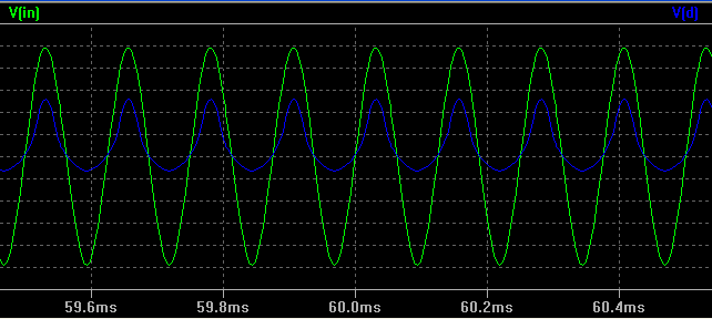

Using the 2N7000 MOSFET in spice I have distortion. I used a linearizing circuit and it gets better but I just can't make it good. It could just be SPICE. When I built these things in real life I used MOSFETs with very high gate turn on voltages.

Here is the MOSFET-drain and Vin, with 1.605 volts on the gate. (compressor shut down and a "battery" on the gate) Vin is 20mV pk. It only takes mVs to make huge changes in gain. I think this is the wrong FET! I know how to remove much of the distortion but.....
