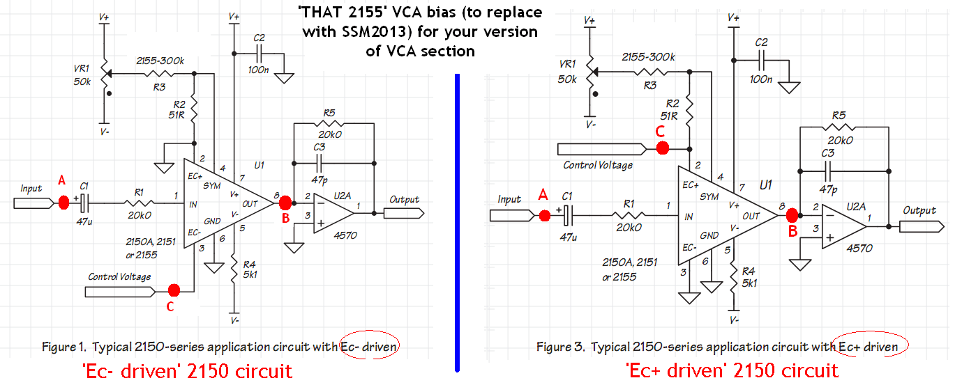

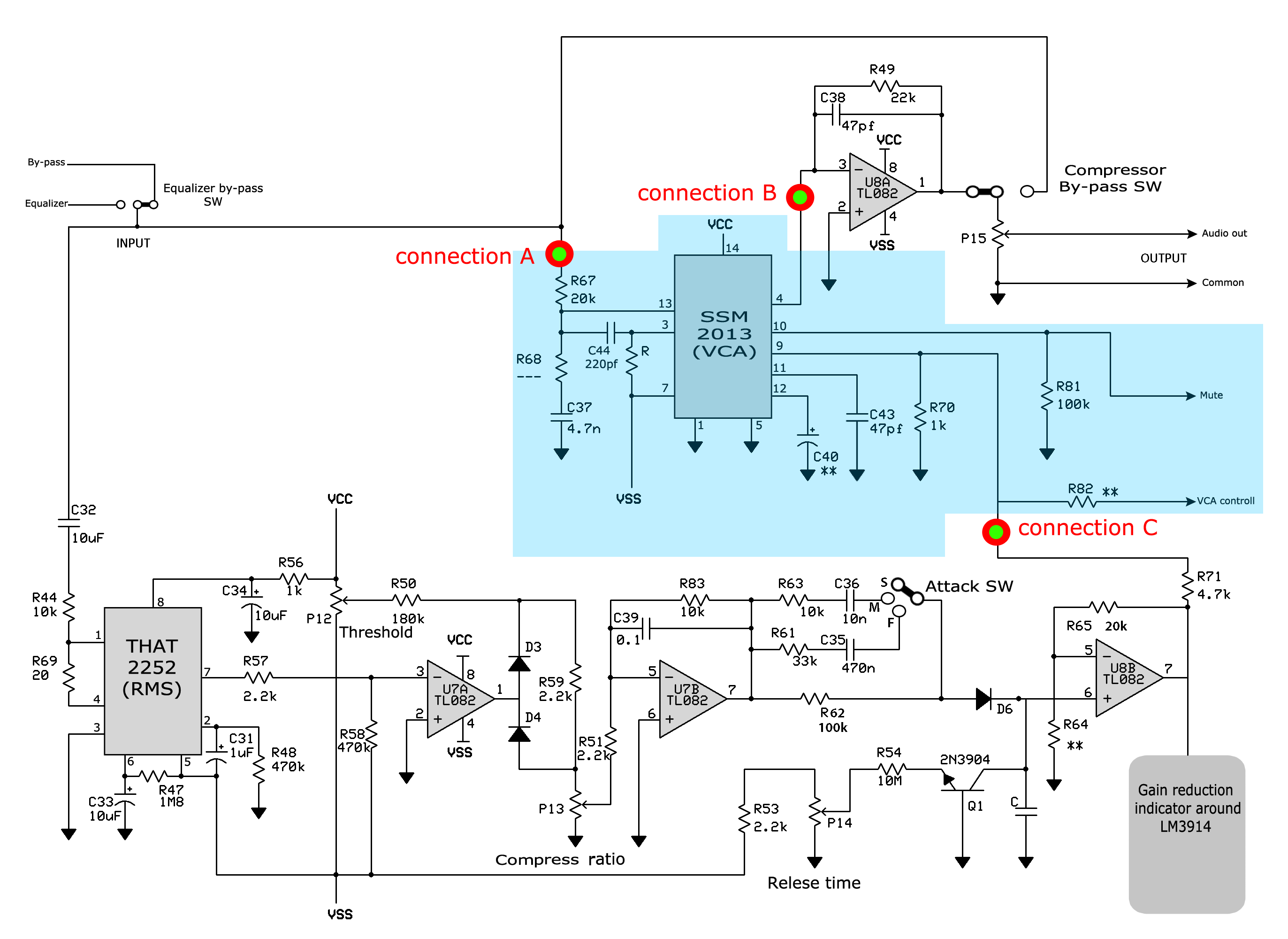

Hi after so... long time,
A member of ETO and Canadian engineer/designer 'canadaelk' sent so me parts related to a compressor circuit (attached below) and he sent some different part than a real schematic, suggesting me to change the main IC. due to my poor mind on electronics, I could not decide what to do for better result. Even some basic bias factor made me lot more confusing! So i tried to contact to him in inbox, but I feel he use the ETO very less and reply very less. According to him I need to replace the IC SSM2013 VCA with THAT2155 because he sent me THAT2155 IC instead of SSM2013 and said to replace. Circuit has designed with SSM2013 IC- see Compressor GIF copy.gif.
To do that myself I downloaded some related 'design notes' from THAT corporation. They are showing some VCA based on THAT2155 but different bias schematics like 'Ec+ driven' and 'Ec- driven' made me confused me LOT! I am worrying so want to get a better suggestion to submit my this one hobby project.
In the compressor schematics below, named as 'Compressor GIF copy.gif' I marked three connections A, B and C. And in the THAT2155 based VCA (I found at THAT's design note), named as THAT2155 VCA bias with ec+ and ec- dr.gif there are two circuit with ec+ and ec- driven. and there also I marked A, B and C connections. Can I delete SSM2013 stage and connect these A,B,C connection marked at VCA schematic? Which one I need to choose among Ec+ and Ec- driven?
(THAT design note137.pdf of THAT has nice guide to replace the IC THAT2155 with another one and has some schematics too. Due to its completed thing, it is not being helpful to me. :) Sorry for waking up again!

Hi Willen,
I HATE the sound produced from a single compressor. It senses all frequencies then compresses all frequencies. Then a loud bass beast causes compression of the background music and vocals that sounds awful because then their levels are pumping up and down. My local TV station uses too much compression for the news announcers then before they begin speaking the gain is maximum causing their first breath of air to BLAST at full volume before the compressor turns down the gain for the voice. Any loud sound kills the voices for a moment when the compressor turns down the gain before the compressor returns the gain to normal.
A half-decent compressor circuit has a more than one compressor (one for each frequency band) then a loud sound on one band is compressed without compressing the other bands. Dolby noise reduction and DBX did that many years ago.

Hi Audioguru,
Your sentences are so much interesting! And little funny to hear about TV announcers' blasting voices with compressor and VCA :) . For me, I want to insert music and want to compress music and want to transmit and want to see its amazing changes! I will accept even if I listened awful. I feel so fun to do any project and the project is amazing for me because the related parts are rare for me. Really thanks to 'canadaelk'. I am excited to listen modified sound or anything else. As I said before, I am from remote place so I won"t get such ICs and parts anymore here. So feel to anything if I got parts. :) It's fun to me.
Hi Elk,
I don't know what happened with your PM reply. You can check your inbox in this ETO. Yes I got your mail and few pages guides too with schematic and related THAT parts. You explained their so nicely but you didn't wrote in detail about to replace SSM2013 with THTA2155. So I searched THAT2155 schematic myself around THAT design niotes and showed here. Can you read my actual problem carefully at post #71 and reply me, here or on PM? There is very old message there in your inbox, for same problem. Thank you so much for returning back. Feeling that I found a lost person :)
