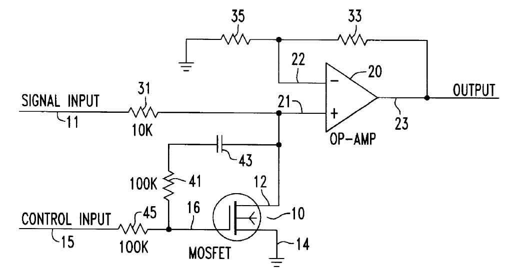

MOSFET are used differently as a VCA.
See US patent 5808516 A
I have used this method to get better distortion with a MOSFET used as a voltage controlled amplifier. Resistor 41 & 45 along with C43 solves some problems. If you don't want to use the JFET then use this method to linearize the signal.
