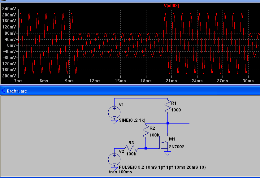

Here is the MOSFET circuit I used. In this example the sine wave is 1khz. The control changes every 10mS.

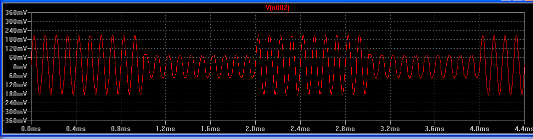

Here I speed up the sine to 10khz and the control up to 1mS.
The Mosfet appears to attenuate and release very quickly. How is its distortion?

Thanks for the circuits. They look very interesting. The only thing that worries me a little is that the drain of the MOSFET appears to be biased at 0v DC, which means sometimes it goes negative. Is that device (or similar) going to be that symmetrical in it's response? I have not tried this yet but i would think offhand that it needs to be biased to some reasonable DC level like 1/2 Vcc, which would make the drain always positive even though it would still vary up and down with the AC input signal.

Touching the gate of a Mosfet can easily ZAP it. How many thousands of volts are there at the end of your finger?
If the drain of the Mosfet has a DC voltage then the gate control voltage will cause it to make a loud POP sound if it is turned on quickly.

MOSFETs can and do run in reverse. It is OK to have a small amount of reverse voltage.
Note: It is important to keep the output audio below the nee voltage of the MOSFET internal diode. I think the peak output voltage needs to be in the range of 200mV to 400mV. The input voltage can be very high. Because this is a 'limiter' the whole idea is to have a wide range of input voltages and a limited output range.
The 1000 drain resistor can be much lower like 200 or 100 ohms. It depends on the GS-voltage to DS-resistance curve and where you want to run.
