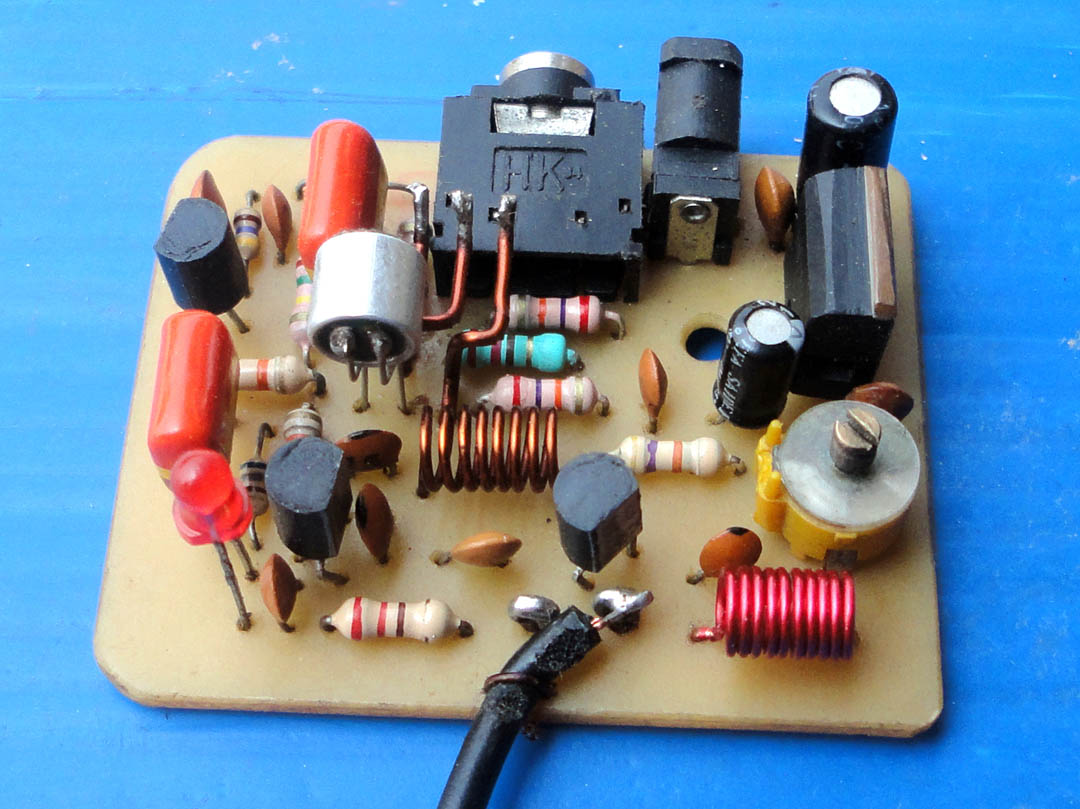

Almost a year ago I made this (attached) basic FM Tx designed by audioguru. I made few other Tx too as an experiment but this one has VERY crystal clear sound like a professional radio. But sound was little small than professional radio. I didn't know about such limiter/compressor so I experimented lot more with audio amplifier stage of the Tx, simulated with different bias, applied differents voltages, used differents transistors, even I used a 1000 hFE transistor MPSA18; But got nothing more than distortion. Later audioguru said about compressing audio to trasnmit loud audio. Very later I found few circuits on internet, made me excited to do! Excited to see its comprecessed and bypassed audio spectrum on computer screen by making it myself, wow! It would be cool thing to me. In past I asked 100ths of questions to audioguru and learnt lot more, sometime he was irritated too by my childish questions hehehe.

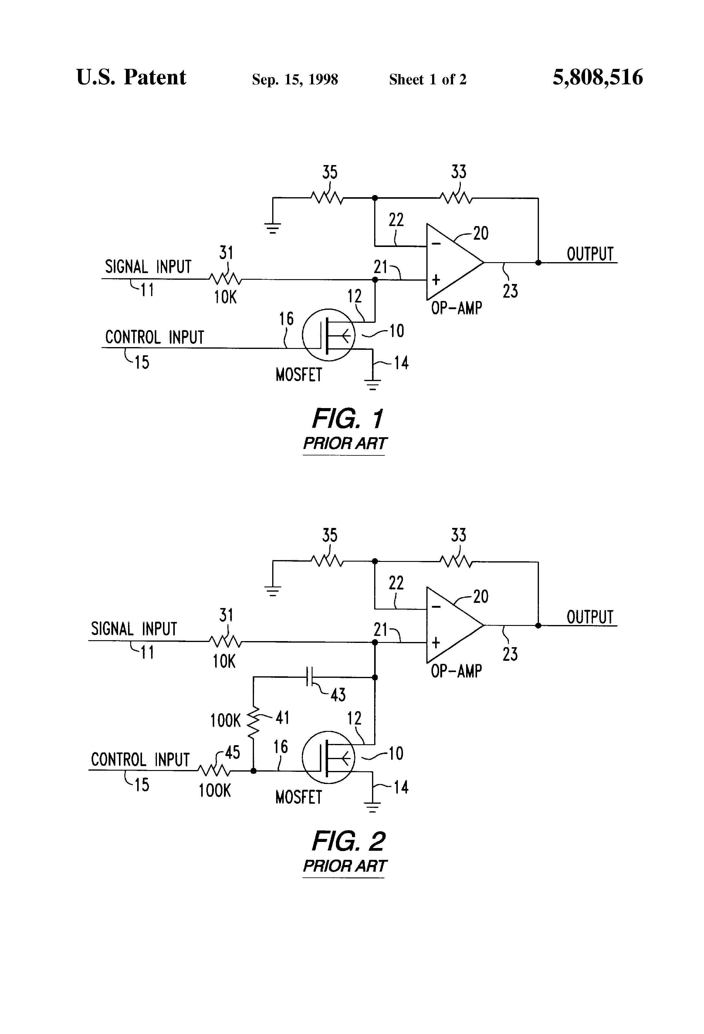

So with that in mind, did anyone here ever try using a low power MOSFET for the limiting device rather than a JFET? Of course the biasing would be different but that is to be expected. The main thing is if you did then did you find any major pitfalls before i begin working on this? He has a couple already so if we can do a limiter with a MOSFET he wont need any parts right away.
MOSFETs work well.
I think I brought up "US 5808516 A" back many posts.
Oh ok great. Then do you have a reference circuit we can take a look at?
I think there are examples in old national notes, and there are several in old HAM books. This one is not the best on distortion. The MOSFET need two resistors on the gate to make it more linear. I think I used 2meg resistors.
  • Anderson Sept-Oct.pdf
When the FET has the two resistors on the gate with a series capacitor then the distortion is reduced a lot but the attack time is very slow. The circuit from Rod Elliot that I posted (post #2) reduces distortion and is fast.
