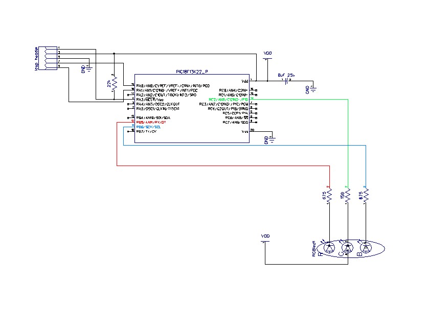

Here is my main code

schematic in next post
Here is the schematic. Hopefully you can read it.

Then that's a problem. You HAVE to set the CONFIG properly, and as been said many times you can't rely on the defaults
to match your hardware.
Try this:
Module osc1322
Config
   FOSC = IRC,    ' internal RC osc
   PLLEN = OFF,    ' PLL is under software control
   PCLKEN = OFF,      ' Primary clock drive disabled (using internal)
   FCMEN = OFF,      ' Fail-Safe Clock Monitor disabled
   IESO = OFF,      ' Oscillator Switchover mode disabled
   PWRTEN = ON,    ' PWRT enabled
   BOREN = OFF,    ' Brown-out Reset disabled in hardware and software
   BORV = 22,      ' VBOR set to 2.2 V nominal
   WDTEN = OFF,    ' WDT is controlled by SWDTEN bit of the WDTCON register
   WDTPS = 128,   ' 1:128
   MCLRE = ON,    ' RA3 input pin disabled; MCLR enabled
   HFOFST = OFF,    ' The system clock is held off until the HFINTOSC is stable.
   STVREN = ON,    'Stack full/underflow will cause Reset
   LVP = OFF,    ' Single-Supply ICSP disabled
   BBSIZ = OFF, ' 1KW boot block size
   XINST = OFF, ' Instruction set extension and Indexed Addressing mode disabled
   DEBUG = OFF
  OSCCON = %01100010  // IRCF=8MHz, SCS1=1 (int osc)
  OSCCON2 = 0
  OSCTUNE = %10000000  // INTSRC=1, PLLEN=0, TUN=0
  // set all pins digital
  ANSEL = $00
  ANSELH = $00
  CM1CON0 = 0
  CM2CON0 = 0
  VREFCON1 = $00
I don't have a 13K22 to test it on, but I think that should get the internal osc running at 8MHz no matter what and set your pins for digital IO

After making changes as per Tumbleweed the dang led blinks now. I am going to compare what Tumbleeweed posted and what I had for the module in post #86. I know I tried using CONFIG and kept getting compile errors. I want to try and find out WHY.
THANKS to everyone who assisted in this endeavor.

The code in the above post has absolutely nothing to do with the color chart I posted.
If you want to have a realistic color simulated candle, there is a relatively narrow range of RGB color combinations that result in reasonable colors. Red plus some blue plus some green. How do you get some amount of green and blue? PWM.
What the code you have posted does is randomly flash the red, green and blue LED elements. What colors can you get from doing this?
The obvious answers are red, green and blue if only one element is on. If all three are on at once, you get white depending on the color balance.
If both blue and red are on at the same time, you get purple. And if both blue and green are on, you get cyan. Call it light blue if you don't know what color cyan is. If red and green are on...wait for it...you get yellow.
So, of the 7 possible combinations, one of them gives you a desirable color. Six of the color combinations are crap. Or, in other words, all but one of the choices gives you something that doesn't look like a candle.
So, you can either figure out how to use PWM to get acceptable colors, or you can understand what the code you've posted does (wish is not what you wish it to be) and what a candle actually looks like, and replace the RGB LED with three yellow LEDs. This won't give you color variation but it will provide changing intensity and an illusion of motion.
Using yellow LEDs also allows expansion to three independant candles using separate port pins.[/B]
