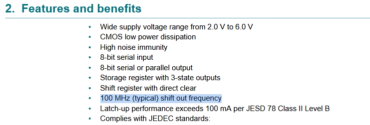

WHY 10 – 74HC595's I wanted to avoid the “curtain effect” with the LED's turning ON in sequence from the #1 LED to #80. If it hypothetically takes 2 seconds to cycle through each shift register, then 16 seconds from #1 to #80

2 seconds to cycle through each shift register where you read that at you could clock out all 90 bits faster then you could see it happen
less then 8 ms for 90 bits

As far as 2 seconds for each shift reg, that's only if you add all sorts of delays where they shouldn't be

The 595 shift register can shift out at 100MHz ... that's faster than most processors could bit bang the data and definitely faster than an interpreted code processor running from BASIC could shift it out.
The 595 is not your bottleneck. IOW... you don't really even need delays in your code between clock pulses for the 595 to function just fine.
If it is taking 2 seconds to shift data out, then something is incredibly wrong in your setup.
Reference: https://www.digikey.com/en/products/detail/nexperia-usa-inc/74HC595PW-118/946653
