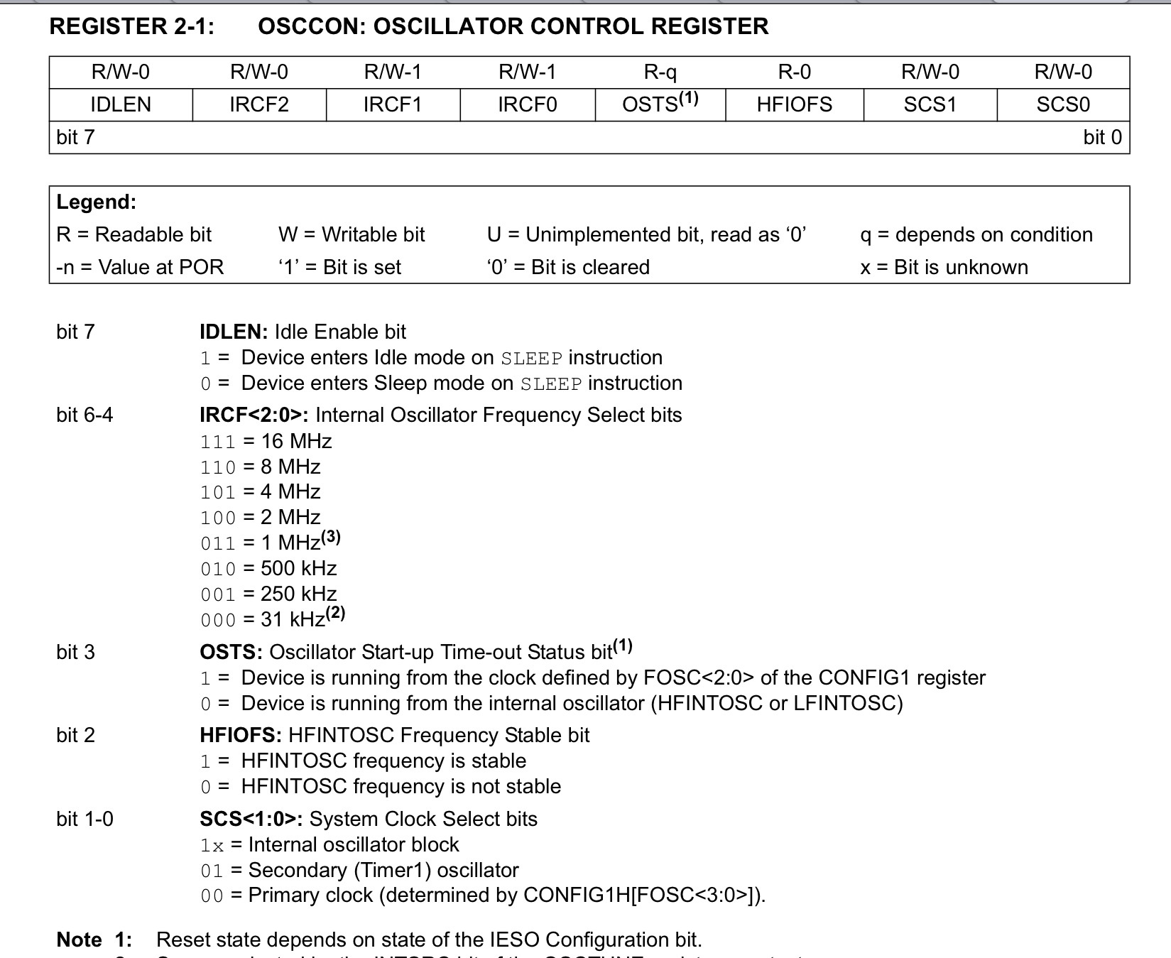

First set the OSCCN register:
OSCCON = %01100011
This sets the oscillator to 8 MHz and selects the internal oscillator.

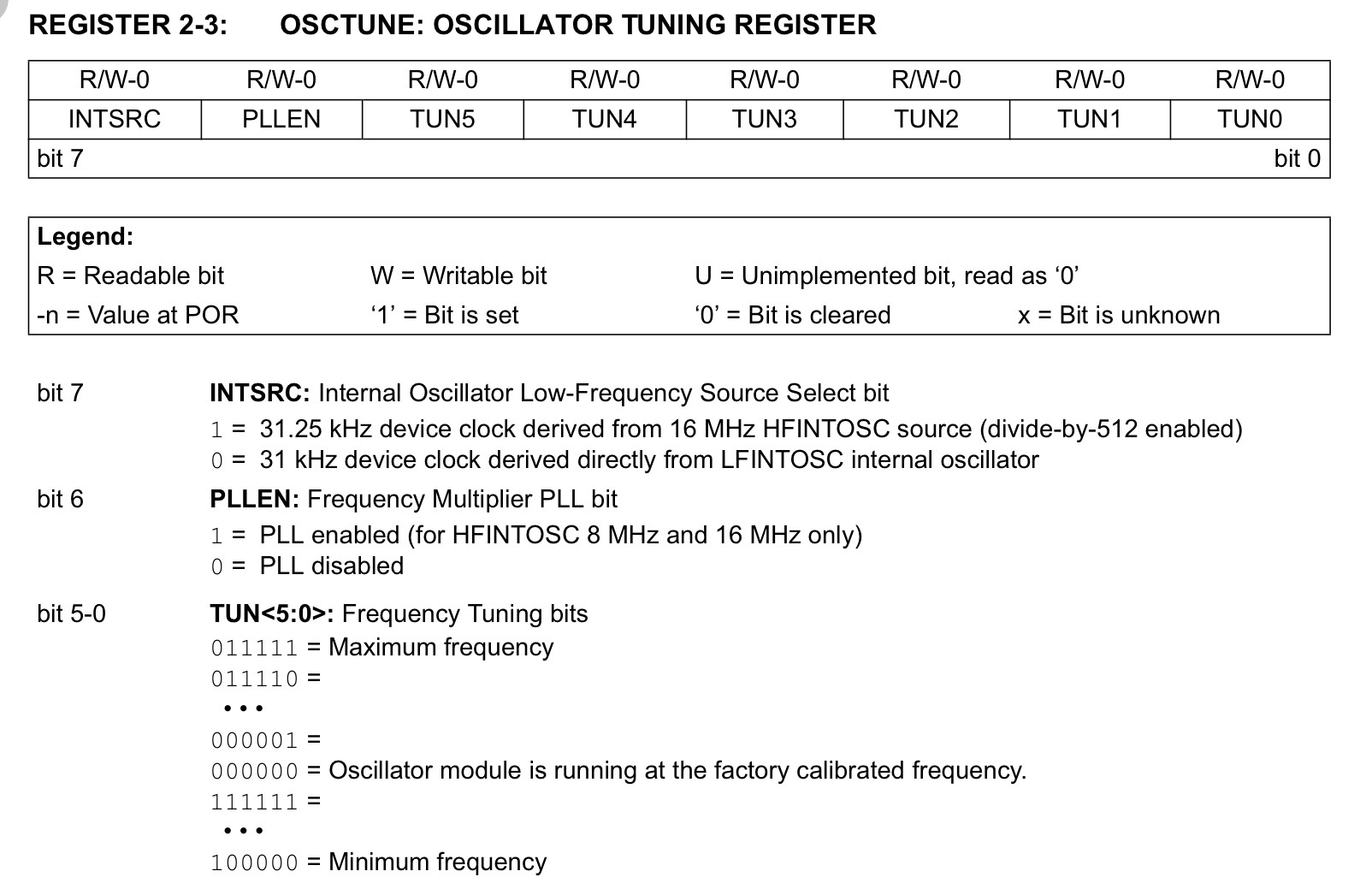

Next, the OSCTUNE register must be set:
OSCTUNE = %00000000
This turns off the PLL multiplier.
So the FIRST four lines of your code will be:
Device = 18F13K22
Clock = 8
OSCCON = %01100011
OSCTUNE = %00000000
Note: these must be typed exactly as shown including the percent sign (which indicates a binary number). There are a total of exactly eight numbers in each of these statements.
