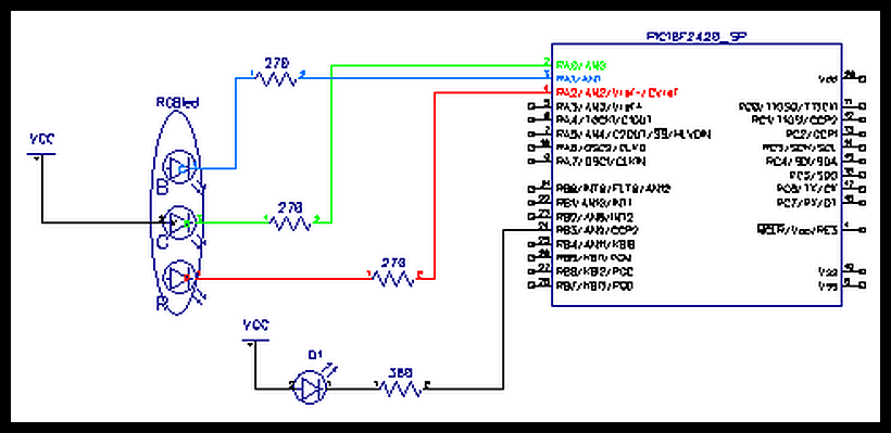

Now back to this candle. I redrew my schematic and used a different approach to metho
d of posting image. I am making some progress after I changed the post scale value. The LED does not flash like a strobe light now.
Am inserting at different locations in the posted timer code an LED routine but have yet to figure out why the led fails to come on as it should. Might be as simple as setting up the led routine correctly (discovered I was backwards to enable the LED)
here is a different image format that was suggested eons ago using print preview in DIPTRACE
This is my present test circuit
is that dip trace? ive never seen it before but it reproduces awful on my screen! unreadable and blurry,
unfortunately i use proteus because i am lucky to have access to it, have you tried eagle? it seems the top choice on here, i have tried it (free version) but that was ages ago and i just could get my head around the libs!!. maybe try LTspice? its free :D dont try and sim stuff tho because thats pretty hard to start with, but might do a schematic for you, are good old paint!! just do a box for the micro and put pin numbers on the wires (lines)
it is easier to see now tho without the bus thing!! i have only ever used the bus thing a couple of times when i did a schematic with 2 lcd's in and i used it for the lcd dataline, otherwise i think they are horrible,
i try and do my drawings in a logical way, i have no idea what the actual convention is and i doubt it matters much as long as there is some logic to it, for me that means when i do mine i try and make all VCC connections at the top and all GND at the bottom, i have all input stuff on the left and all output stuff here possible on the right, its kinda like writing a book!

I decided to take a second look at what the code is ACTUALLY doing so I connected 3 RGB leds to the outputs then each color can be seen separately. I discovered what each variable is actually doing then proceed from there. At present trying to insert a BLIP as we will call it (a burst of one color to simulate a short flicker but can't seem to get the code to actually run the simple BLIP routine. Will post code after I figure out what is wrong. Contemplating instituting the software uart and see what the variables are.

This morning I did a fresh look at my code and connected 3 RGB leds (one color for each output).
I discovered what variable changes amount of color intensity. Need more time to tweek but very close right now. I have a slightly modulating yellow LED that looks pretty good but trying to introduce a BLIP of color to produce a random flicker for say 1 second.

I think it is ok maybe cut down on the blue some more for a better amber color?
Tweeked the second program code using CONST array. Tried inserting a random number generator but it didn't seem to operate correctly. Had none of the bits for porta.1 enabled but it still came on?

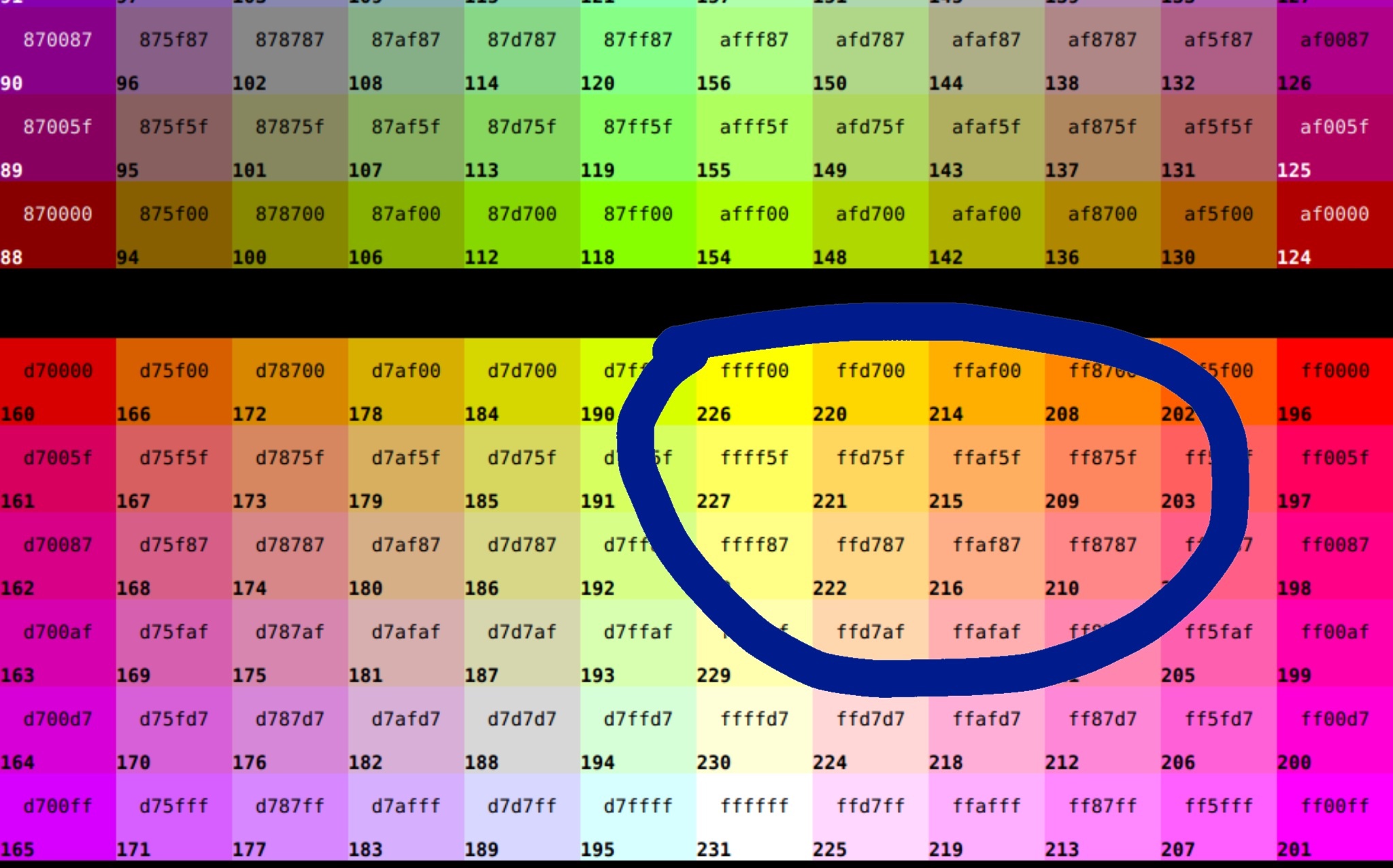

Your results do look exactly like a candle! Wow. A candle burning in an atmosphere containing random pockets of methane gas. Depending on the crowd at your event, this may be exactly the effect you are looking for.
If not, maybe it's time to take a look at the RGB color chart I linked above. The area circled in blue might be the limited range of colors found in a candle.
So what does the text in each box mean? It's the RGB color in hex. For example, the block in the middle of the orange section is ffd75f. So $FF is the hex value of the red on an 8-bit scale – $FF = 255 in base 10 = 100% on. $D7 is the hex value of the green = 215. The green is on about 84%. $5F is the hex value of the blue – you can figure out what percentage this is.
If you limit "random" values to acceptable color values from this chart, you might achieve the look of a candle on earth.

I think you don't understand the color chart or how to get ANY color from an RGB LED.
In order to make red for example, you illuminate the red element at 100%, and the green and blue at 0%. To make an orange color as I outlined above, the red LED is on at 100%, the green at 84% and the blue at 37%. This comes from the chart as I've explained above.
So how do you get various percentages of "on"? This is where PWM comes in. Adjust the current limiting resistors so that all three elements draw the same current, calculating this from the forward voltage at the desired current for each element. They WILL NOT all be the same. Then vary the PWM duty cycle of each element to the percentages shown on the table. Depending on how well the LED sections are matched, you'll be close to the expected color.
Oh snap. RGB means three elements to control and only two PWM modules are available. Now what? Look at the table above. All of the reasonable candle colors start with FF - the red element is on full across most of the possible range. The variations come from changing the amount of green and blue added to the mix. So connect the red element to a standard port pin, and the green and blue to PWM outputs. Now you can vary the color across the range.
