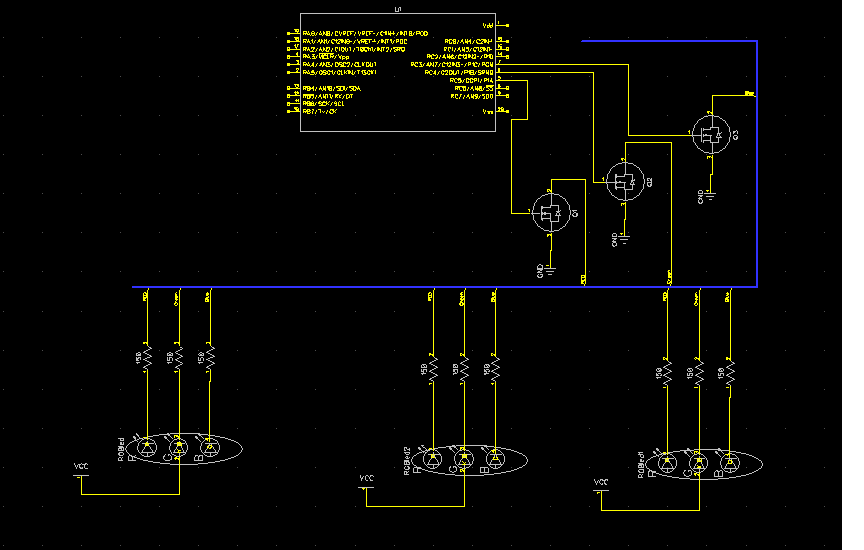

you sure its 4 modules and not 4 outputs?
ok only had a speed read at the datasheet but i am 99.99% sure it isnt going to do what you have planned, the pwm outputs are not individual! they are tied to one enhanced pwm module and are meant for full H bridge/half H bridge configurations, what it wont do is output different duty cycles at the same time, for that you would need 4 modules, off the top of my head the closest small 18f chip that would do what you want is 18f1330 that has three wich is enough for RGB. Having broken the bad news i can however offer you hope :D the chip you have has 4 timers so software pwm is the way to go with this chip.
edit
one small point when i click on your drawing i cant read it properly it dosnt show up very well. also a small point but i found it a bit confusing with the bus line drawn like that, it makes it look like they are all tied to the same points so they will all be doing the same thing at the same time! candles arnt like that, i would have thought you want them out of sync for best effect, anyway its a small thing but i found your drawing hard to read its all blury
edit 2
ive got it now! you have drawn each led as three individual leds! and i take it they are common Anode type?

sorry but you have confused me! from your drawing it looks like you are using mosfet with a presume pwm to each CATHODE and it looks like the common ANODE is just tied straight to VCC, i dont do basic so cant comment on the code, but i got the impression from what you had said that each mosfet would be run from a different pwm channel??
And that was the reason you got the chip you did because you thought it had 4 individual pwm outputs? (is that correct?). if so then you have a misunderstood the pwm on that chip, it dosnt have 4 individual pwm chanels, it has a single enhanced pwm module with 4 outputs! its for driving a H bridge half or full, or to put it another way it wont give you different duty cycles on each led pin at the same time, wich i assume you want for a RGB led???
OR
you dont actually need that and your only lighting one channel at a time (say red then green then blue)?? if your just trying to get very low frequency on/off for a flicker then you dont need pwm at all just stick a loop in the code that every n times round turns led on then slightly shorter time turn led off.
can you describe exactly what you want the chip to do? hopefully in a way that me as a novice can grasp. many thanks
LG
edit
see what is in my head is you have a RGB led according to your drawing its common ANODE, and you want it to look like a candle?
so your looking to pwm the channels to make different yellows and oranges and that kinda colour (like a candle) also while you have that going on you want the led to flicker?
if thats so then at present your drawing isnt correct
you would need a pwm on each colour channel, this will give you the different yellows etc
then on the common ANODE you need a low frequency flicker effect??
i am correct so far?
if you dont want to use software pwm for the colours of the candle then you need a chip like the 18f1330 to take care of the pwm on each colour channel for you and just have a loop in the program tied to the ANODE that randomly turns it on and off for say 750ms every few seconds (of course you very the lengh and time for a flicker)

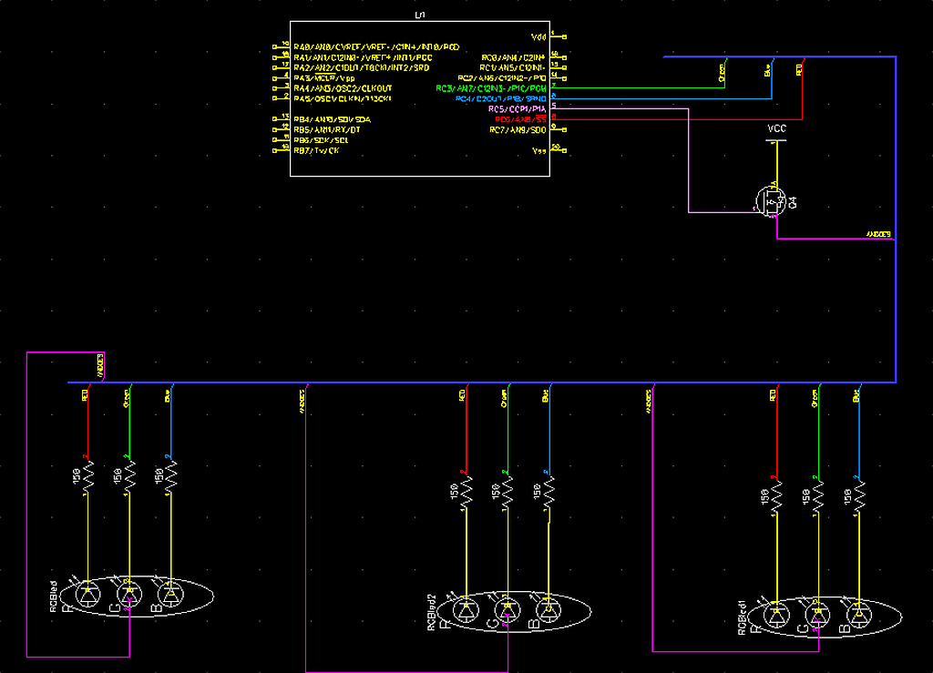

Here is hopefully a better schematic.
no the drawing is rubbish still BRB
edit
ok first off drop the bus thing it just gets confusing and on a drawing that should be as simple as that it isnt needed.
next point
you havnt answered what i asked?? are you trying to make the colours of a candle (yellows,oranges etc?) or are you trying to just get blue,red,green to flash?
if your trying to make colours then you need to pwm each colour channel of the led (forget flickering for a min) that is how a RGB led works, you adjust the duty cycle of each colour channel to make another colour, this is normally done at rates of more than 100Hz so it dosnt flicker (not your kind of flickering the other kind).
next point YOUR CHIP DOES NOT have 4 separate pwm channels they are tied together for motor control, i dont want to go into it but the datasheet has the info, simply trust me on this that chip will not be able to pwm each colour channel with the pwm module.
next point for flickering you DO NOT WANT pwm for the flickering, its too fast, you want random on and off.
SOLUTION
software pwm for each colour channel using 2 timers for best effect but you could use one timer, then just have each ANODE connected to a pin that every n number of times the programs loops it will random flash for the flickering. also on your drawing you are using (or it looks like it but hard to read on my screen) the LV PGM pin so make sure that is configured correctly.
Little Ghostman is spot-on in everything he's saying.
1. If you randomly vary the levels for the red, green and blue LEDs, you'll make every color in the rainbow. It won't look like a candle at all. The colors of a candle wil be a narrow range of yellow-orange colors. Look at the RGB color chart here.
2. PWM isn't what you need to create the flicker look, and it's not what your old code did. Your old code used timers to create the illusion of flickering. What you can do with PWM is to control the color of the RGB LED. Regardless of whether a chip can support 4 independent channels of PWM, Swordfish Basic only supports two. You might fix one of the colors by selection of the appropriate current limiting resistor, and the use PWM on the other two colors to vary the resulting color over the narrow range needed to look like a candle flame. Independently, you could use the timer routines of your old code to create flicker. It won't look very realistic to have all three candles you hope to drive off one micro vary color at the same time.
3. There's pages of forum posts here where people helped you post clear schematics. Find it and follow it again.[/B]

A PWM pin on a PIC18F-series micro is like any other port pin. It can source or sink 25 mA. You just need to understand (oops, there's that word again) the 100% on when sinking current = 100% off when sourcing current.
By the way, your last schematic shows 3 LEDs in parallel...keep the 25 mA limit in mind.
ok hold it there! you did NOT find an issue! actualy i pointed out that you had drawn common ANODE in my first or second post! and it makes no difference if you pwm ANODE or CATHODE , you need to stop what your doing take a deep breath and lets start again! i will be back but i need a little time <1hour because i clearly need to post a big post to sort this random going around in circles out!

*  Name    : UNTITLED.BAS                                                  *
*  Author  : Doug Bezaire                                                  *
*  Notice  : Copyright (c) 2010 [select VIEW...EDITOR OPTIONS]              *
*          : All Rights Reserved                                            *
*  Date    : 3/26/2010                                                      *
*  Version : 1.0                                                            *
*  Notes  :                                                                *
Device = 18F2420
Clock = 8
Include "InternalOscillator.bas"
Include "RandGen.bas"
Include "Utils.bas"
'Include "PWM2.bas"
Dim TMR2IE As PIE1.1,        // TMR2 interrupt enable
    TMR2IF As PIR1.1,        // TMR2 overflow flag
    TMR2ON As T2CON.2,        // Enables TMR2 to begin incrementing
    Signal_Pin As PORTB.0    // Signal output to frequency meter
Dim Red_Pin As PORTA.2,        //was b.0
    Green_Pin As PORTA.0,      //was b1
    Blue_Pin As PORTA.1,        //was b2
    Red_Duty As Byte,
    Green_Duty As Byte,
    Blue_Duty As Byte,
    Red_DutyVal As Byte,
    Green_DutyVal As Byte,
    Blue_DutyVal As Byte,
    RandomVal As Byte
    'xxxxxxxxxxxxxxxxxxxxx
Dim led As PORTB.3            // testing progress
'xxxxxxxxxxxxxxxxxxxxxxxxxxx
Dim uS As Word,
    mSa As Word // changed to msa thinking perhaps it was messing with delayms
'dim duty as byte
  // ranval(1)as word
Interrupt TMR2_Interrupt()
    High(Signal_Pin)
    Save(0)                  // Back up system variables
    If TMR2IF = 1 Then        // Check if the interrupt was from TMR2
        TMR2IF = 0            // Clear the TMR2 interrupt flag
        uS = uS + 1000
        If uS >= 1000 Then
            uS = uS - 1000
            Inc(mSa)
        EndIf
        Inc(Red_DutyVal)
        Inc(Green_DutyVal)
        Inc(Blue_DutyVal)
        If Red_DutyVal > Red_Duty Or Red_Duty = 0 Then
            Red_Pin = 0
        Else
            Red_Pin = 1
        EndIf
        If Green_DutyVal > Green_Duty Or Green_Duty = 0 Then
            Green_Pin = 0
        Else
            Green_Pin = 1
        EndIf
        If Blue_DutyVal > Blue_Duty Or Blue_Duty = 0 Then
            Blue_Pin = 0
        Else
            Blue_Pin = 1
        EndIf
    EndIf                    //
    Restore                  // Restore system variables
    Low(Signal_Pin)
End Interrupt
Private Sub TMR2_Initialize()
    TMR2ON = 0                // Disable TMR2
    TMR2IE = 0                // Turn off TMR2 interrupts
    PR2 = 149                // TMR2 Period register PR2
    T2CON = %00000000        // T2CON 0:1 = Prescale
                              //        00 = Prescale is 1:1
                              //        01 = Prescale is 1:4
                              //        1x = Prescale is 1:16
                              //      3:6 = Postscale
                              //    0000 = 1:1 postscale
                              //    0001 = 1:2 postscale
                              //    0010 = 1:3 postscale...
                              //    1111 = 1:16 postscale
    TMR2 = 0                  // Reset TMR2 Value
    TMR2IE = 1                // Enable TMR2 interrupts
    TMR2ON = 1                // Enable TMR2 to increment
    Enable(TMR2_Interrupt)
End Sub
// Start Of Program...
Low(Red_Pin)
Low(Green_Pin)
Low(Blue_Pin)
Red_Duty = 10
Green_Duty = 10
Blue_Duty = 10
Red_DutyVal = 0
Green_DutyVal = 0
Blue_DutyVal =0
uS = 0
mSa = 0
RandGen.Initialize(128)      // Initialize the Random Number generator
TMR2_Initialize              // Setup and enable TMR2
'xxxxxxxxxxxxxxxxxxxxxxxthe following never implements. changed location but no change?
led = 1    ' port B.3 for testing code progress
DelayMS(2000)
' led=0
'delayms(2000)
While True                    // Create an infinite loop
    RandomVal = RandGen.Rand  // Grab a random number from 0 to 255
    // Select RandomVal        // Find out what colour to increase/decrease
        //Case 0 To 42
            Red_Duty =RandomVal-15
                //mS = 0
            // (Red_Duty)=Rand(1)
              // Repeat
              // Until mS = 19
              // and Red_Duty>0
          // endif
        //Case 43 To 84
            If Red_Duty > 0
              Then  mSa = 0
                Repeat
                Until mSa = 10
                Inc(Red_Duty)
              ' DelayMS(5000)
            EndIf
      // Case 84 To 127
            Green_Duty =RandomVal-25
              //Then  mS = 0
              //  Repeat
              //  Until mS = 19
              //  Inc(Green_Duty)
          // EndIf
      // Case 128 To 170
            If Green_Duty > 0
              Then  mSa = 0
                Repeat
                Until mSa = 10
                Inc(Green_Duty)
              '  DelayMS(5000)
            EndIf
      //  Case 170 To 212
            Blue_Duty = RandomVal-35
            // Then  mS = 0
              //  Repeat
              //  Until mS = 19
              //  Inc(Blue_Duty)
          // EndIf
      // Case 212 To 255
            If Blue_Duty > 0
              Then  mSa = 0
                Repeat
                Until mSa = 10
                ' DelayMS(5000)
                Inc(Blue_Duty)
            EndIf
            Wend
        End
