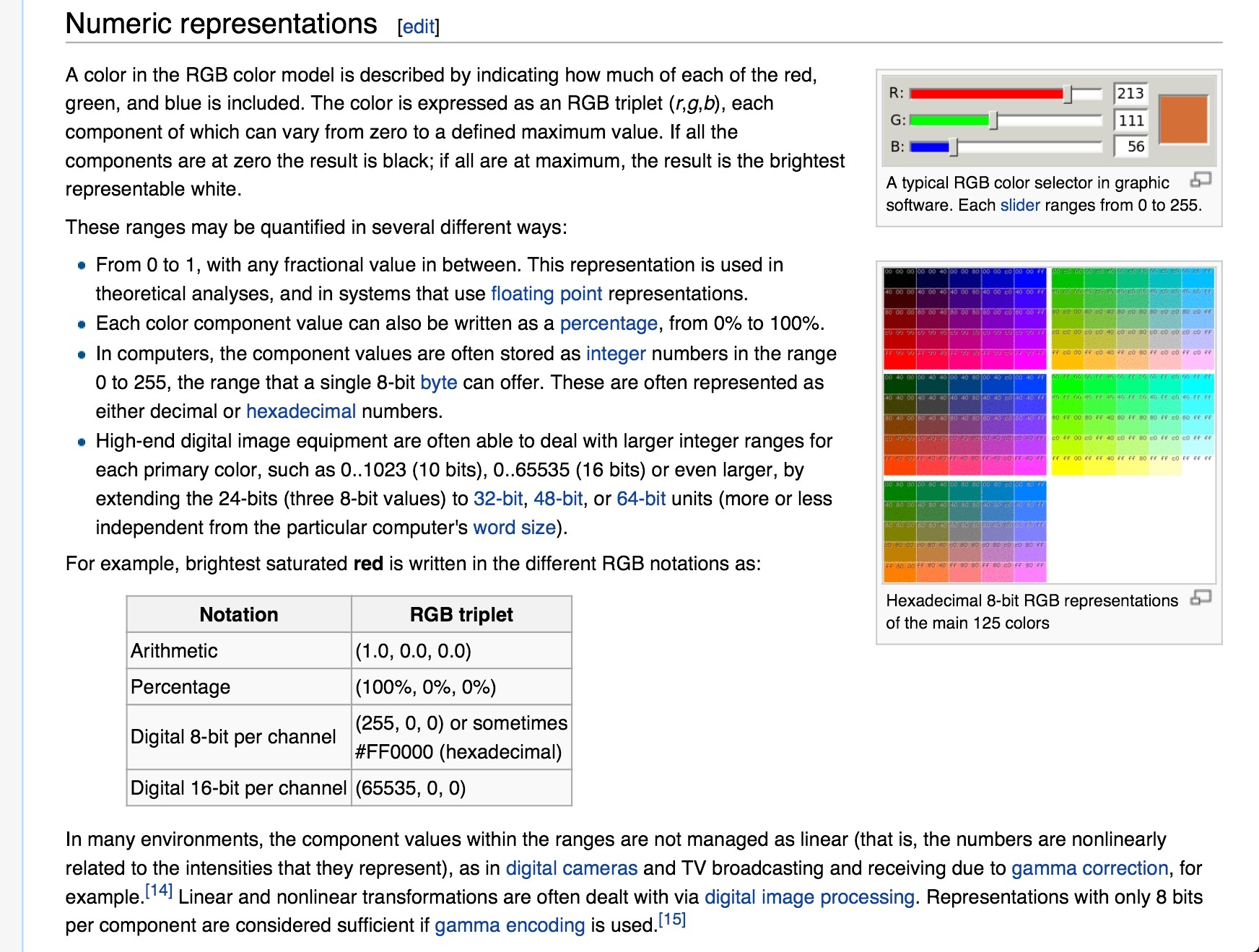

You're "contemplating using 255 as full on"? What a novel concept. Perhaps you might take a few moments to understand the numerical representation of RGB and what it means rather than making something up in your head? It's just a thought; a new way of approaching problems for you.
Wikipedia's article on THE RGB Color Model might be worthwhile reading for you, particularly the section on numerical representations. I've posted it below to save you the trouble of clicking the link.
The 255 value is not arbitrary. You should probably understand this before you get too creative in your wild fantasy world of programming.
The 255 value refers to the duty cycle (time on) and same as you refereed to in post #34 and #39

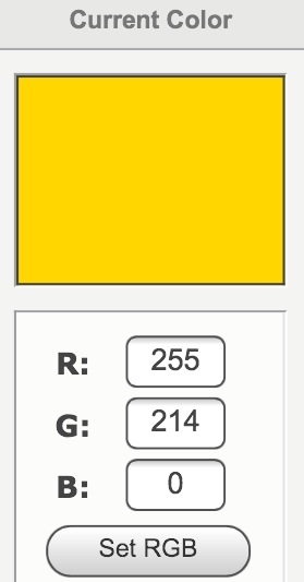

I'm thinking If I take one second (1000ms) to equal 255 then take the percentage from the color chart
Say the chart shows $FFAF00 Red = 255(full on) Green = 214 (55% on) and Blue = 00 (off)

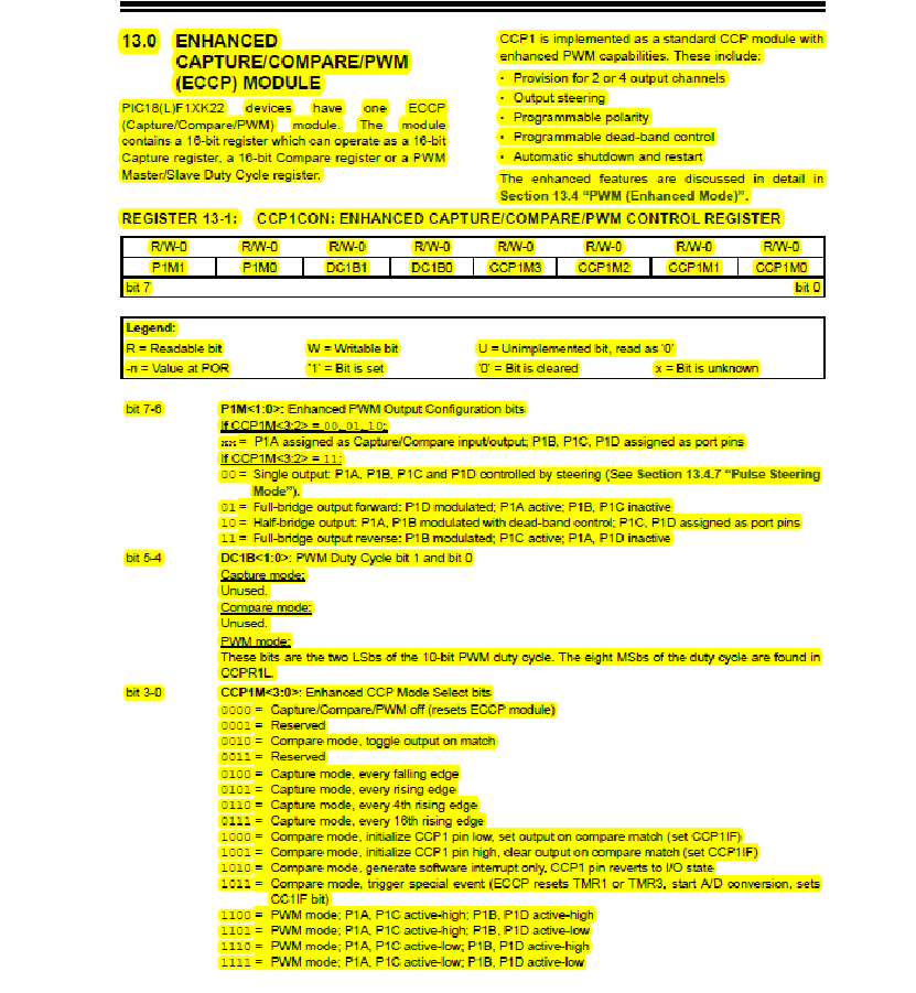

after I figure out how to get the 4 PWM ports to output. Using the CCP1CON register settings but have yet to achieve
What are "the" CCP1CON settings?
As LittleGhostman has pointed out numerous times the 4 PWM outputs aren't independant. They're used to drive half and full bridges so the signals will look different than a single output.
I realize I only have one PWM but 4 seperate output pins (C2,. C3, C4, C5)
These are all multiplexed together. I don't care if the outputs are different. Using three of the output pins so two will be the same and one will be 180 degrees different.

Here are the ccp1con regesiter

Ok. If you want to use the Single Output PWM mode then you also need to set up the PSTRCON register.
In Start1() you already have the three pins set as outputs, so try adding PSTRCON = $07 to get the PWM signal out on P1A, P1B, and P1C

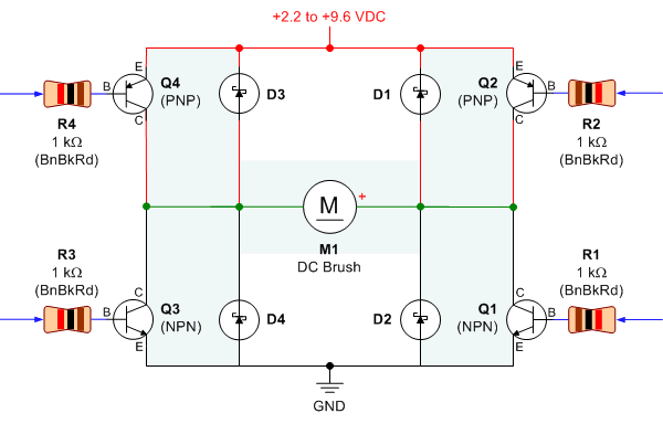

i know you obviously have googled H bridge circuit so you understand exactly what the pwm mod if for, but as a refresher lets take a look at a basic H bridge
look at page 116 of the datasheet for the chip, you will see that first mode 1 pin modulates ((turns off ((pwm)))
so that mode is no good because only one colour will be under pwm control
next mode
now this is half bridge mode, almost looks promising, because you get two modulated out puts YAY problem solved you say! BUT NO, look at the diagram in the datasheet page 116 figure 13.4
in half bridge mode when one pin is high the other is low, this is for running a half bridge, look at the diagram above work out how it functions.so if you used half bridge mode only one colour would be on at a time then another colour on, they would never be on at the same time that is the point of this mode
next mode full bridge mode forward. now in this mode you would get one colour on as in no duty cycle it would just be on one other colour would be off completely off and the other would be doing want you want i.e it would be modulating
next mode is full bridge reversed wich the exactly the same as forward only reversed!
so as you see 4 outputs with just one pwm mod is as useful for simulating a candle as a circle is for drawing a straight line!
yes you have 4 outputs no they dont modulate at the same time no you cant make them into a candle.
study that drawing in the datasheet then look at the H bridge circuit and figure out what each mode does, a clue a pnp transistor needs to be logic 0 to conduct and a npn transistor needs a logic 1,
and that is exactly what that pwm unit is meant for, it is designed to run a motor forwards and backwards, it dosnt at any point have 4 or even 3 modulated outputs at the same time and the only time it has two outputs modulating they are not doing it at the same time they are designed to run a npn and pnp transistor at the same time,
