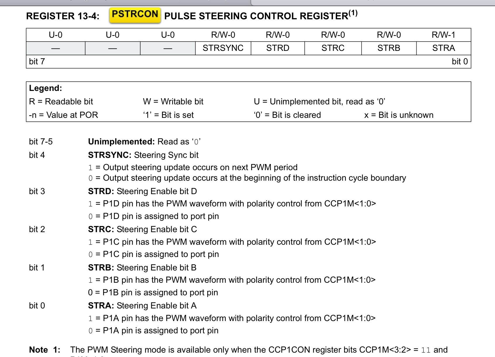

Just curious as to how to get the outputs to use pwm and if I am interpreting the data sheet correctly that the outputs CAN be 180 degrees out of phase. I may just be grabbing straws.
YES I should have posted the data sheet showing the PSTRCON register. THANKS
Question is in reality can the outputs be 180 degrees out of phase. I looked at the timing diagrams but ??

Using the CCP module in half bridge mode will give you a PWM signal on P1a and the inverse signal on P1b.
LG mentioned this a while back... P1c and P1d are the same as the other two when in full bridge... You may be able to increase the dead time to alter it slightly more..
You can use the Pulse-Steering Mode to output a PWM signal onto multiple output pins using the PSTRCON register, as opposed to any of the half/full bridge modes. The output polarity of the bits is set by the CCP1M<1:0> bits of the CCP1CON register.
See section 13.4.7 in the datasheet

After reading through the data sheet, I'm back to the belief that you have exactly one active output, the pin connected to the yellow LED. Watching your video closely, I do not see any indication of any red color. I think it looks decent – I'm just pointing this out in the hope of understanding what you're actually doing.
The 18F13K22 has one ECCP module and therefore one PWM output available. It's true that this single output may be made available on four pins, but there is only one PWM channel. The four output channels can be used in various configurations to control an H-bridge for motor control, but all four outputs change in lockstep with each other with options for polarity of each output and a (configurable) delay before switching some of the outputs. From the data sheet:
13.4.7 PULSE STEERING MODE
In Single Output mode, pulse steering allows any of the PWM pins to be the modulated signal. Additionally, the same PWM signal can be simultaneously available on multiple pins.
Once the Single Output mode is selected (CCP1M<3:2> = 11 and P1M<1:0> = 00 of the CCP1CON register), the user firmware can bring out the same PWM signal to one, two, three or four output pins by setting the appropriate STR<D:A> bits of the PSTRCON register, as shown in Table 13-2.
While the PWM Steering mode is active, CCP1M<1:0> bits of the CCP1CON register select the PWM output polarity for the P1<D:A> pins
