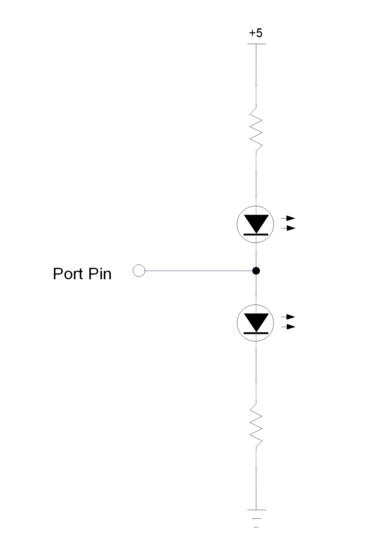

I can't really understand MrDEB's fascination with a 180° phase shift between yellow and red LEDs. This just means that when the yellow LED is on, the red LED is off and vice versa. The two LEDs are not independently controllable with the single ECCP module of the 18F13K22, as was pointed out by LittleGhostman many, many pages ago in this epic tale. Alternate yellow/red LEDs don't seem to offer much in the way of making a decent presentation of a candle. If the yellow is dimmer, the red is brighter. In this arrangement, there is no off state, nor even a dim state; changing the duty cycle can only vary the overall color from yellow to orange to red.
If there is some reason that alternating yellow/red LEDs are useful, it's a simple matter to achieve this with a single port pin.

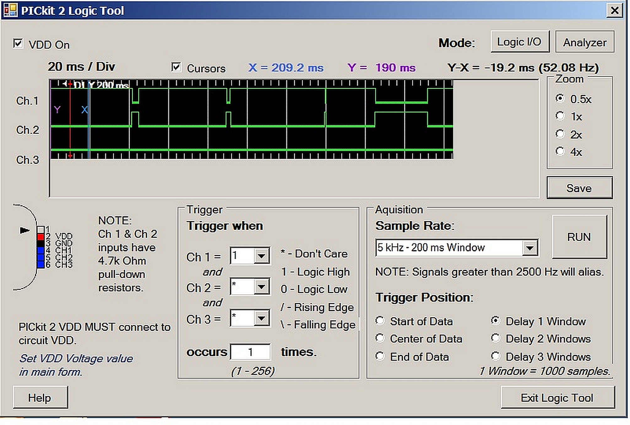

At this point in time I just am curious as to how to accomplish getting two of the outputs out of phase. I originally wanted to try this with out of phase outputs but at present the results are fine but for reference it might become in handy somewhere some time.
Going to try out tumbleweeds suggestion just for reference.
It would definitely be handy for driving an H-bridge. Beyond that, probably not much else, particularly in regards to this topic.
Well tumbleweed gets the chocolate cigar today. The code he posted works to have the C5 (yellow led) out of phase with C4(red led.

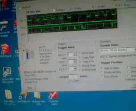

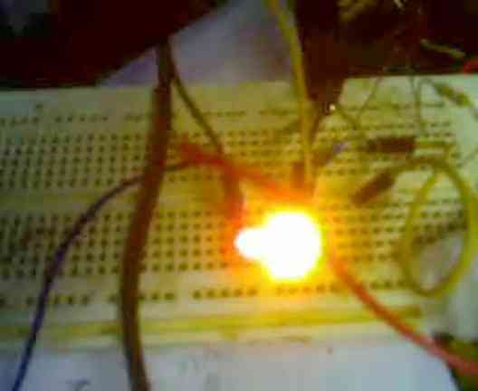

Here is a really crappy video of the two leds (kinda bright without the paper shade, the leds are 1000mcd piranha leds. The red is on the left in the video.
The screen video shows the yellow on channel 1 and the rel led on channel 3. Wouldn't say they are 180 degrees but maybe I need to change the logic analyzer settings. I need to find out how to do better screen shots.
SCREEN SHOT
Jonsea is probally right. The only use of using the out of phase outputs would be an H bridge or a candle simulation. With the red out of phase LOOKS like it has possibilities of a better candle sim. Going to put entire citcuit into holder and see what comes out.

I am going to take a closer look at the logic analyzer tomorrow as the wave does not appear exactly out of phase but it could be a setting on the mplab. Curious why nobody even commented on the two completely different wave forms.

As for the crappy screen shot video, Have yet to figure out why the wave forms are way different but they appear close to being 180 degrees out of phase with the delay issue.
Tumbleweed posted the code I am presently using for this screen shot and comparing my version to Tumbleweeds revision found I have the
CCP1CON.bits(1) = 0 in the PWM2 but not CCP1CON.bits(0) = 1

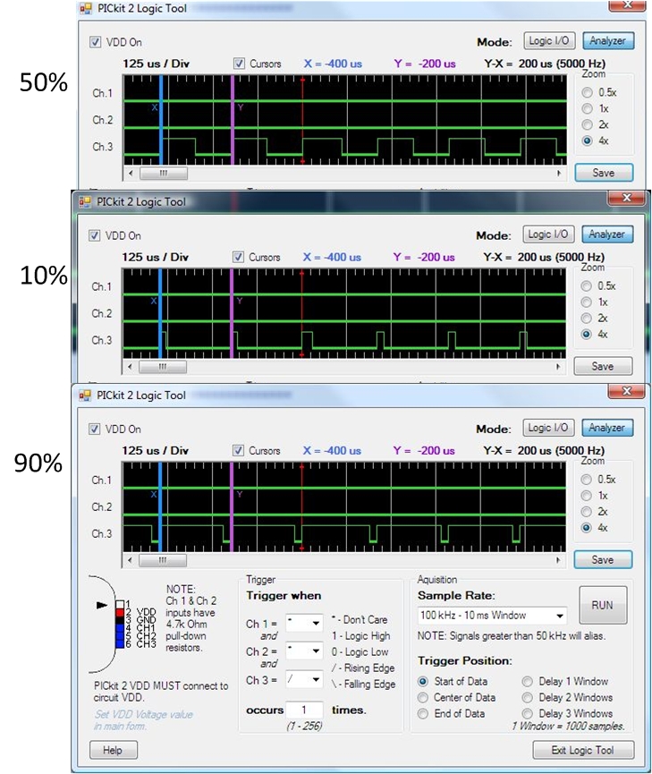

Glad to see you figured out how to do a screen capture MrDEB. There's at least some progress.

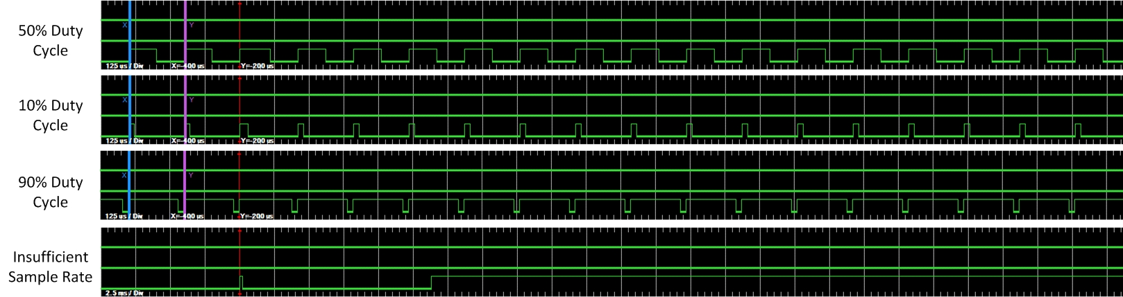

Unfortunately, the screen capture you posted isn't actually showing what you think it does. Let's first look at three PWM plots. THE PWM module is running at 5 KHz (the same as you code), and the plots show 50%, 10% and 90% duty cycles. The blue and purple cursors show one PWM cycle, with the frequency at the upper right of each plot. Note that the pattern is continuous and one cycle always takes 200 usec regardless of duty cycle. If the duty cycle had been varying during the sample period, the ratio of high to low would vary, but the period would be the same.

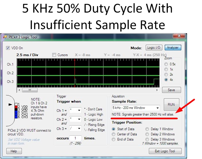

If you look at the screen shot MrDEB posted, it doesn't show this regular pattern - even with a varying duty cycle, the pattern should be continuous. So what's wrong with MrDEB's plot? Look at the plots above. The sample rate is 100 kHz. The sample rate on MrDEB's plot is 5 kHz, with the note Signals greater than 2500 Hz will alias. The plot below was taken with a sample rate of 5 kHz on the same 50% duty cycle data in the first plot above. It looks totally different and it's totally wrong.
This can be seen more clearly with the saved data from the logic analyzer, a portion of which is shown below. Much more data is shown than in the window of the logic analyzer screen. The top and bottom traces should show similar data at different time scales but obviously do not.
The sample rate must be greater than twice the highest frequency in the data according to Nyquist. If it's not, transitions in the data can be missed. So try again, with a sample rate of more than 10 kHz. Then you'll see what's really happening.

It dosnt need a closer look, read what john posted, there is a little red line, alter the settings you have, because you have them too low
