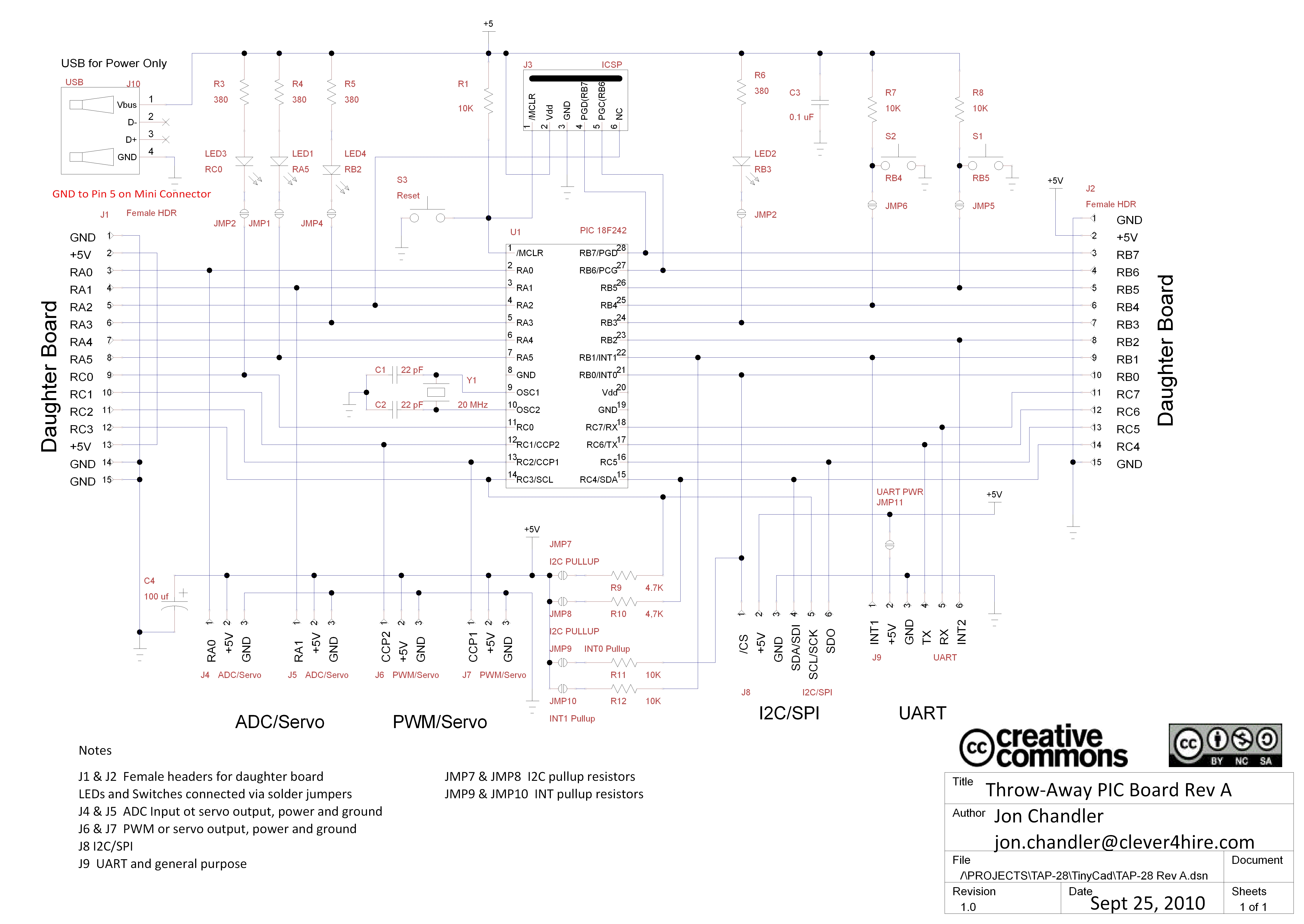

There's no mystery here - you're not saving the original with enough resolution. You need more pixels.
These images are for an 11" x 8.5" schematic. The first image is 374 x 265 pixels and each following picture is twice the resolution. The forum software takes care of limiting size but you can save the image and it's big enough to see.

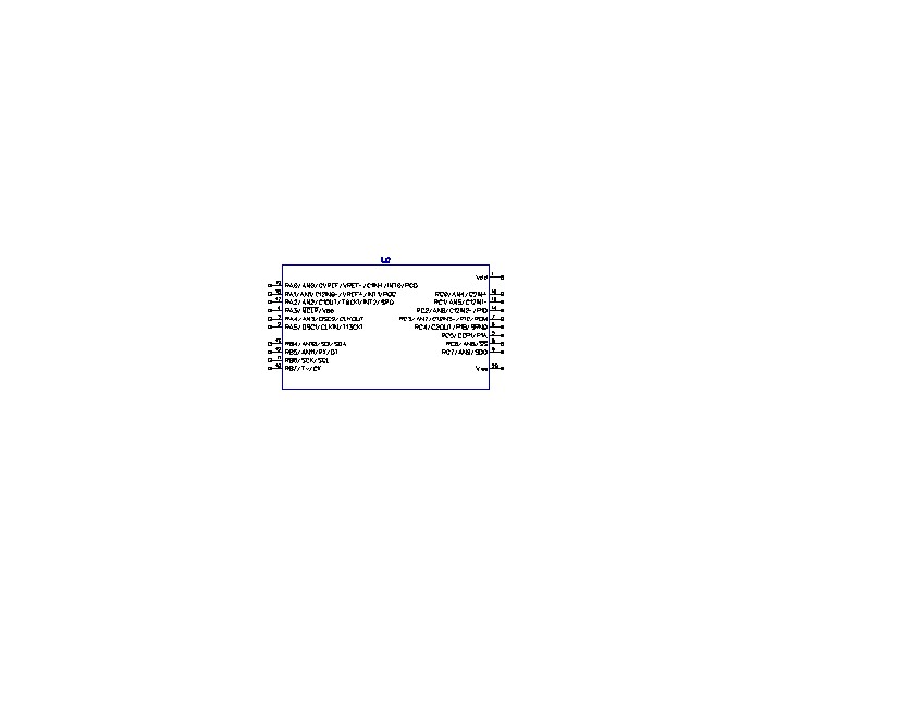

Jon the pic I posted is only 15 kb and is clearly readable the problem is the user of diptrace is not saving the file as the hole page and it is just like you scaled a jpg
this is saved as a page jpg its not readable
Same thing save as bitmap image the resaved as a png
And this one is saved at the max setting of 600 and a jpg
Well I did PRIVIEW PRINT then compressed the file and hopefully this is what be80be did/

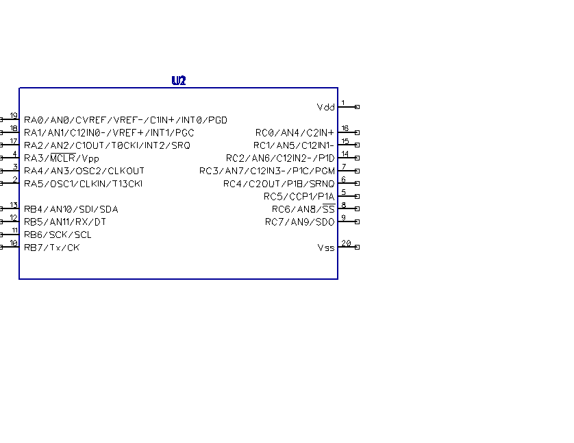

If you post a zip file, it will save many the trouble to look at it. You're asking people for help. Why make it difficult to view your schematic?
Start by exporting a large enough image. Look at what I posted. If you don't start with enough pixels, nothing anyone can do will make the image clear. I don't have DipsTrace – I think there's an option for how much to magnify when you export.
Then save it in a compressed format. Burt likes png. Irfanview will do that. I use jpg with good results – just set to at least 80% quality. Do not save it as a bmp – this format has no compression and the resulting file will be huge.
People post hundreds of schematics a day in forums. It really can't be that difficult.
I still looks exactly the same. No difference? You should save it in the program (As "X" RESOLUTION) not in Print Preview, Print Preview does nothing.
Edit: Print Preview does exactly what it is designed to do (ON YOUR COMPUTER) NOT TO USE ELSEWHERE, PASSING IT ON TO SOMEONE ELSE, WON'T WORK.
It's not an EDITING PROGRAM, be80be said to save it in the "PROGRAM" then zip it, but you won't have to zip it, if you save it at the highest resolution .png (JUST UPLOAD IT)

I don't use DipsTrace, so I didn't realize you were generating the image file the wrong way. However, I have said numerous times that you need more resolution. More pixels. So perhaps you should check how big the image is that you're starting with? Seems reasonable rather than trying things like pressing the SAVE button HARDER in the hopes that it will make the image bigger don't you think?
In Irfranview, the image editing and conversion program you use, you can click IMAGE on the main tool bar and then click IMAGE INFORMATION. In the first few lines of the box that pops up, it will tell you the image size. As Mr. Pumpkin explained a year and a half ago, an image width of around 2000 pixels is a good starting point.
If your image is SMALLER than ~2000 pixels across, go back to DipsTrace and do something different. Don't get the idea that your smarter than everybody here and decide you can just rescale the image in Irfranview. You'll just get a bigger blurry image if you do that. You can't put back detail that wasn't included in the original image.

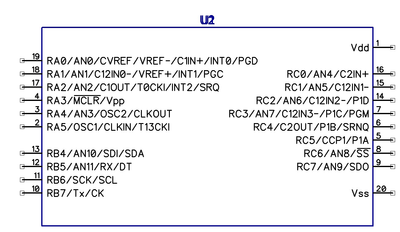

He is using is using diptrace you can only. Save it in print preview but if you set it for full page then scale to 600 it gives you a nice readable picture I like changing that to a png in paint cause it's a smaller readable picture.
After reading Jons post I see what step I was missing. I needed to scale AFTER I open the PRINT PRIVIEW then set the SCALE to more than 2000
I was making the resolution increase after I saved the PRINT PRIVIEW
NOw its readable.

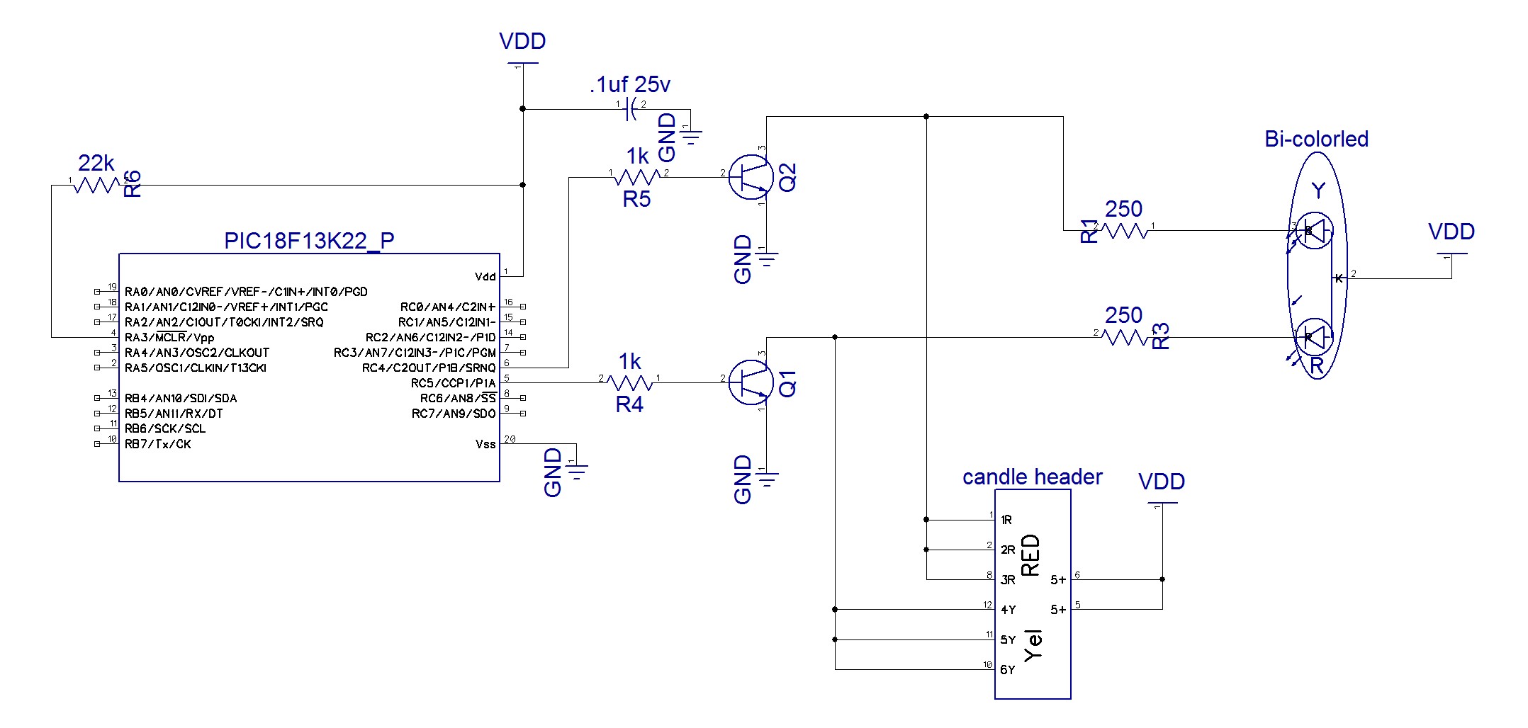

now to my small other problem that I already have solved but perhaps someone can see perhaps how to remedy the problem.
I received the new LEDs and 2n3904 transistors
I failed to realize the LEDs are common cathode not anode. So to remedy I just connected the NPN transistors as an emitter follower. Doesn't seem to make any real difference except I see my RED is to bright. It over blends with the yellow.
Before inserting the pic I wanted to verify current draws etc so I connected 5v and enabled the base of the transistor which has a 1k resistor. Measured the voltage on the COLLECTOR AT 5V AND THE EMITTER AT 4.6V. With the LED on (LED is connected to the emitter then has a 150 ohm resistor to ground) I measure 15ma current draw on the LED. The transistor base current measures 2ma. The single LED could use more light so contemplating adding more LEDs as suggested.

I'm not sure what your question is.
Supply voltage = 4.6 (per your measurement)
LED forward voltage = 2.5 (from data sheet)
R-LED = 150 ohms (per your statement)
Vs – V-LED = 4.6 – 2.5 = 2.1 volts
Ohm's Law
V = IR ==> I = V/R = 2.1/150 = 0.014 amps = 14 mA.
This is within your measurement error. There really isn't any need to breadboard and verify LED current levels if the supply voltage, forward voltage and series resistance are known. Ohm's law is a fact.
As far as brightness is concerned, this LED is a low-brightness LED designed to be a status indicator. You can increase brightness somewhat by increasing the current to 20 mA by decreasing the series resistor but it's not going to make a substantial difference.
I have no question, just presenting what I had to do to be able to use the components I have due to my oversight on LED selection. I had already soldered it all together so breadboard was not utilized for measurements. Measurements were taken to assure everything was as planned and no magic smoke escaping. I contemplated using LEDs with a higher MCD (non diffused) but the viewing angle was 20 degrees instead of 60 as the diffused leds are.
My next move is to increase the red led resistance to desired level and maybe decrease the Yellow resistance slightly.
