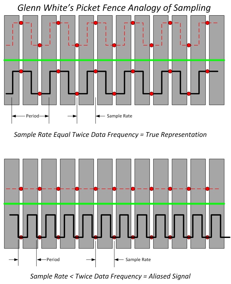

Here's a simple way to understand aliasing when digitally sampling data, thanks to Glenn White. When data is digitally sampled, discrete data points are measured periodically. This is like looking at the data through the gaps between the boards in a picket fence – you can see what's happening at each gap, but you don't know what's happening between the gaps. Look at the top half of the top graph below. The red dots are the data we sample, and the red dashed line is what we believe to be happening. The bottom half of the top graph shows the true data that was sampled. Notice that the data has been sampled twice for each period of the square wave.
Now low at the top plot in the lower section. Every time the data was sampled, the value was zero, and the dashed red line is what we must conclude the data looks like – a straight line at zero.
But look at the bottom section. The real data is a square wave, but because we sampled too slowly, all we saw was zero values. Depending on when we started sampling, the sampling might have returned all high values, and we'd think it was a straight line at the high state. If the sample rate is less than twice the highest frequency of the data, it will alias – it will look like something it's not.
MrDEB's data is aliased because the sample rate was too low. There is no way to tell from the measurement what the data actually looked like.

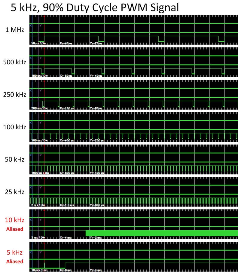

One final post to clarify sample rate issues....
In this case, we know the PWM signal is modulated at 5 kHz, so we know that we need a sample rate of more than 10 kHz. But what about a case where the frequency of the pulse train is unknown? How do we know what sample rate is needed?
The secret is to start at the highest sample rate possible to get an idea of what the data looks like. The plots below show a 5 kHz 90% duty cycle signal at the available sample rates of the PICkit 2 logic analyzer. The top trace is with a 1 MHz sample rate, and shows just a few periods of the signal. This is useful to measure the period of of the waveform with good resolution; we could calculate the frequency accurately from this measurement.
The wave forms down the chart show the effect of decreasing the sample rate. The waveform is scrunched together, but more of it is shown. The lower sample rates are good for observing missing pulses, varying duty cycles or frequencies and even decoding the bit stream of serial data.
The data gets more and more scrunched together until finally at a 10 kHz sample rate, the pattern falls apart. This data has been aliased because the sample rate is too low. The measurement is garbage at this point and does not reflect reality.
So the answer is pretty simple. Start at the highest frequency possible. This allows you to see a small portion of the waveform with good resolution. Decease the sample rate to see longer periods of the signal. When the signal falls apart, you've gone too far. Each of these measurements took literally a few seconds, so the time to do it right isn't much longer than the time to get garbage.
This post is for those who may be trying to learn something from MrDEB's follies. I'm certain he won't be interested.
This is true, but it is only a theory. In practice you would want to sample about five times in one cycle (of the highest sine freq.). If you have proper low-pass filtering etc.
Sampling at twice the highest frequency is just the absolute theoretical limit where you have the slightest theoretical chance to recreate the waveform you just sampled.

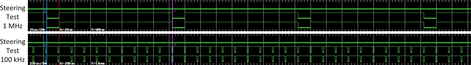

One final post to wrap this up. The chip I used for the PWM testing above was an 18F25K20, which happens to have the same ECCP module with steering as the 18F13K22, so I decided to check out the steering feature since MrDEB did not provide any real measurement showing the in phase/out of phase feature.
I used the settings from Tumbleweed's code back on page 17 of this saga, and measures P1A and P1B.
// this assigns PWM output onto P1A, P1B, and P1C pins
// Note: The PWM Steering mode is available only when the CCP1CON register bits
// CCP1M<3:2> = 11 and P1M<1:0> = 00. Also, the TRIS bits must be set to output
// mode ('0') to enable the pin output driver in order to see the PWM signal on the pin
PSTRCON = $07  // sets all outputs
// P1A-P1B polarity
// CCP1CON bits 3-0 CCP1M<3:0>: Enhanced CCP Mode Select bits
// 1100 = PWM mode; P1A, P1C active-high; P1B, P1D active-high
// 1101 = PWM mode; P1A, P1C active-high; P1B, P1D active-low
// 1110 = PWM mode; P1A, P1C active-low; P1B, P1D active-high
// 1111 = PWM mode; P1A, P1C active-low; P1B, P1D active-low
// calling pwm.Start1() sets CCP1CON = $0C, so bits[3:0] = 1100 (setting all active high)
// to get P1A and P1B opposite, try setting bit1 = 0 and bit0 = 1
CCP1CON.bits(1) = 0
CCP1CON.bits(0) = 1
Using the CCP1CON settings above, the P1A and P1B signals are in phase as shown below with the same 5 kHz, 90% duty cycle signal used above. In fact, no combination of these two bits resulted in out of phase signals, and I didn't have enough interest to dig deeper into the problem.
See Following Posts For Steering Test Results
The top trace is sampled at 1 MHz to give good resolution. The bottom trace is sampled at 100 kHz to show the series.

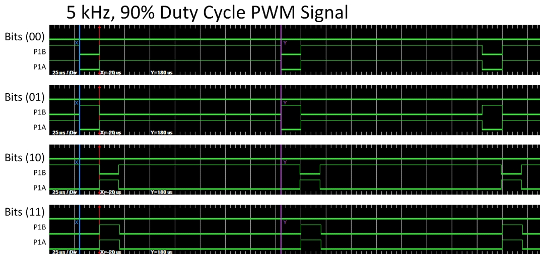

Speaking of not getting what you think you're getting, the 90% duty cycle is HIGH 90% of the time. If you have an LED connected between V+ and the port pin such that a LOW port pin turns it on, the duty cycle would be inverted. This 90% duty cycle would be effectively a 10% duty cycle.
I just realized what the problem may be....it's actually spelled out in Tumbleweed's comments in the code:
"Calling pwm.Start1() sets CCP1CON = $0C, so bits[3:0] = 1100 (setting all active high) . To get P1A and P1B opposite, try setting bit1 = 0 and bit0 = 1."
I set the CCP1CON bits before I started the PWM module, so the start command reset the bits to (00). That's what happens when I do things on the spur of the moment late at night. I will try this again later today.
As I realized, setting the CCP1CON bits after the PWM.Start1 command solved the steering issue. The plots below show the results.
With CCP1CON(1,0) = 0,0, P1A (bottom trace of the pair) and P1B are in phase.
With CCP1CON(1,0) = 0,1, P1B is inverted.
With CCP1CON(1,0) = 1,0, P1A is inverted.
With CCP1CON(1,0) = 1,1, both P1A and P1B are inverted.

I had the CCP1CON in the PWM2 module but set the wrong bits. I never tried running with the correct CCP1CON in the PWM2 module
* Name    : Start1                                                         *
* Purpose : Start PWM Channel 1                                            *
Public Sub Start1()
    CCP1CON = $0c    ' $0c  PWM mode P1A, P1C active high :P1B, P1D active high
    Output(FPWM1Pin)
    Output(FPWM2Pin)
    Output(FPWM3Pin)
    FTMR2ON = 1
    PSTRCON = $0F       ' PWM output steering register
End Sub
but need to set bit 1 and 0
correct bit settings
CCP1CON.bits(1) = 0
CCP1CON.bits(0) = 1
* Name    : Start1                                                         *
Public Sub Start1()
    Output(FPWM1Pin)
    Output(FPWM2Pin)
    Output(FPWM3Pin)
    FTMR2ON = 1
End Sub
CCP1CON.bits(1) = 0
CCP1CON.bits(0) = 1
Huh? Since you apparently never took a valid measurement with the logic analyzer, how do you know what you had?
I tried several sample rates but none were 180 degrees out of phase until I put the
CCP1CON.bits(1) = 0
CCP1CON.bits(0) = 1
as they should be. The 180 out of phase adds to the candle effect which is what I was after.
