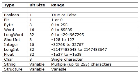

I will be posting later with luck, i am trying to track down all the limitations of swordfish, there are a few that i need a work around for. will swordfish handle say a double long?
well apparently swordfish wont do multi element array's, so i was thinking sticking it in one array, but have 64 bits, so 8 bits for red 8 bits for green 8 bits for blue 8 bits for intensity then the rest for one the other rgb leds and the third led could be one taken from other, that way all three leds different, but i would settle for 32 bits

I've made PDFs of two sections of the Swordfish documentation, which may be found by clicking "help" in the Swordfish IDE menu bar.
The first is the section on variables. It may be possible to use strings to hold 64 bits, but the overhead of using strings is huge.
The other section is on structures. Using a structure, several variables may be linked together and treated as a unit or separately. I must admit I don't really understand how to make use of a structure but apparently this is almost straight C, so maybe it will make sense and be useful.

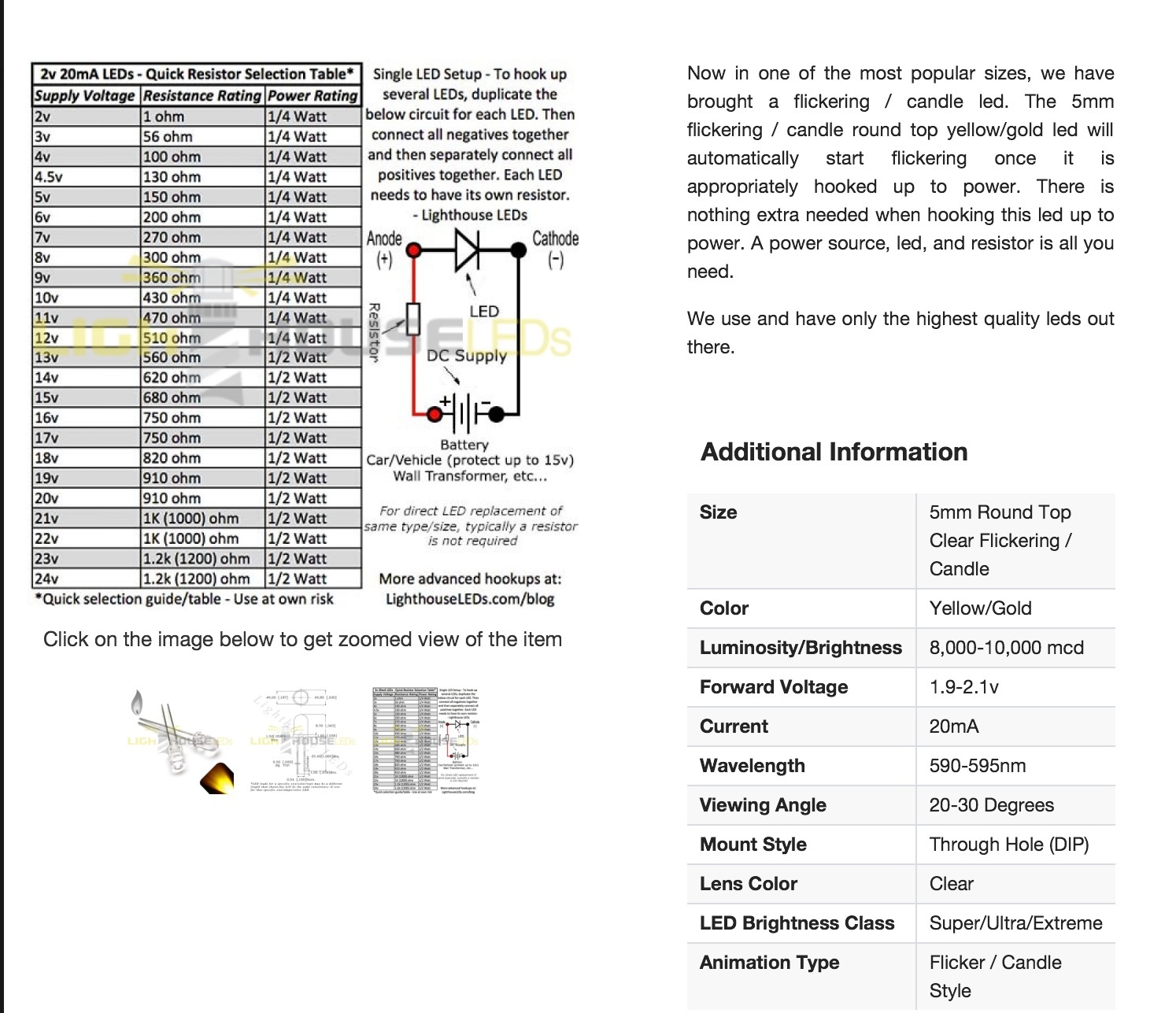

At this point in time , am going with the basic idea of using the basic circuit that Welcome to wire2wire LED candle uses but incorporating the 18F13K22. Using one of the routines I have operational or trying out what Littleghost comes up with. Still tinkering with the code Tumbleweed posted but not any great results as yet.
Been thinking about how to house each candle? PVC pipe cap is one way but kinda spendy per cap.
