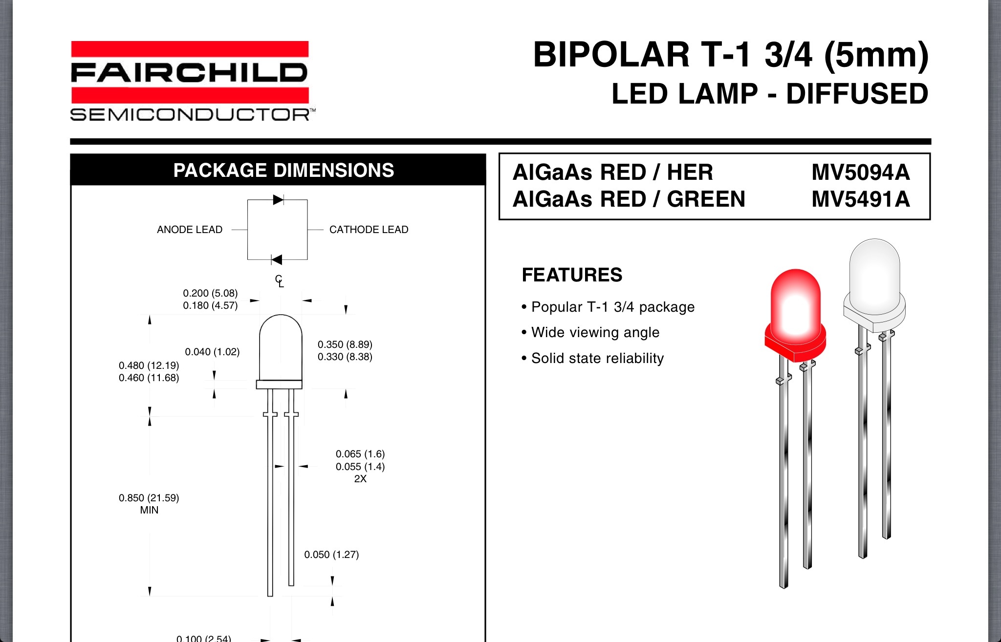

If this data sheet is for the LEDs you ordered, they will be very dim. The rating on the flickering LEDs is 8000 – 12000 mcd. The data sheet above is for 120/200 mcd, quite a difference.

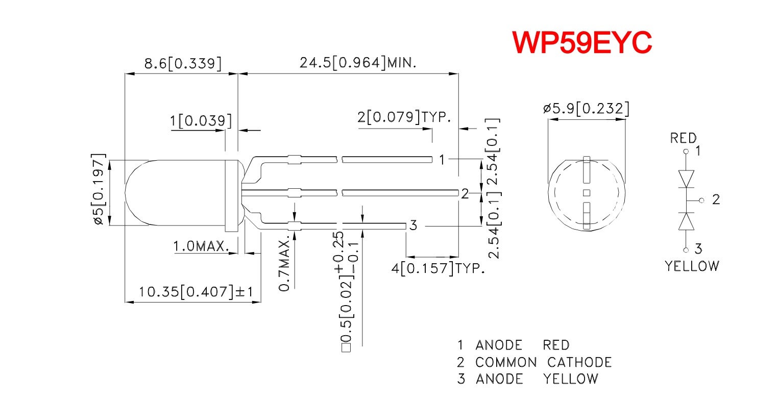

Sigh. If this is from the part you ordered, Kingbright Part Number: WP59EYC apparently, this is not going to work (without additional parts).
These LEDs have a common cathode. That means you supply V+ to the red element through a suitable resistor and to the yellow element through a suitable resistor. The common cathode is commented to ground. This means the PIC is sourcing current.
If you're planning to have one of these LEDs per candle, and you're planning on a maximum of 20 mA per LED element, that's a total of 6 LED elements at 20 mA = 120 mA worst case maximum that the PIC must source.
As stated in my post #147, the 18F13K22 can only source 70 mA total. Yes, an individual pin may supply 25 mA, but the total must be less than 70 mA.

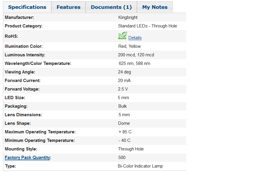

The LED data sheet I posted was not the LED I ordered, I only used that data sheet to indicate that bipolar and bicolor are both correct. Sorry for the misunderstanding as I don't think I stated that this is the part I am going to use.
Here are the two different sized LEDs I ordered
https://www.mouser.com/ds/2/216/WP59EYW-45838.pdf
https://www.mouser.com/ds/2/423/VAOB-10GACE2-C-8173.pdf
Both common Anode.
The flickering led your referring to is not a diffused lens. That is why the mcd is so high but reading through most of the candle projects, a diffused lens is preferred.

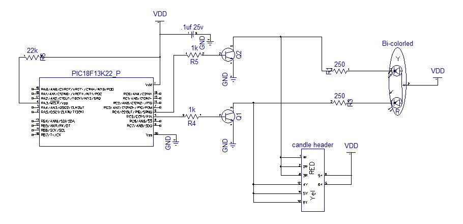

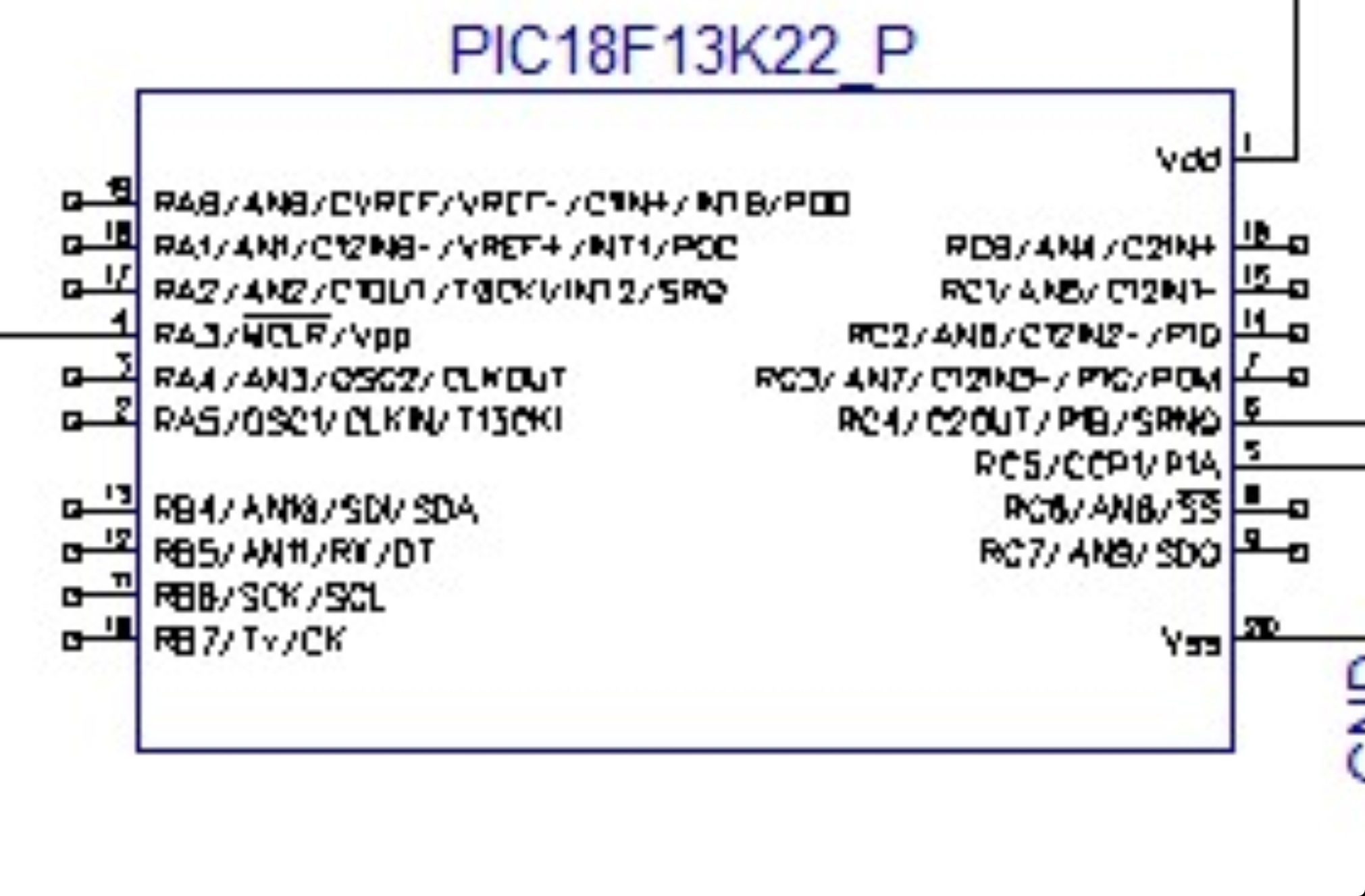

Lets try this for schematic readability. Set at 800 x 600 pixels with 675dpi. Not sure its any better but it looks ok on this end but then all the other schematics did to. Maybe I have the size to large?

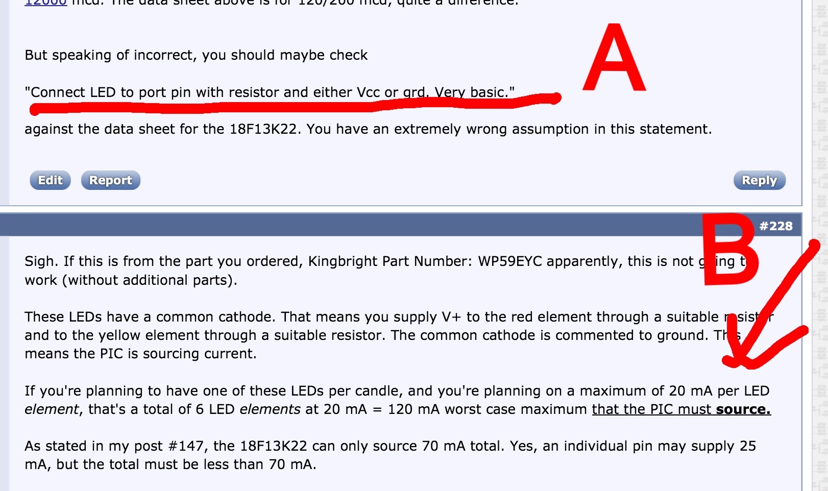

I don't seem to have the ability to explain things in a way you can understand. I apologize for my inability to do so. Let me try one last time.
Referring to the picture below which shows my last two posts, in the underlined part A, you say it doesn't matter whether you connect an LED between V+ and a port pin, which means the PIC is sourcing current, or you connect an LED between a port pin and ground, which means the PIC is sinking current. This is based on the fact that a PIC18F-series port pin can source or sink 25 mA.
But this does not take into account the maximum current the 18F13K-whatever can source or sink. As I again explain at B, this particular chip can SINK 200 mA, but only SOURCE 70 mA. Any port pin can handle 25 mA, but the TOTAL LOAD can't exceed these limits (200 mA sink, 70 mA source). So the point to take away is that it makes a very big difference how you connect a bunch of LEDs to a PIC.
The above is general information based on what you have stated you want to do here many times – each LED on a separate port pin, no transistor drivers, 20 mA current each. If you do it this way, it's important to understand the different capabilities between sourcing current and sinking current.
In the schematic you have shown, this doesn't matter because you have transistor drivers. But in as much as the plan chances with every post, you should be aware of this consideration.
The schematic you have posted is not legible. Please put on your glasses or take off your glasses and notice the pin labels are an indecipherable blur.
And finally, the first LED you have ordered is common cathode. It is exactly the part I indicted in my post above.
The transistors were added due to the fact it was mentioned somewhere in this thread and the project Welcome to wire2wire LED candle has similar setup. Using the transistors will enable me to connect more LEDs to the main board.
As for the schematic, I will try a higher resolution or try changing the fonts from vector to true type seeing how the pin descriptions are hard to decipher. In addition using the transistors avoids any or almost any possibility of abusing the pic and allowing the magic within to escape.
On using separate LEDs, I considered this option as it would perhaps produce more light. Am going to apply hot melt glue to the LEDs anyway. I have lots of red leds so I plan to breadboard using one bi-colored led vers several red and several yellow leds for comparison.
In my design explanation, "Connect LED to port pin with resistor and either Vcc or grd. Very basic."perhaps I simplified it to much. I usually get my code working in sections then draw out schematic and making corrections as needed. taking into account the limitations of the pic as per data sheet. Another reason why I decided to go with the transistors then I should have no worries about exceeding the limitations of the pic.

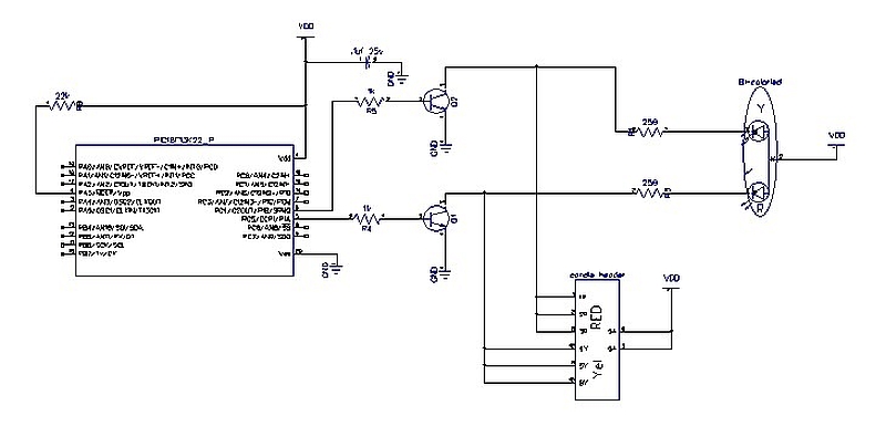

Lets try this schematic. I changed from vector to true type and chnged the resolution to 1024 x 768 with 1000-dpi
The problem with the images is this candle-schematic2-jpg.82935 see that JPG that means it was saved as a picture like any picture when you change the scale it distorts.
You need to use PNG witch don't distort and are scaleable. That's why there are such a thing LOL
Will give that a try Burt. I am frustrated that the schematic post, following the suggestions still don't produce a readable schematic.
Will try using png. THANKS in advance.
Went back to the file I posted and it is a pNG.
Diptrace, using the PRINT / PREVIEW option as suggested, only has jpeg or bit map. Will try the bit map then using I.
The schematic Jon posted a link to and he mentioned it was done using DIPTRACE but posted on a different website. I wonder idf that might have something to do with it. I would be interested to see Jon post a schematic done with DIPTRACE on Electro tech. I have posted schematics on other sites using Diptrace with no problems.
Here is same file but saved as a bit map in Diptrace PRINT PRIVIEW then increased resolution 1024 x 768 with 860dpi and saved as png it is a bigger file for sure

Zip up your Diptrace file and post it
Dang you can read it LOL
