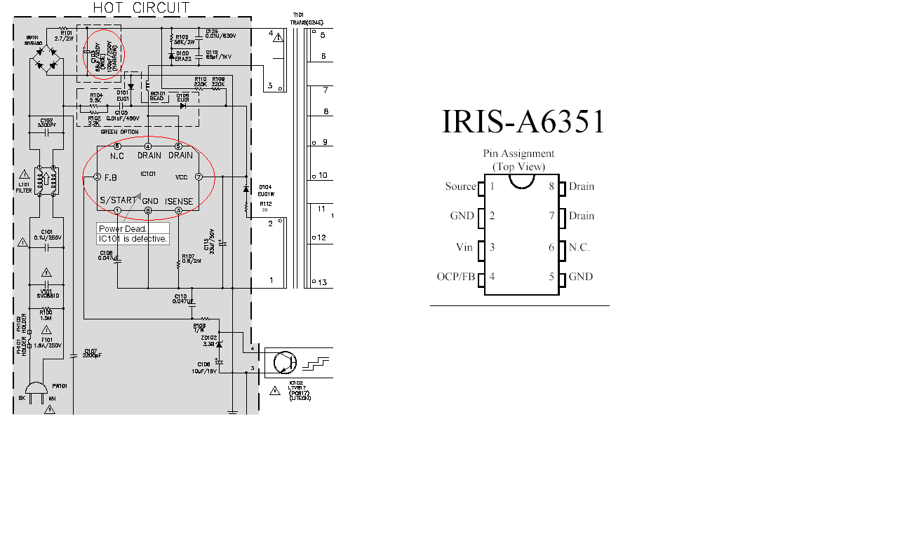

It's working voltage is 110v ac. It's accidentally plugged into 220v supply line and burned. I opened it and see an smps board that has an IC marked 541 and a nearby resistor burned fully. All other parts seems good. It doesn't switched on now. Is it repairable? I would appreciate if somebody could help on how to replace the smps with an ordinary power supply. A total of 4+3=7 lines are going out from the smps board which includes +5v,+12v,-12v and some others. The player has a 220-110v ac converter adapter I used.
give me the make and model of yr player and we will be able to sort the power supply out and get it working-dont just blindly replace what has obviously burned up because due to other faults that may be present you will just cause more damage-so make and model please..........
I haven't tried replace of resistor because it's value can't read. Here're the details of the player:
Make: Toshiba SD-4980 SU, July 2005
On close inspection I found two more items burned. Burned items are:
1. IC A6351 SK541 4230 8pin DIP, Component id: Q802
2. Resistors R817,R808
3. Big cap 68uF, 200V C805. It is bulged, broken and paper came out.
Hope you can provide with a schematic of the supply.
I'm sorry that it has total 7+4 lines are coming out for connectors. It's details are:
PWON,GND,5VSB,-12V,+12V,GND,PD5V and
GND,F,F,v-20.
I would rather interested if I could replace smps with an ordinary supply. Any help?

Thanks. I searched on net and found the IC is IRIS A6351 which is an integrated switcher. So it can be the heart of the smps. Have to search whether it's available for replacement.

The model is different in the manual you sent - SD-4900. However I tried to track out the ps unit which is somewhat same. On close look I think the switcher IC is also different. I can't find the IC part no. on the manual. But same function only. I've attached the comparison of IC's pin nos. Also it can't help on determining the burned resistor values that may be different in this model. Anyway I'll try to get some ideas. Cheers!

ok i thought maybe that would be a match could you post a photo of the smps and any model/part numbers on the board itself :D because if i can identify the pcb it may be fitted in a different model.....
