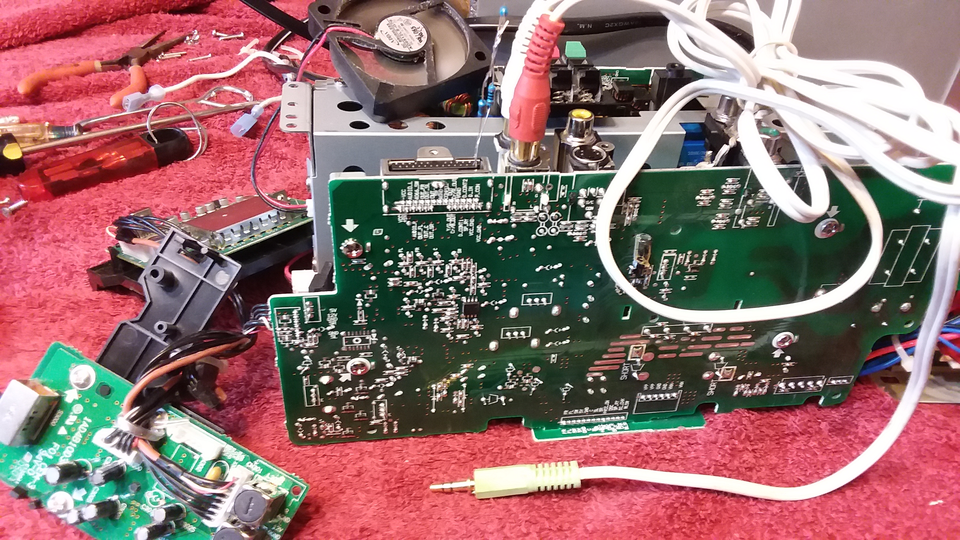

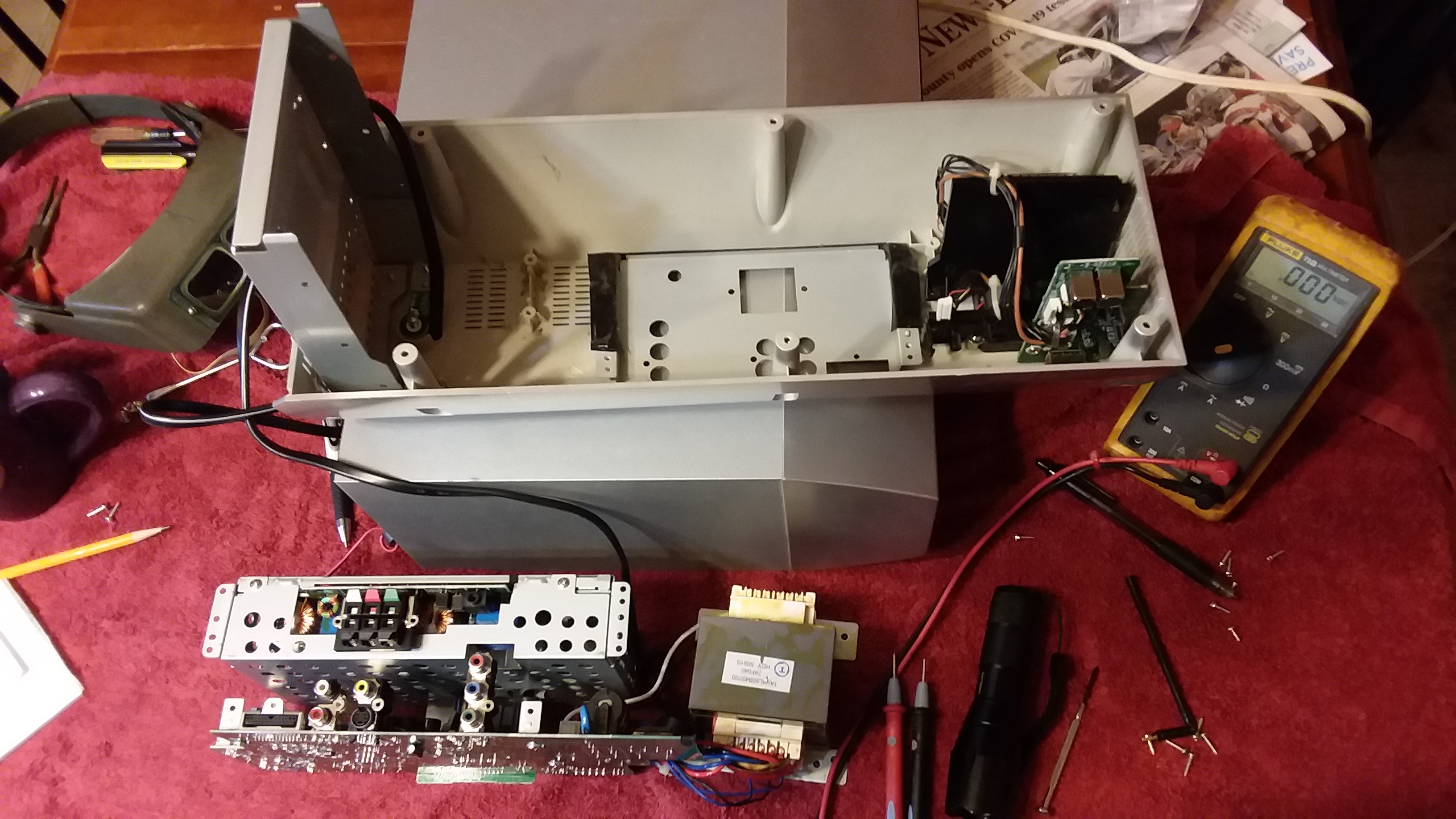

Hi all - I'll apologize ahead for being a newcomer. I have this "goodwill special" system that looks to be in good shape with the dvd player missing. Apparently this piece of the component system controls the on/off signal to the main amplifier built into the sub (I'll included a few pics). Of course it has a proprietary "system cable" that alot of manuf incorporate into their systems now. This plugs into the dvd player into the sub. I need to know if I can bypass the need for having the dvd player and remote allowing use of this sub and speakers as a standalone system connected to a receiver. The sub has an input L and R rca but this does not activate / turn on the sub. The sub is an active sub. I've taken it apart thinking I could get the datasheet on the IC amp chip but do not know how to read / understand the pinout. I'm good with solder and know basics for a mulimeter. I just need someone to locate the circuits / pins to bypass if any "standby" mode exists (see pics). I've performed a similiar fix on a sub for a bose 3-2-1 system (big dissapointment there:( ). It's rediculous what bose charges for their sub-par systems but thats just my opinion. That's another topic. I appreciate anyone giving me any advice on this. It has some pretty large drivers and the system has good reviews. Could this be as simple as a jumper at the system cable connector?? Thanks again.

Thanks again...your awesome for helping:cool: I deleted and re-uploaded the latest values in that last pic. Still have to get me that resitor but wanted to clarify everything first. I also included a GND pin i used to get those values at the bottom of that pic. This unit does have a transformer providing about 25vac,11vac, and 15vac on three legs. I apologize again for being a lamen with this stuff. I know enough to shock myself;(

Thats what i thought at first but wasnt getting any readings. I dont know which grounds i should be referencing? This is what im working with (wife frowns...)
