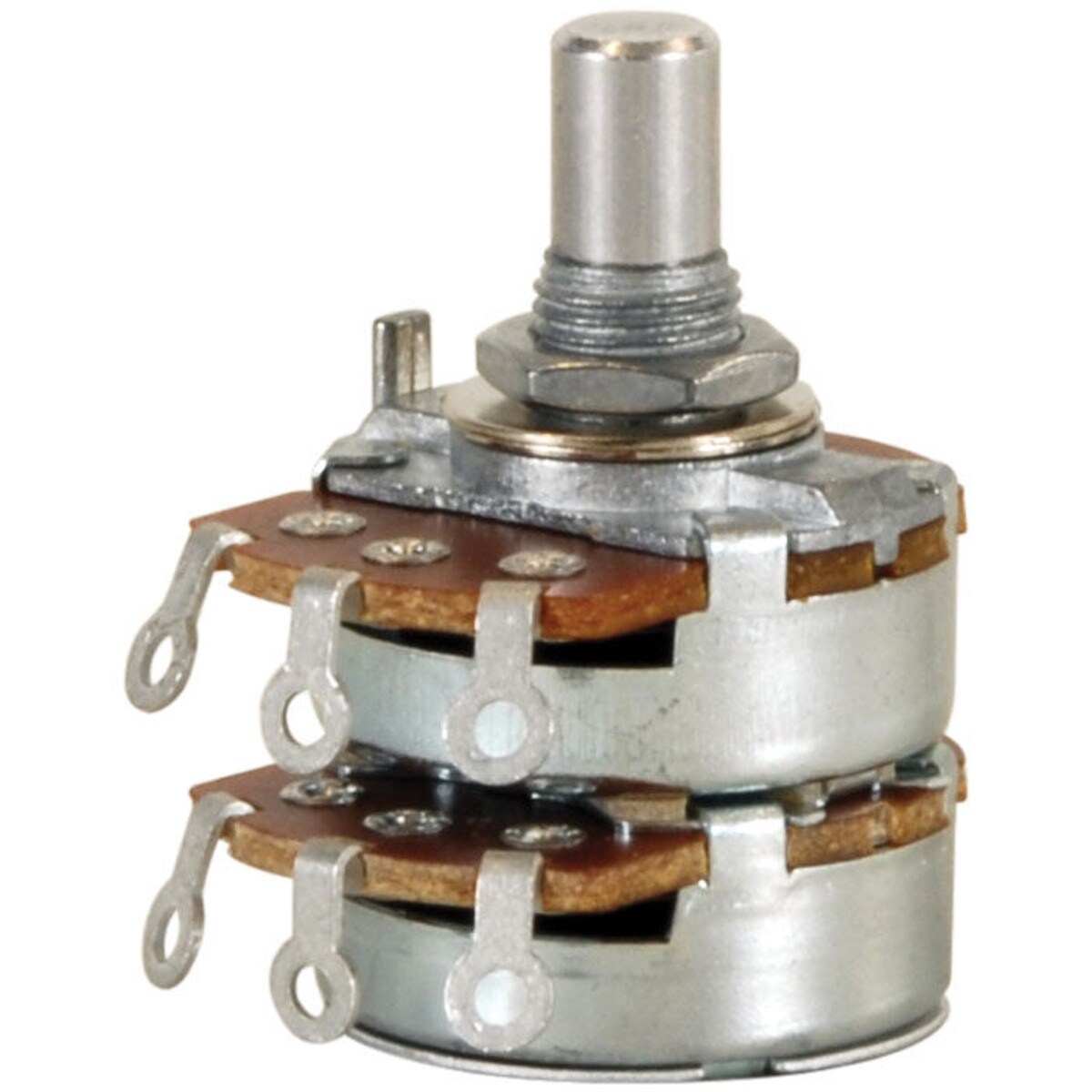

rjenkinsgb - could you keep it "layman" for me? What is "cw ends?" I've located those pins and can do the necessary splicing and jumping of wires but lost on jargon. Also....."wipers?" I can source a potentiometer.

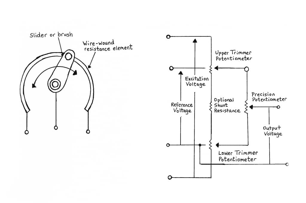

See this link, specifically the second (red & blue) sketch:
The wiper is the moving part of the pot, usually connected to the middle terminal.
Looking from the "user end" of the pot, the CW and CCW terminals are the ones the wiper is closest to when turned fully clockwise or anticlockwise.
Note that you need a dual-gang pot for the stereo volume control. I'd try a 10K "A" (log taper) one, eg.
