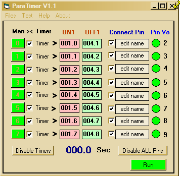

Eric, ParaTimer v2 could be the basis for what I need (updated 6 Sept 0500 GMT).
To make more suited:
1. definately add seconds and .1s ability e.g 00:00:00:00
2. My start time is unrelated to the time of day. For example, I will want to start Timer "0" at 00:00:00:00 so this would need a manual start button (which disables trigger by system clock)
3. add remote start ability - (if checked disables trigger by system clock)
4. remove Zone 2 and 3 tables as they are not required (optional)
5. enable renaming of 'Zone'
6. Reverse order of timers so 0 is at top, 7 at bottom
7. add 'save as' capability
Is all this possible?
As an interem measure I could live with adding seconds and the manual/remote start ability.

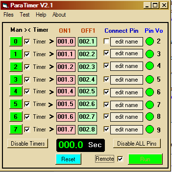

Hi Eric
Many thanks for the v2 modification. I have been putting it to the test and it's working very well and does the job needed. Good work Sir.
I like the way it continues to count between the ends and starts of successive periods as these 'gaps' can double for my wait states to allow the projector to switch modes. The projector quite happily switches with only .1s elapsed between the boxes (and I was allowing for 1s!).
The following are some minor issues remaining that you may like to consider for attention (I would appreciate very much);
1. The remote "run" connection is really needed - and I have a n.o. contact waiting to connect to it!
2. Rather than leaving the time counting up on the display, could the counter stop with the end of the sequence (i.e. at end of last selected timer)? Also, a "reset counter" button would enable 000.0 before re-starting.
3. Can you colour the counter numerals green with the black background as in ParaTimer 1.
4. Would you consider putting in a global reset button? Currently, if a sequence is abandoned after starting, there is no way to reload from the start. It seems to need to time right out before the file can be reset.
5. Selected checkmarks for 'connect-pin' are not being recalled between different saved files i.e they stay in the same boxes.
6. Can you add a 'Save' for when editing an existing file.
7. Can you add a 'Exit' only command i.e. no save before Exit.
8. If you provide 'Save', 'Save As' and 'Exit w/o Saving' options then the rather scary 'Exit and Save' can be removed.
Btw, the portdll.dll file was missing from your send pack. I borrowed one from V1!
Brian

Hi Eric
Ok now, all working. I didn't have it C:\Paratimer, but the previous versions which were working were in a folder far from c:!
Please confirm if dllport.dll should be in System or System32? (I've now put it in both)
Still some niggles though;
1. The output connect checkboxes are not saving/not being recalled. The same pins stay selected regardless of input file. All other parameters are being recalled ok.
2. The remote start is great. But can you change it so that when the remote relay/switch is opened, the counter stops at that time (as it does in button run), rather than resetting. In fact, could you make it that I had selectable option in another checkbox (Count stop/Count continue)? The logic here is that if one wasn't observing the timer, you'd know that it had actually done the routine.
Thanks for the minor cosmetic changes.
Brian

Yes Eric, Brian2 has solved the checklist recall problem. It's working good now.
It was very worthwhile incorporating the 1/10s capability. Several of my timings need s+msecs for best fit as the lens motor has good repeatability and returns to the same places each time. I have also saved a reversing routine to set the lens back at 'normal'. Curiously, the timings are slightly different and probably due to the way the gearing etc works. I have only needed to create two files to store all these settings: zoom.txt and reset.txt.
p.s. should the dllport be in System or System 32?
To ensure that all/other programs calling these dll's can find them OK, I put the dll's in both...
With regard to my request to allow the counter to continue running once the remotely-started period has ended: - don't worry, it's fine the way it is.
Instead, can we change the manual run so that when it has ended, the timer resets to zero in the same way (presently it runs on until STOP is pushed). This means that you would use the end of the last active timer as the cue to zero/reset the manual routine.
