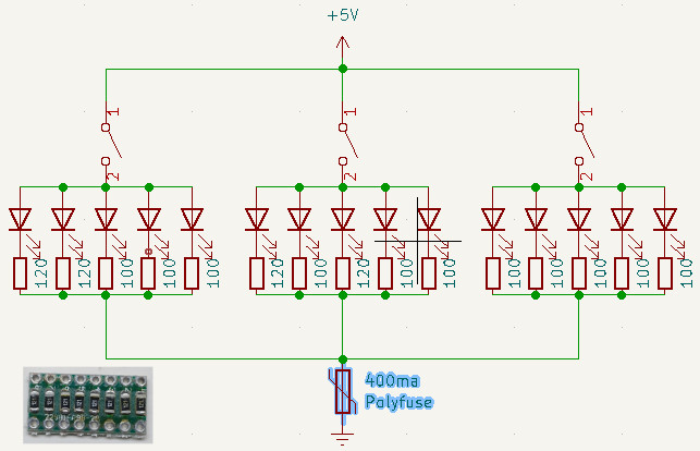

I would like to ask for a bit of advice on parallel LED strings.
For the past few years, I've made the following circuit for some lights I make as part of my hobby.
I power either from a 5v usb adapter or from a 1.5v battery to 5v dc-dc board.
The strings go into tubes, glass, frosted plastic shapes etc.
I use small transfer board pcbs to hand solder different value 1206 resistors and solder each LED separately using wire wrapping wire or enamel wire.
Theres a picture of the transfer board to the bottom left of the attached picture (it's one from the junk bin - an early attempt at soldering years ago)
I generally have 3 individually switched strings. Each LED has a matched resistor depending upon its forward voltage.
This has worked fine and I have a little jig that allows me to quickly hold the 1206 resistors to the board for hand soldering.
I realise however this could be a lot better, and I think very dependent upon input voltage.
I though it might be better to have a small constant current driver for each string ?
Is there a simple way to do this. I would like to keep the circuit as simple as possible.
Also I would like the possibility of adding a high frequency PWM stage to one of the strings at a later date.
Any help appreciated :)

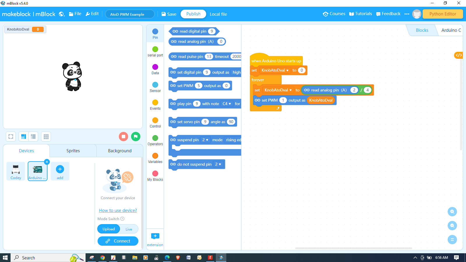

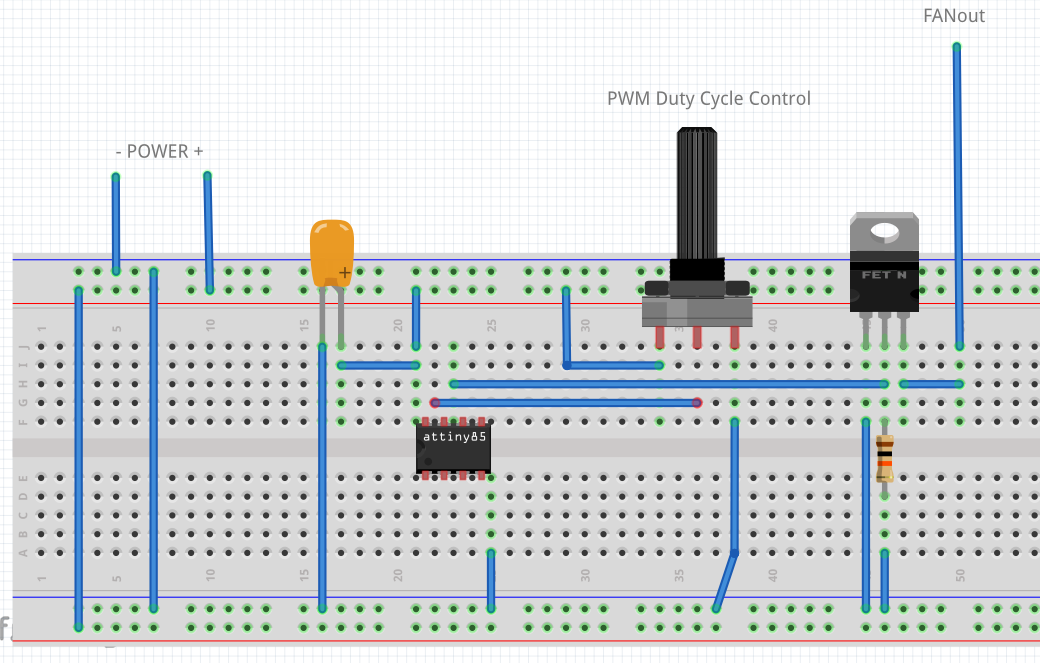

A real simple PWM can be done with ATTINY85 and a NPN transistor or N Channel MOSFET.
This was done with Arduino nano board ($3) to program the ATTINY85, and mBlock (free) used to develop code
for the program, real simple as you can see. The blocks in 3'rd window dragged out of second window, configed,
and then mBlock generates the Arduino code to put into the ATTINY85 via nano board.
Regards, Dana.

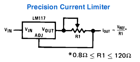

For your current circuit, about the only thing you can improve is to put pairs of the LEDs in series. This will improve significantly the efficiency of the circuit and extend battery life. As shown in the chart Dana posted, this will not work for all LED colors.
The LM317 constant current circuit works very well, but it requires a minimum voltage drop across it to work. This is true for all constant current circuits, but in your case a 5 V supply doesn't give you much voltage headroom to work with.

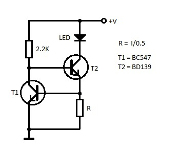

A solution is a classic 2-transistor constant-current circuit, something like this:
The headroom for this circuit is about as low as it can get, the Vbe of T1 plus the saturation voltage of T2. These add up to much less than the LM317 requirement.
Note that the 0.5 in the equation is correct. We are taught that the forward voltage (Vf) for transistors and diodes is 0.6 V to 0.7 V, but that is more the max Vf than the minimum Vf at which conduction begins. Conduction starts at a lower voltage. T1 starts conducting enough to draw base current away from T2 at a Vbe as low as 0.4 V in some small signal transistors.
If you are individually selecting each LED R to match brightness thats not a bad method
to match brightness. Does not handle T and V changes, LED toi LED non linearity, but still
not bad. But tedious needless to say, picking all those R's.
Driving a series string with constant current is preferred method. Closer matching. But disadvantage
one bad LED takes out whole string, whereas parallel method can, for some cases, keep the rest of
the LEDs active. Depends on failure mode and impact on its series R.....
Your call.
Regards, Dana.
