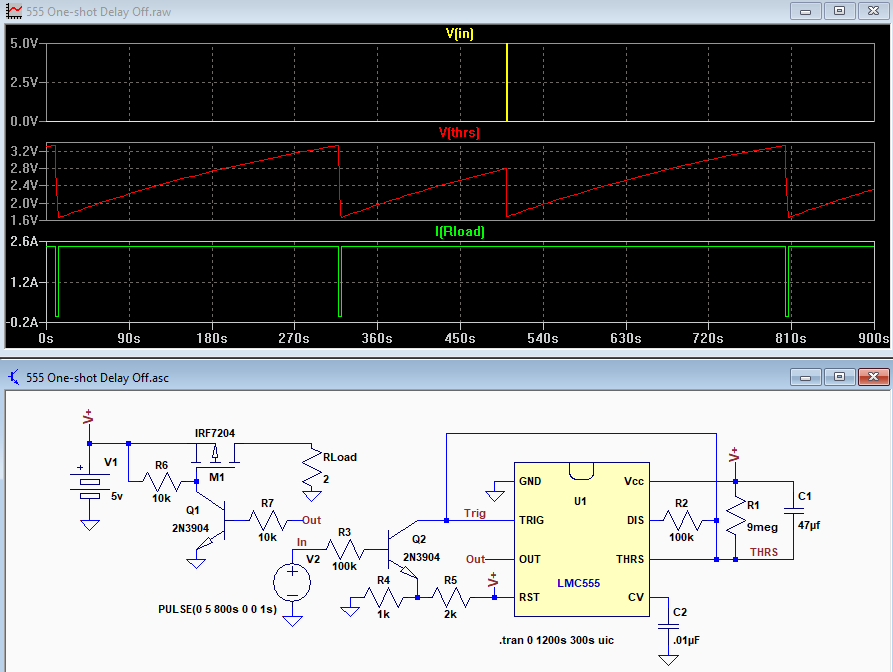

5 minutes is a little long for a 555 time, but I think it will work if you use a low-power LMC555 CMOS timer along with a ceramic capacitor, both of which minimize leakage that would affect the timing.
Below is the LTspice simulation of the circuit:
The timing capacitor C1 is a ceramic type such as this.
Note that the output pulse interval (green trace) is extended by 300s when the reset input (yellow trace) momentarily goes high and resets the timing capacitor voltage (red trace)..
The 555 output is driving a P-MOSFET to switch the load voltage.
You may have to tinker with the value of R1 to get the desired interval time.

That's awesome, exactly what I needed. I will order some DigiKey parts today and I will try this circuit soon. I'll keep you posted! One last question, will this timer loop? Which means after the power reset, the timer will start its timer function all over again, correct? How can I thank you? I really appreciate it. This circuit is exactly what I need to build.
As for going into the microcontroller and changing lines of code, I've never gone that far, so I feel uncomfortable getting involved on the programming part. But I would like to thank all of you for the other replies. Mike
Correct.
I didn't show more than one cycle, but the timer is an astable multivibator and will continute to cycle indefinitely.

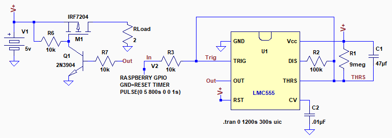

I have a question: If I use a Raspberry PI (microcontroller) to send a low (GND) signal to reset the timer (instead of a 5V signal), can I eliminate Q2 R4 and R5 all together? I modified the schematic to demonstrate what I mean. It's not a big deal, but I thought this could end up using less components...!
I have a question: If I use a Raspberry PI (microcontroller) to send a low (GND) signal to reset the timer (instead of a 5V signal), can I eliminate Q2 R4 and R5 all together? I modified the schematic to demonstrate what I mean. It's not a big deal, but I thought this could end up using less components...!View attachment 116409
Think bigger. Using a Raspberry Pi could eliminate the 555 timer itself. It would be little different from what I suggested when I suggested using a PICAXE.
Program the raspberry Pi to drive OUT to be high for 2 seconds every 5 minutes. You would only need M1, Q1, R6, and R7.
I understand, but I'm trying to use this circuit separate from the micro controller itself. The only interaction between this circuit and the micro controller would be to reset the timer countdown. So the question was, considering I can have the micro controller output low or high to reset the timer, which is the best design.
I know I can eliminate every component using a micro controller, and logically this would be the best choice. But for this project, the micro controller may or may not be present, so I rather use a simple circuit, like the one in reference. I have most components in hand for this circuit so it's a situation where it's just better for my case. But I appreciate the suggestion!
No.
The reset point has to be a very high (open-circuit) impedance when not being reset, which is provided by the collector of the transistor.
You show a 10k impedance, which will cause the 555 to stop working.
It could work if you can set the output of the Pi into a high impedance state when the reset signal is not present, and if it can tolerate 5V.

I have received my Digikey order and I assembled the circuit, it works as expected. The only difference is R1 was originally 9mega ohms, I had to use 14mega ohms instead, to adjust the on-time. The C1 capacitor used is the exact one recommended.
ON-TIME: 5:10s (average / +-10s)
OFF-TIME: 0:02s
I added an LED with resistor between 555-OUT and V+, so when the mosfet is off, I have an indicator.
The circuit works perfectly. Thanks again for all who helped and suggested a solution!
