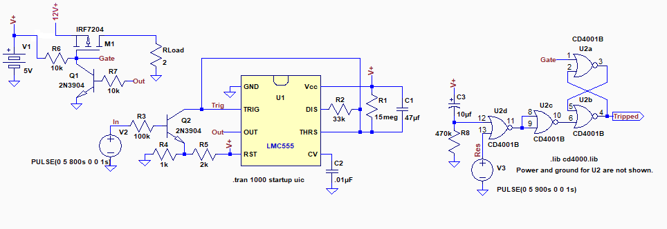

Timer - 5 min on, 2 sec off
I want to know when it happens! My idea was to use another 555 timer that will trigger in bistable mode when the mosfet resets (powers off).
You can use another 555 for that, or simpler is a two NAND gate (1 package) set-reset latch circuit.
I tried and succeeded to some extent, I tried to copy samples from the internet but couldn’t understand why sometimes it falsely triggers when I first power on the circuit. Remember I’m not an engineer, so I get lost easily.
I don’t want to feel like I’m taking advantage, so if you don’t mind, I want to pay you for your time, in exchange for your help. If the NAND chip is a better choice I’m good with that. I just need a schematic so I can put it together! Please let me know what you think.
You don't have to try to contact me, and I don't do this for pay -- it's my hobby. :)
I prefer answering all questions on the forum so everyone can benefit from the answers.

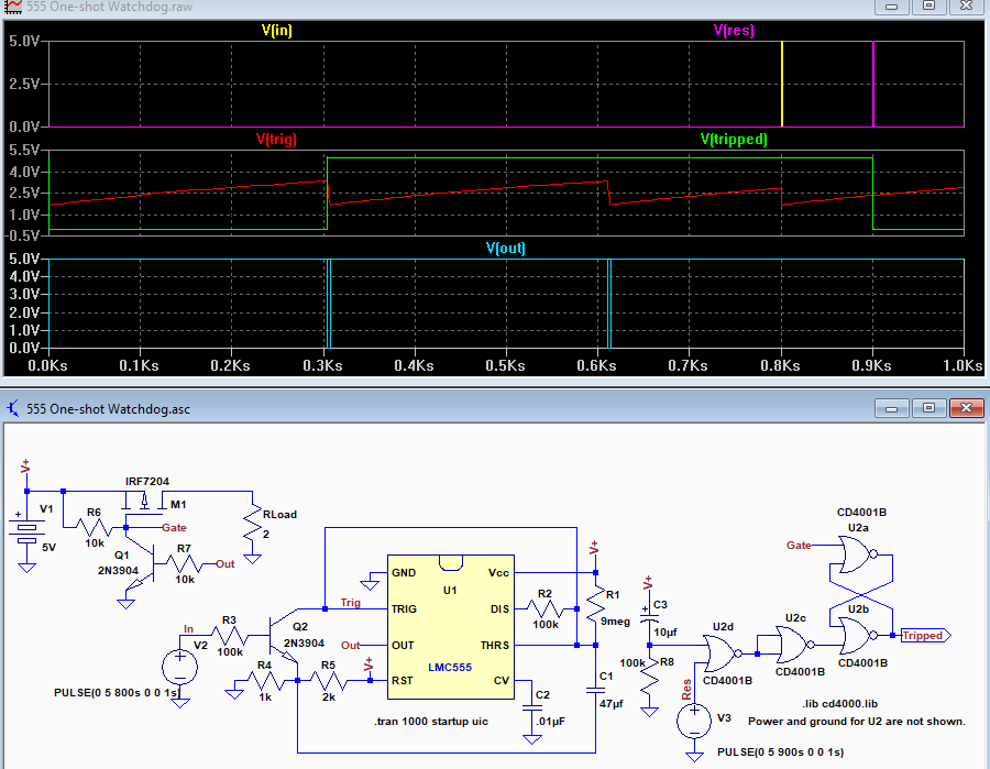

Below is the circuit with an added NOR-gate latch to indicate that the power has been reset (green trace).
V3 resets the latch (purple trace).
(A NOR-gate latch turned out to be simpler than a NAND-gate latch for the given signal polarities.)
R8 C3 act as a power-on reset for the latch.
I was watching some videos (trying to learn all I could about NAND NOR etc...), now looking at your new schematic it begins to make sense! Well if you cannot accept not even donations, then I can only use my words: THANK YOU!! I will put the circuit together tonight, and will follow up with results.

Ok, I'm back to report the outcome: PERFECT! Couldn't be any better! That's all, now it's complete! Thank you Crutschow :)

Hello guys, I have a quick question. I wanted to use this same circuit on another device, but the new device runs on 12VDC, not 5VDC as before.

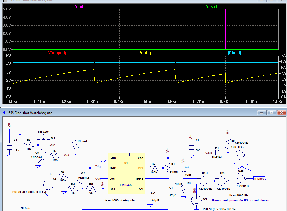

Before asking questions here, I was looking for a solution, so I installed a 5 volt regulator on the main power supply, thinking there would be no big changes to be made. Well the timer works great (always has). Then I modified the MOSFET wiring and connected with the main power supply, ...and now the MOSFET won't turn off. Obviously I'm doing something wrong, and it's not as simple as I though it would be. I believe the voltage on the base is wrong (in reference to the source). I tried another MOSFET with higher values (one that can handle more voltage and more current) but it acted the same way. How can I correct that, can someone please tell me what's missing?
(The schematic attached shows the MOSFET connection with the new power supply)

Yes, that won't work.
The MOSFET Gate signal has be raised to its source voltage to turn off (12Vto give Vgs=0), and you have it going to only 5V, which keeps the MOSFET on.

I did connect everything on 12V and then it works fine, but I have things on this circuit that connects to the microcontroller, and all these things run on 5V, so I think it's easier to modify the gate signal to the mosfet, so it understands and works normally. Or, use a signal translator (level shifter) for all the microcontroller interaction with the timer. There are a few things in 5V, like the timer reset (555), or the event trigger and the event reset (4001), I also have a low vcc chip (I never mentioned this, but I installed to watch if the power supply goes low voltage at any time) and this also connects to the microcontroller vcc (which is 5V)...... so I'm not sure if my thought is pointing the right direction, but I believe using transistors I could boost the mosfet signal, correct? What I couldn't make much sense is the mosfet has to receive 0V (gnd) on its gate to work, and I thought that's what Q1 was doing. Please let me know how you thing I should apply the fix. Thanks my friend.
The P-MOSFET gate does need ground to turn on, but it needs to be at the 12V source voltage to turn off (Vgs=0v).
Below is the circuit modified for 12V on the load MOSFET and 5V for the rest of the circuit.
Since the CD4001 inputs can't tolerate more than its 5V supply voltage, isolation from the 12V Gate signal is provided by diode D1 and resistor R9 pullup at U2a's input ,
Wow, you're incredible. It's a shame you don't let me pay you...! Thank you so much once again.
I will build the circuit now, I'll report back if there's any problems (shouldn't have any).
