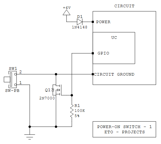

Everyone thinks of switching power to a circuit by switching the power. However, in a battery-powered system there is no law against switching the GND. Here is a first pass at this technique.
When the power loop is completed by SW1, the first thing the uC does is assert the GPIO pin high to keep it's power connected through Q1. Driving the GPIO pin low turns off the circuit. When the circuit is off, R1 bypasses any leakage current from the GPIO pin to keep Q1 off.
NOTE: This circuit is critically dependent on the GPIO pins being "well-behaved" at power-on and power-off. If they bounce around, modifications will be needed.
I don't get that idea?
Any normal GPIO pin will be restricted from going outside the MCU power supply rails - above positive or below ground.
How can the MCU switch off - so both supply pins at or near V+, without the GPIO pin also going positive to ground and switching on the FET?
I think it would need a P channel FET within the "box" to allow the power switch to turn off.

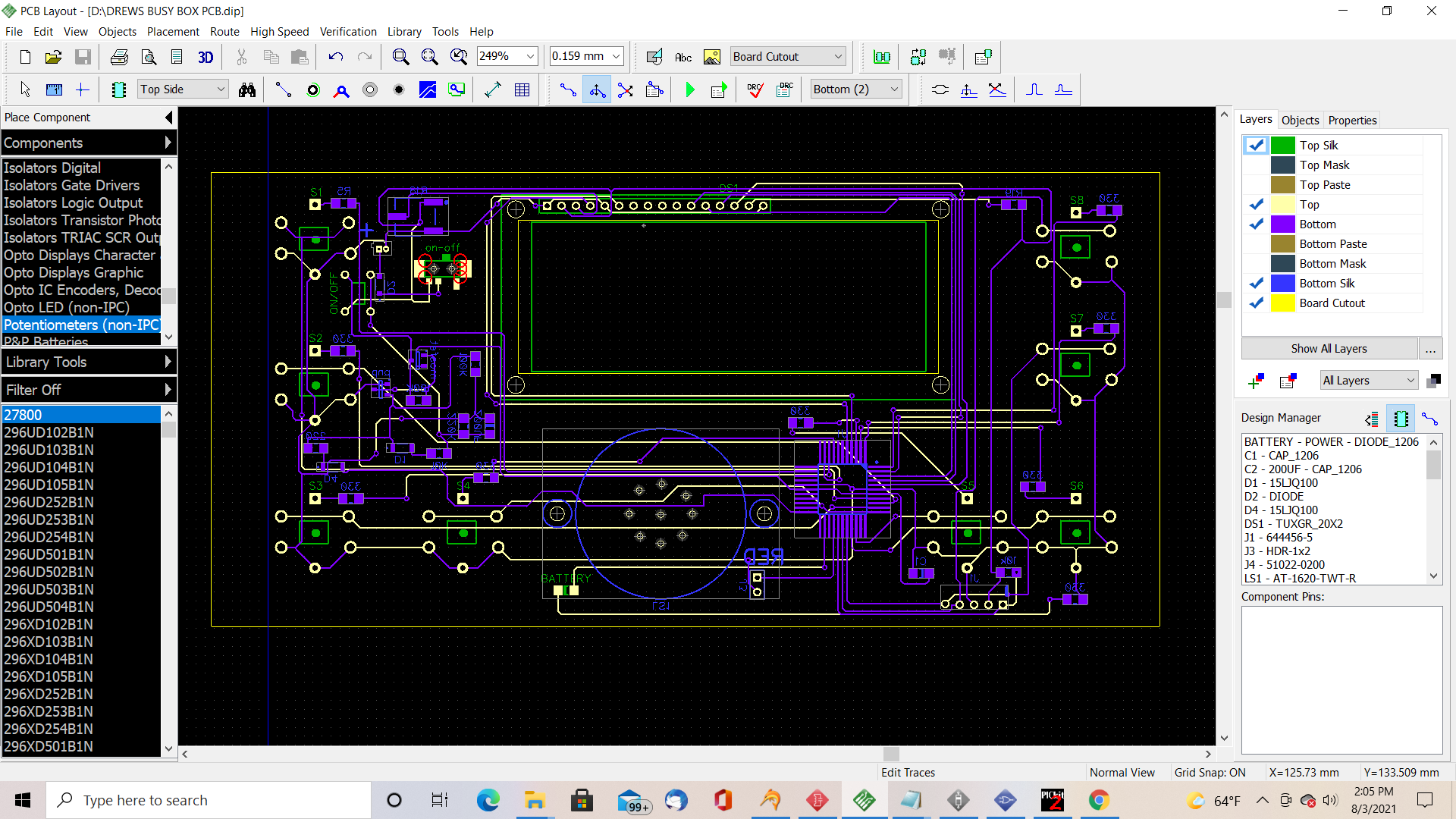

well I think I can order boards? here is a screen shot of board
the red errors have been corrected.
need to order boards from JLPCB TODAY

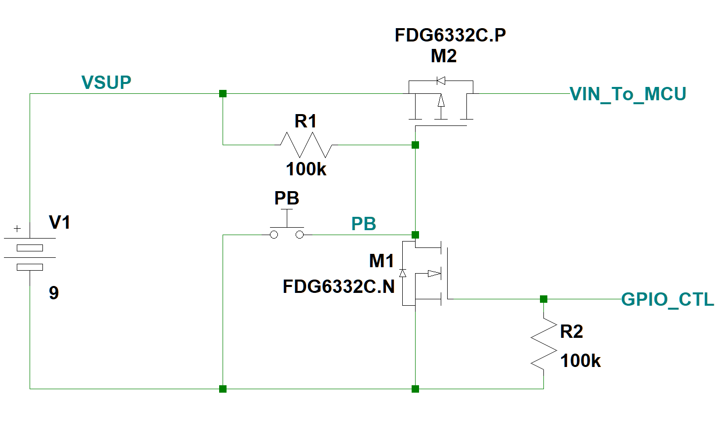

Seem like the latch circuit is post #12 could be reduced. See below.
FDG6332C is a dual complimentary mosfet.

I use them (dual FET's) a lot, for switching main power to SIM800's etc. - it still has the same drawback as the previous FET example, that there's no connection from switch to micro, so no way to use the switch for anything else (such as turning it OFF), so again it really needs the parts to do that adding.

The OP requested:
"instead of a simple ON/OFF switch am looking for a method to press a button and game stays ON until there is no activity of playing. "
Didn't request "anything else".
Why can't the GPIO turn it off with an internal software "inactivity timer"?

It can, and it does - that's the point of it.
BUT - it makes a lot more sense if you can turn it off manually as well - and it makes even more sense to use the same push button to do so.
As for 'not requesting it' it's the sort of thing he's probably going to request a few more pages down!. The original bi-polar version can easily be stripped back to make it simpler as well, with the same failings.

Well....its not a "failing". It simple, it works and does exactly what the OP wants.

If you transfer your design to EasyEDA and select SMD components and the speaker as GSPK2307P-8R1W then JLCPCB will assemble everything except the LCD.
We tried that once before, with exactly the expected amount of success.
