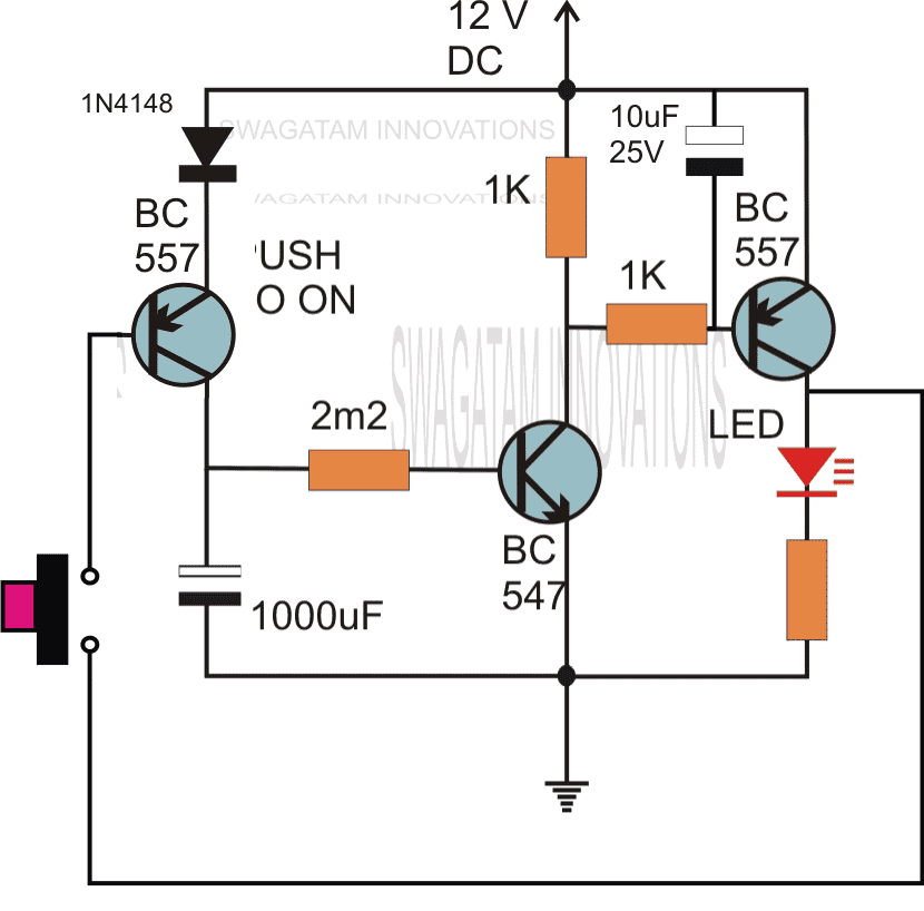

Am working on a game for my new grandson (15 months old) and instead of a simple ON/OFF switch am looking for a method to press a button and game stays ON until there is no activity of playing.
Circuit has a microcontroller and 9 tactile switches.
Eight of the tactile switches have an LED so power consumption is very low.
Game will play selected melodies displayed on LCD display.
So far found attached circuit.
I was thinking maybe an SCR would require less power consumption?

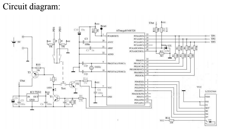

You've got a micro-controller, use that - you can set the timing to anything you want, and manually switch it if need be. The AVR component tester is a good example, T1, T2 and T3 are the relevant parts of the circuit for the on/off (you don't need LED1 if you don't want it - replace it with a 3.3K resistor). A few minor software changes are all you need. I've used on numerous commercial projects, and implemented auto-power off under various circumstances.

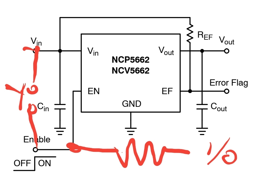

If you use a voltage regulator with an ON/OFF control you can usually arrange that to work with
a momentary pushbutton, 2 resistors, and an IO pin.
The pushbutton turns on the regulator, the uC runs and sets IO pin to keep it on until you want to turn it off.
What regulator are you using now?

If you study it, it's very simple - and remarkably clever - which is why I stole the idea :D
When you press 'test' (or on/off in my case) it switches T3 ON (via R7), this powers up the micro which immediately sets R8 high turning on T1 - this locks T3 ON as well. After the required 'in-activity time' R8 is simply switched low by the micro, and that shuts all power down - there's no resistor across the supply, so zero consumption when switched OFF. T2 is there so you can detect the button has been pressed again, so you can manually turn it OFF, and simply pulls an I/O pin low.

Nice simple idea, and works wonderfully. One of the devices we manufacture uses an external plug-in transducer (basically a 24V solenoid), and is switched ON and OFF via the circuit above, as it uses internal Li-Ion batteries I also have voltage and current sensing (using an I2C chip) in order to monitor charging, discharging, and to give a battery indication (via a flashing LED).
I was lying in bed one night when I had a 'brain wave' (as you do :D) As battery current is already monitored you could easily tell if the transducer has been unplugged, simply by the current falling below a certain level - this would also prevent it getting accidentally turned ON, and flattening the batteries.
Next day at work, a few minutes with XC8, and it now switches OFF if the transducer is unplugged after 30 seconds - it took almost no effort to add, as all the required routines were already in place, and just needed linking together.

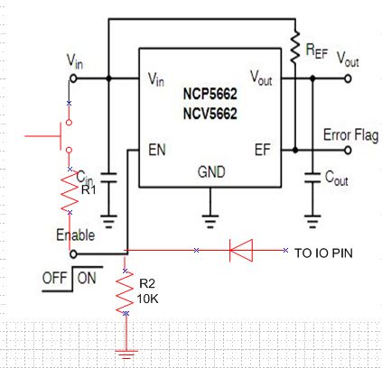

I was thinking about something more like this (depending on the input voltage)
The R1/R2 voltage divider should have R1 adjusted so the EN voltage is about 2V.
The 10K pulldown will keep the reg off if EN isn't driven.
The diode will keep the input voltage from backfeeding thru the IO pin protection diodes.
I am thinking that maybe a timed delay using an rc network should be included with the switch so micro has time to turn on completely?
Don't bother... the micro should startup pretty quick. Try it and see.

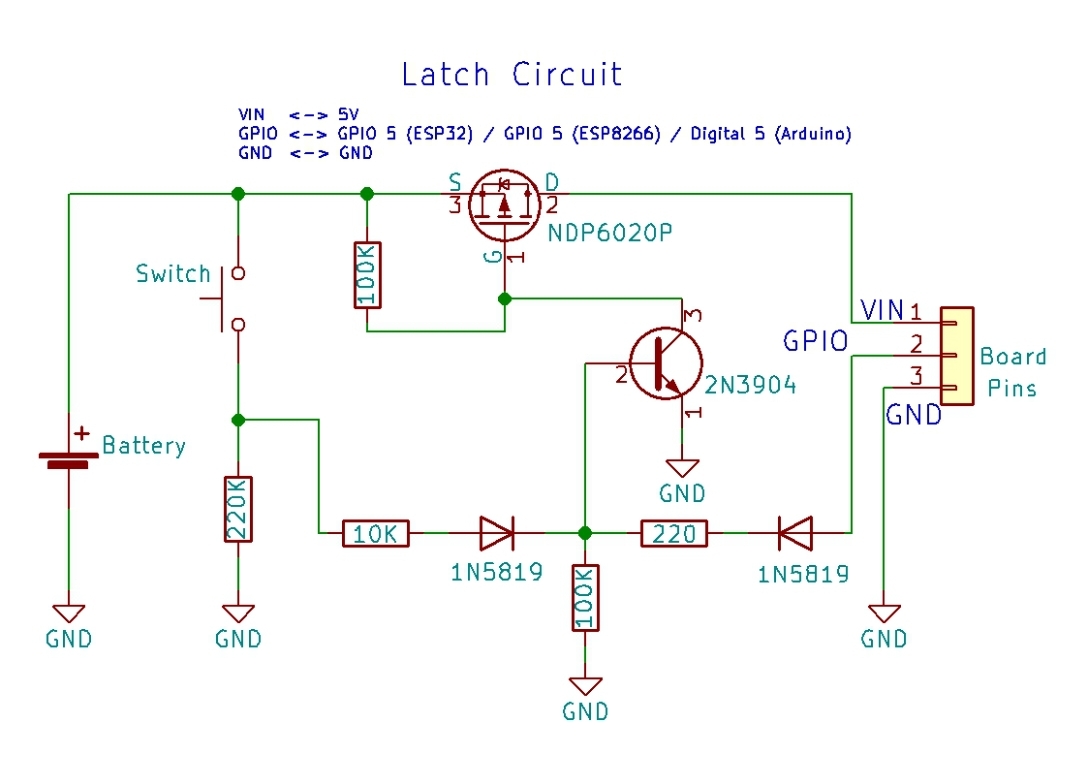

Here's a variation on Nigel's ircuit that might be a little simpler and has a good explanation of how it operates and use.
That's essentially just replacing the PNP with an FET, and removing the input to the micro - which I've always found very useful, and could of course easily be added to the FET circuit.
But for the simplest approach, if you're using a voltage regulator, I think Tumbleweed wins!
Probably OK for this application, but that approach wastes too much power when turned OFF for long term battery life (it's no where near as low as you might think) - the discrete one is essentially zero when off, either bipolar or this FET version.
