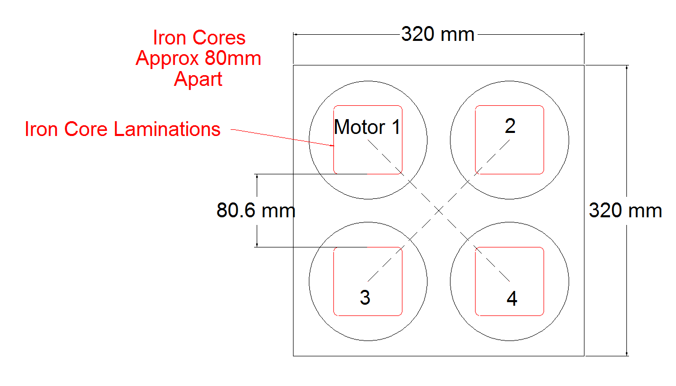

Ok, i'll try to spit this out so you have a chance of understanding it.
I read in the application note attached that a 400uS pulse is good up until 7deg Current Lag which was suitable for the single vacuum motor test they conducted, which made me immediately think that I have 4 motors connected in parallel.
Do Ac motors follow the Inductance formula's when connected in Parallel?
If so the Inductance of the 4 motors will be less so I should be fine---BUT.
In saying that I also don't know if an Inductive Load has more Current Lag if it has more Inductance more Inductive Reactance or a combination of those or more variables?
To further that I have my Motors mounted in close proximity to each other for a Technical reason that I won't go into here which made me think that Inductors in close proximity to each other can have Mutual Inductance issues & with the Iron Cores - Laminations of the motors being close together may have a Magnetic Coupling issue as well all of which will or may have an affect on the total Inductance & also the total current lag of the system.
I have attached a quick drawing (TOP VIEW) of how the motors are mounted & there proximity to each other for reference.
As mentioned I may be concerned about nothing but on the other hand all the variables need to be thought out first to make the Control System operated effectively.
The trouble being I can think of apparent issues but don't know the damn answers to my own questions?
What do you think?
Cheers

I'll sleep on it. The 7 comes from 50*2*3.14159*0.0004 * (180/3.14159) which is 7.2.
Inductors in parallel follow the same rule as resistances in parallel, so the inductance would be a factor of 4 lower.

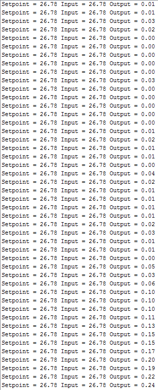

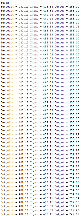

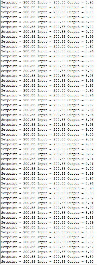

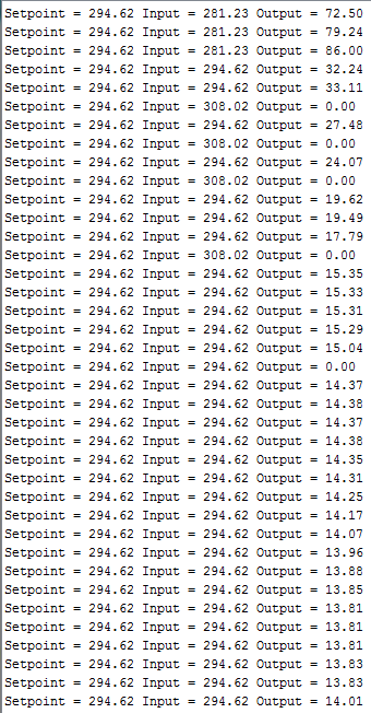

I have spent a bit of time changing the PID Sketch, I mentioned before that the Lamp was Flickering to keep the set point Temperature which I didn't like, the power to the lamp was basically ON-OFF making it flicker & wasn't a smooth dimming effect.
Anyway I have changed things & now it is nice & smooth & I can control the Lamp from around 26 deg C to around 495 deg C.
There is still more adjusting & tuning to do, I realise that but I will attach some screen shots from the serial readout.
In these shots you will see more tuning needs to be done on the step tests as it takes to long to settle but I think the shots will show that the PID is starting to work OK.
This is really interesting stuff.
With a few more changes & some tuning I think I may be able to get this which just makes my day!
The serial readout is now in degrees C & also shows the output to the Lamp 0 being off & 255 full power output.
The readings are 1 second apart.
Getting there slowly.
Cheers

Nice!
How are you doing in terms of % full scale of the inputs or is the thermometer doing quantization errors on you?
e.g. Are you operating at the bottom end of the A/D?
Is the thermometer responsible for the xx.62 degrees?

Yes, it was a novice error on my part.
I was multiplying things by odd steps resulting in fractional results, all fixed now & I did a little more tuning.
See results attached.

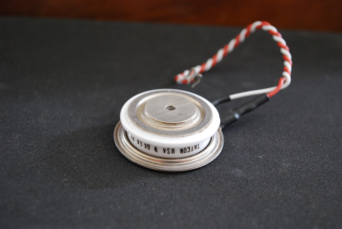

Off the subject for a moment.
When I ventured to town last time there was a huge Power Factor Control cabinet at the scrap yard that was removed in working order from a closed down factory, just another import tragedy.
They didn't want to dismantle the cabinet due to it having 12 large cylinders mounted inside containing 3 big capacitors in each, total 36 capacitors.
There were 18 THYCON SCR's & all the control circuits, heat sinks, huge chokes etc inside it as well.
I told the owner that I would discharge the capacitors for him if I could have the SCR's, Circuit boards, Capacitors & the heat sinks & he said they only throw away all those things except for the heat sinks being Aluminium anyway so go for it.
So, I have all the components now.
I have attached a picture of one of the Hockey Puk or Disc SCR's, I have been trying to find a datasheet on these with no luck.
They are marked ( THYCON USA 6K14 P0 95 39 )
I bought the huge cabinet as well for $20, makes a good lockable tool cabinet.
The circuit boards are full of goodies as well including Pulse Trigger Tansformers, etc.
Any help with a datasheet would be appreciated.
Cheers

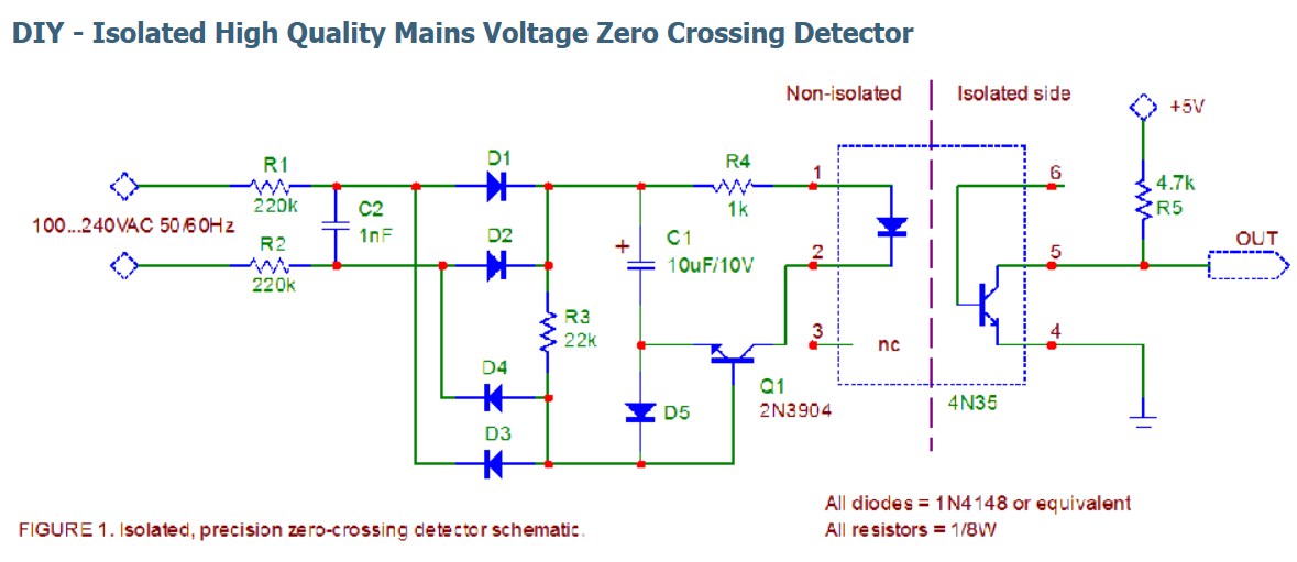

I finally found this **broken link removed** circuit, which is free for use that appears simple enough.
I simulated the Zero Cross Circuit to see how it looked in LTspice & have a couple of questions regarding some things I have wanted to know for a while, pretty basic stuff I suppose, if you know that is.
I noticed on the schematic (Attached) that they say C1 can be a 10V capacitor?
Also that C2 doesn't specify what Voltage rating it has to be which led me to simulate it in the first place to have a look.
In the simulation C1 has around 118V RMS on the Positive side & the Negative side.
So my question is that even though the Capacitor is rated at 10V it will still take a higher Voltage if the DIFFERENTIAL across the capacitor is say 10V or less.
Is this correct?
C2 has around 120V RMS on the AC hot side & around 115V on the ground side obviously a differential of around 5V, so a normal 1nF 100V cap will easily do it?
Now Q1 the 2N3904, I don't really understand, it has approx 118V on the Emitter, Base & Collector.
How high a voltage can you put on a small transistor like the 2N3904 or does the same thing apply, is it the differential voltage limits like from the Datasheets & not the applied voltage?
All this is taking into account that the simulation is correct which I think it would be.
Cheers
That makes NO sense.
Applied voltage is always differential. A datasheet might specify V thing like Vce or the max voltage from the collector to the emitter not some other point,
C2 should be ceramic. In fact an, X or Y cap, I forget which is which. In any event, this https://www.digikey.com/product-detail/en/VY2102M29Y5US63V7/BC2354-ND/1983393 is suitable.
There are capacitors with X and Y ratings. One is for across the line applications and one is line to ground applications. I for get which is which, They also have numbers after then like X1Y2 and again, I'd have to research their meanings. The point is, these capacitors are designed to "fail safe" when compromised. See the datasheet/brochure: Here https://www.vishay.com/docs/49572/49572_pt9159.pdf is the brochure. Note: across the line applications and line bypass.
In this particular circuit R1 and R2 do offer a lot of protection and it's less important.
Probably strictly not required, but metal oxide resistors would probably be a good choice on the line side. They basically fail open which is a good thing. Carbon composition basically get higher in value and metal film resistors puddle. I worked on a power amp which a few resistors were puddled on the circuit board. In a slow start circuit I designed (audio amp) uses a metal oxide resistor in series with the line. I left out secondary protection. It's the turn-on fuse, but it also limits the charging current on 40,000 uf of capacitance. I made a crude comparator using series connected optoisolators that shorts out the resistor when the caps have charged to > 2/3 of the max voltage, During the charging time, the speakers are disconnected and so is the audio. When the resistor shorts out, the audio "ramps" up. Turn off is also quick, the audio inputs get disconnected first (the opto is faster) and then the speakers via a relay. That little resistor saved my butt. I accidentally reversed the NPN and PNP transistors in the output and the ONLY problem was that metal oxide resistor.
