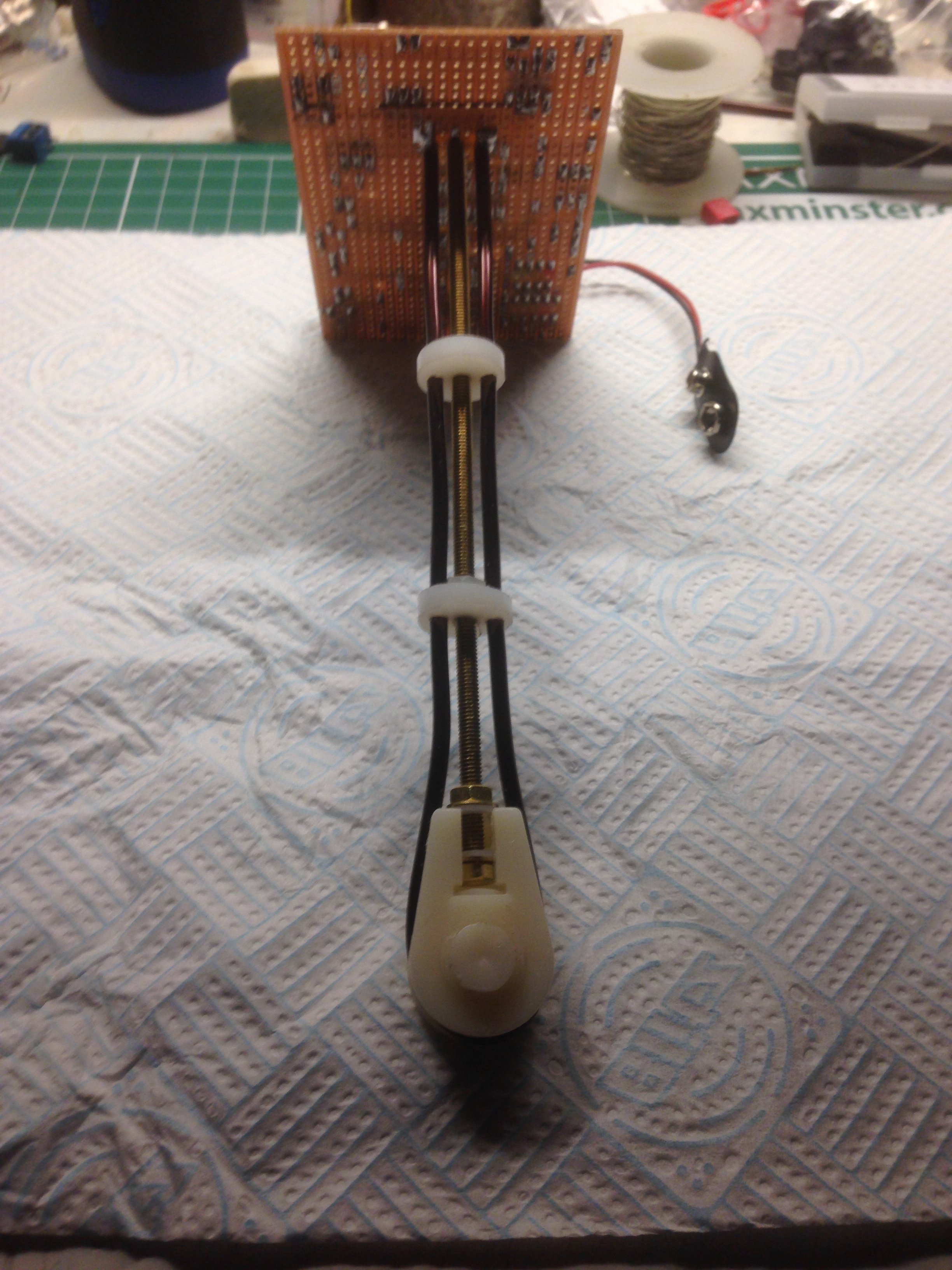

A very different concept .. .. .. a capacitive probe .. ..
This is a small prototype I built to test the theory, but I did eventually build a 40 cm long probe which currently displays the water level of a 50 litre water butt on a analog moving coil meter.
The probe is made up of an enamelled wire loop supported by a threaded brass rod. The enamelled wire and the brass rod produce a variation in capacitance according to the water level which, with the aid of a voltage follower is displayed on the moving coil meter.
The main advantage is that because there is no direct contact with any voltage and the water there is no electrolysis.
Although it looks fairly primitive, as anything I build would have to be, it is surprisingly stable and accurate.

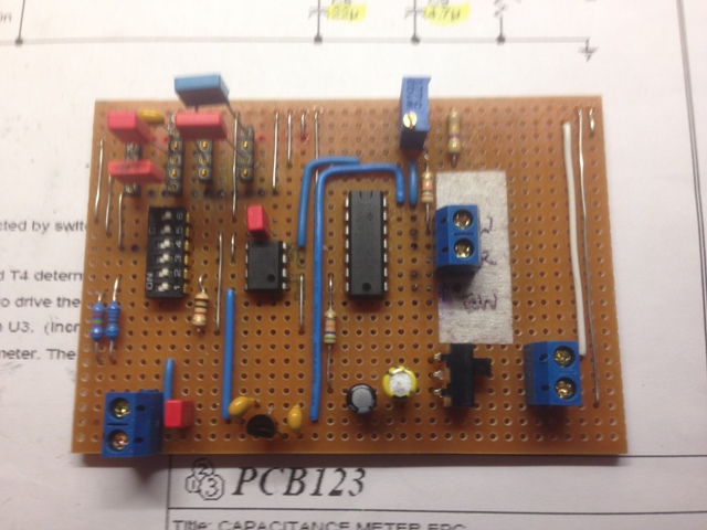

This is the circuit board.
The scale of measurement is varied by the combination of capacitors viewed in the top left hand corner of the PCB.
I have to say, the design is not mine .. .. .. I do have a schematic, but I will seek the permission of the author before publishing it.

I am curious to see the schematic.
What output signal do you get (min, max, dc?) for given water levels (empty, full, in between)?

I'm not sure I can remember exactly what the output signal was, looking at my notes, I've written down 1.1 - 1.7 vdc, but ... memory is not what it used to be.

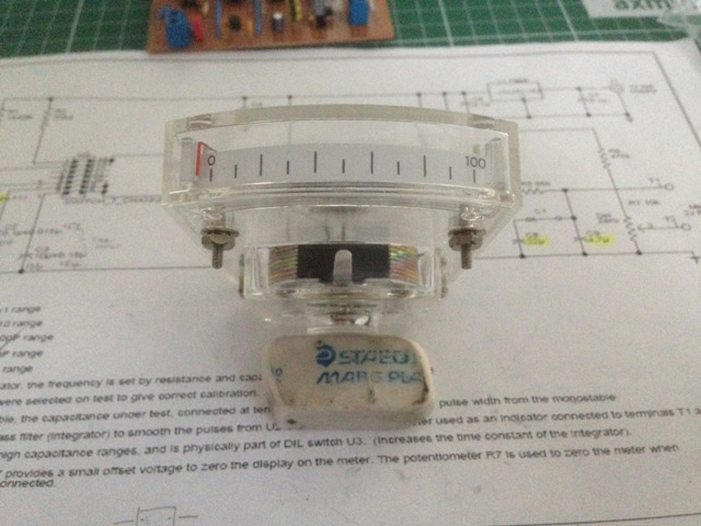

I actually displayed the results on this ..
So it won't have been much.

Interesting schematic: duty cycle changes in function of capacitance.. I already have a microcontroller program that is able to measure duty cycle width (using direct register addressing, very fast), however this will require some extensive testing and prototyping. Good for next winter.
