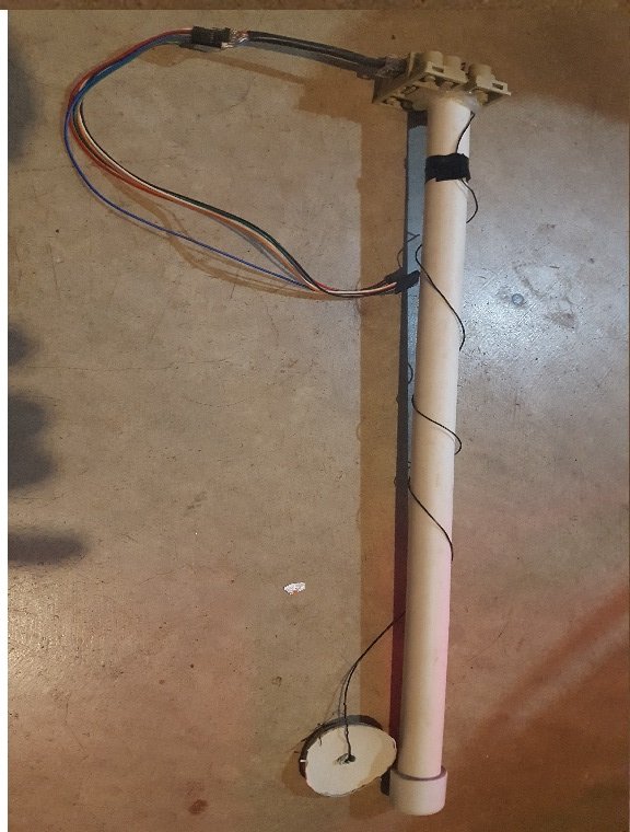

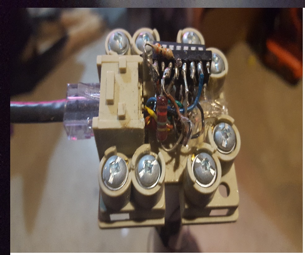

If I understand you well, you had the foil in the pipe isolated from the water and the piece of wire exposed to the water? At what frequency and voltage did you run the sensor?
yes exactly , 5v i forget frequency exactly ... id have to dig up code if ur interested
... ohya, i put one side of the cap to the analog pin, and the other side on a digital output pin ....
so when the analoug hit a thresh hold it would switch the digital pin polarity , and read the time delay on both slopes

Alot of pics come with a cap touch sensor built into the chip, i use them for water level detection in humidity chambers. Microchip designed them for reading contactless touch switches, they are basically an accurate current source that charges a known capacitor in the chip. The 18F chips with them in have a fair amount of settings to tweak them, they are ideal for water sensors and hardly any hard where needed.
The humidity chamber i use, or more accurately environment chambers use ultrasonic misting to increase humidity. These devices are like the things you buy for lizards etc, they have one big problem in so much as they need an accurate water level to work properly, you get around 25mm in level difference before they stop making a dry water mist. I turn the container with the water in into a capacitor, just foil on the outside really. Works well with the sap touch pics.
Sort of related. Several years ago I made a automated water filling system for a Christmas tree stand. Mine used three 316 stainless steel TIG filler rods. To prevent corrosion the electrode assembly was driven with an AC signal. The two level signals were rectified and fed to a microcontroller's inputs. The output was used to drive an SSR that controlled a small fountain pump. DC electrodes result in electrolytic corrosion. I only use it for a month and a half each year with tap water, but see no change in the electrodes' surface. If I ever saw any I would just change the wires. It serves the same function as your pool system.
