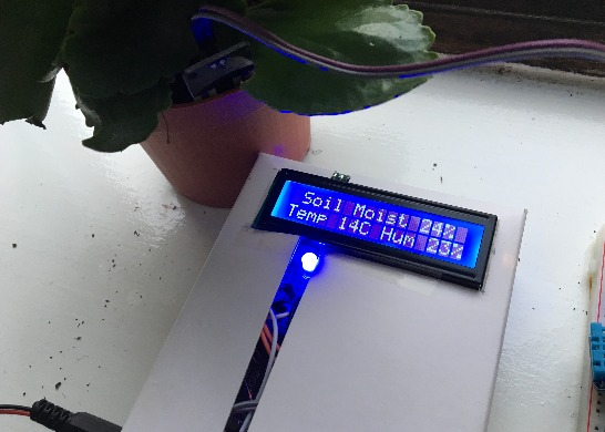

I think the most convenient option is to use a water level sensor or a soil moisture sensor(anti corrosive), An Arduino and a DC 6V Micro Pump Motor for watering. You can use a 1-channel 6V relay between the motor and the Arduino. Here is a similar project that you may like to see:
