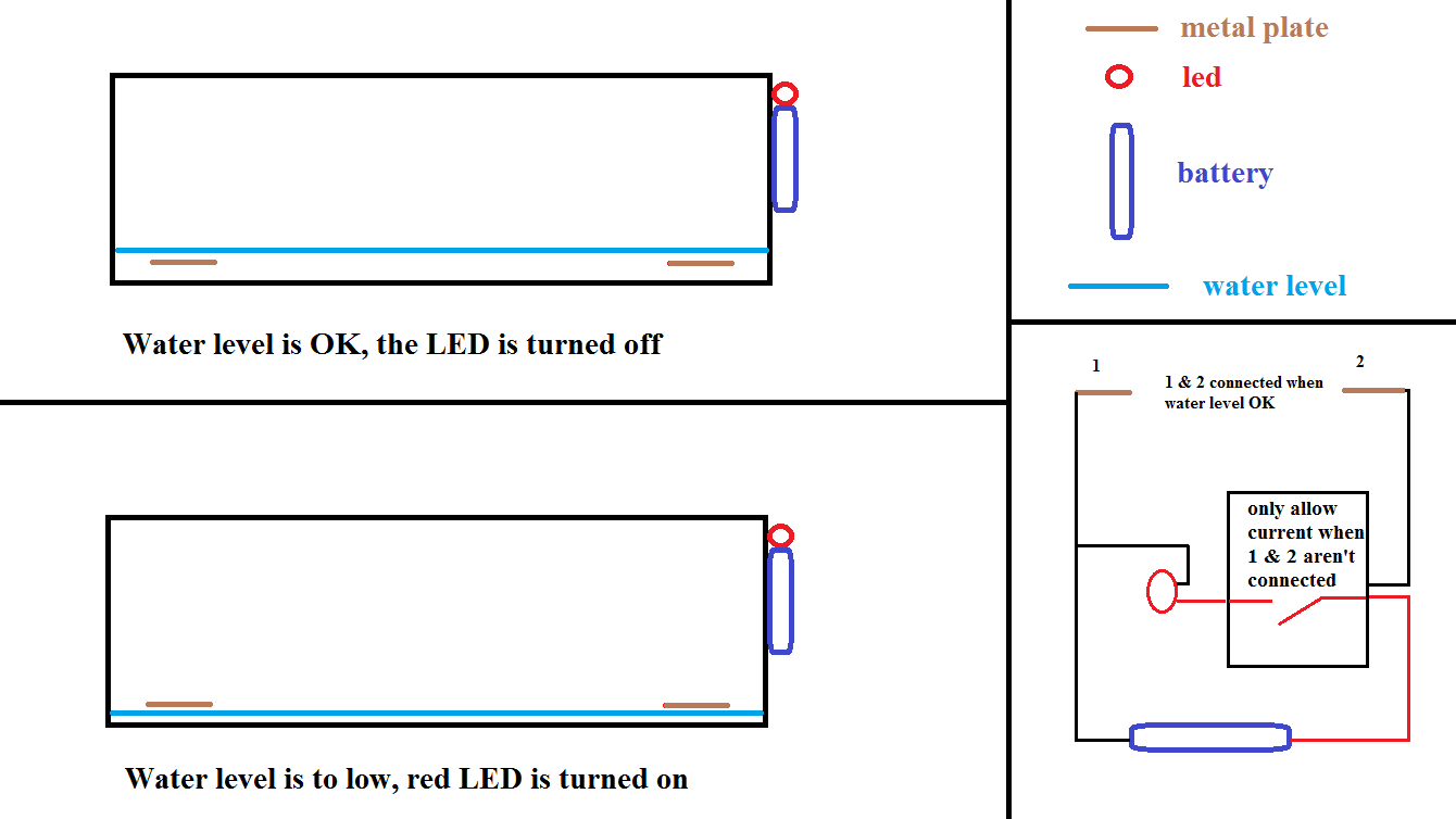

I am trying to make an easy way to alert me when i need to water a plant - a red led light. For now i am trying to do it without external power or solar panels - batteries only. I have everything figured out except the element that will detect when contact between 2 points in soil no longer conduct electricity and switch on the led light powered by battery.
I could do that using a relay, but relay consumes a lot of energy, it would drain a battery very soon. I would like to keep the energy usage zero or minimal unless the led light needs to shine. In a way i would need 2 elements:
1) something like relay, but made for small currents that uses very little electricity
2) a negation element of sorts - because lets say i have a relay, when current can flow between 2 points in soil (water level OK), it can therefor be used to switch on the relay and the led light will turn on. But that is not what i need - i need the exact opposite, i need the relay to turn on when current cannot flow between 2 points.
The solution is probably very obvious to most with knowledge, i hope you can direct me in the right direction.

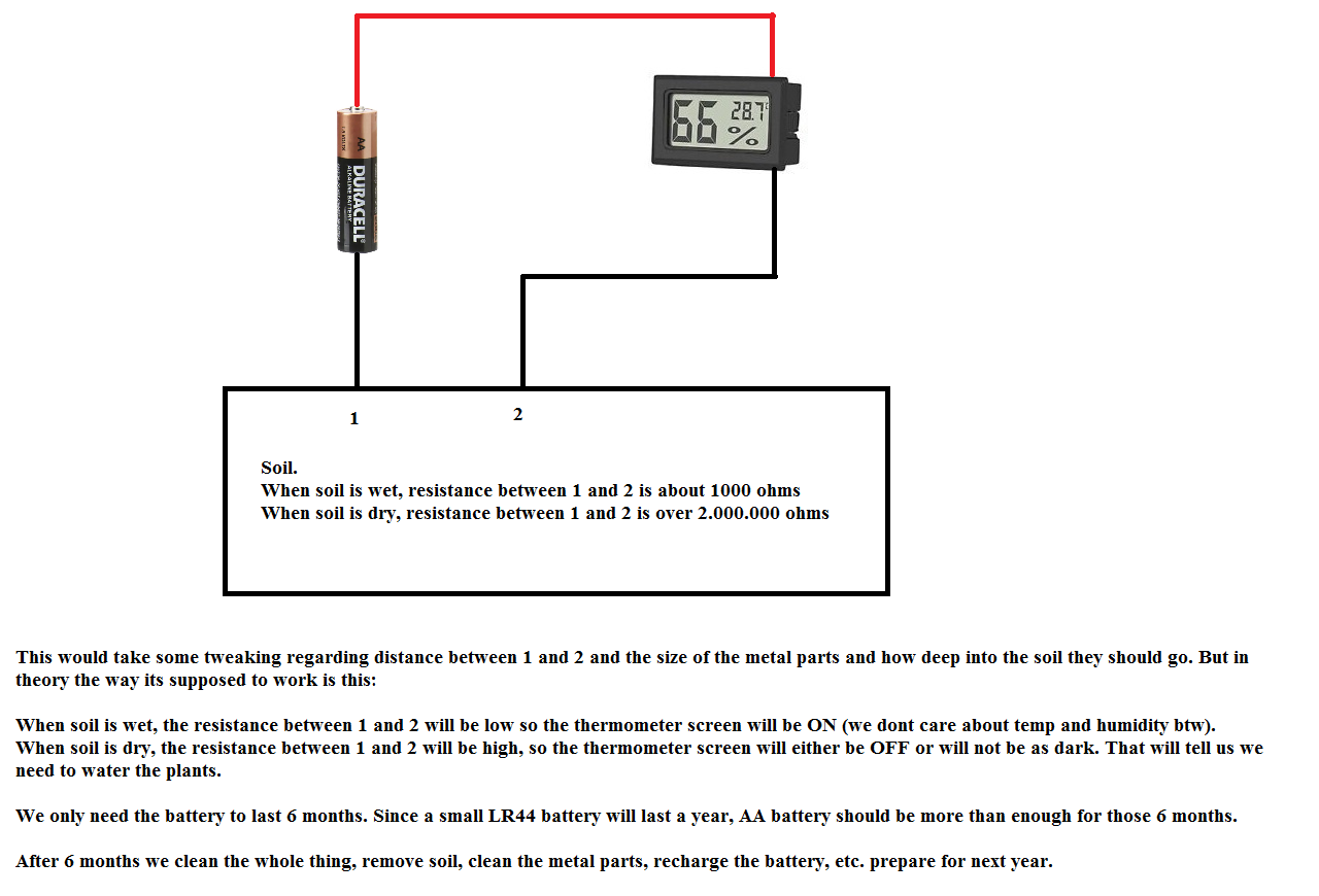

Before i ask about a mosfet, i had another idea ... instead of a LED light i could just use that cheap thermometer/humidity meter i have. This small meter can last a year on a single LR44 battery, which means it will last a long time if i use AAA battery. I only need the battery to last 6 months, after that i clean all parts and recharge for next year. Could this idea work ? Resistance of this screen thermometer is 4.300.000 ohms.

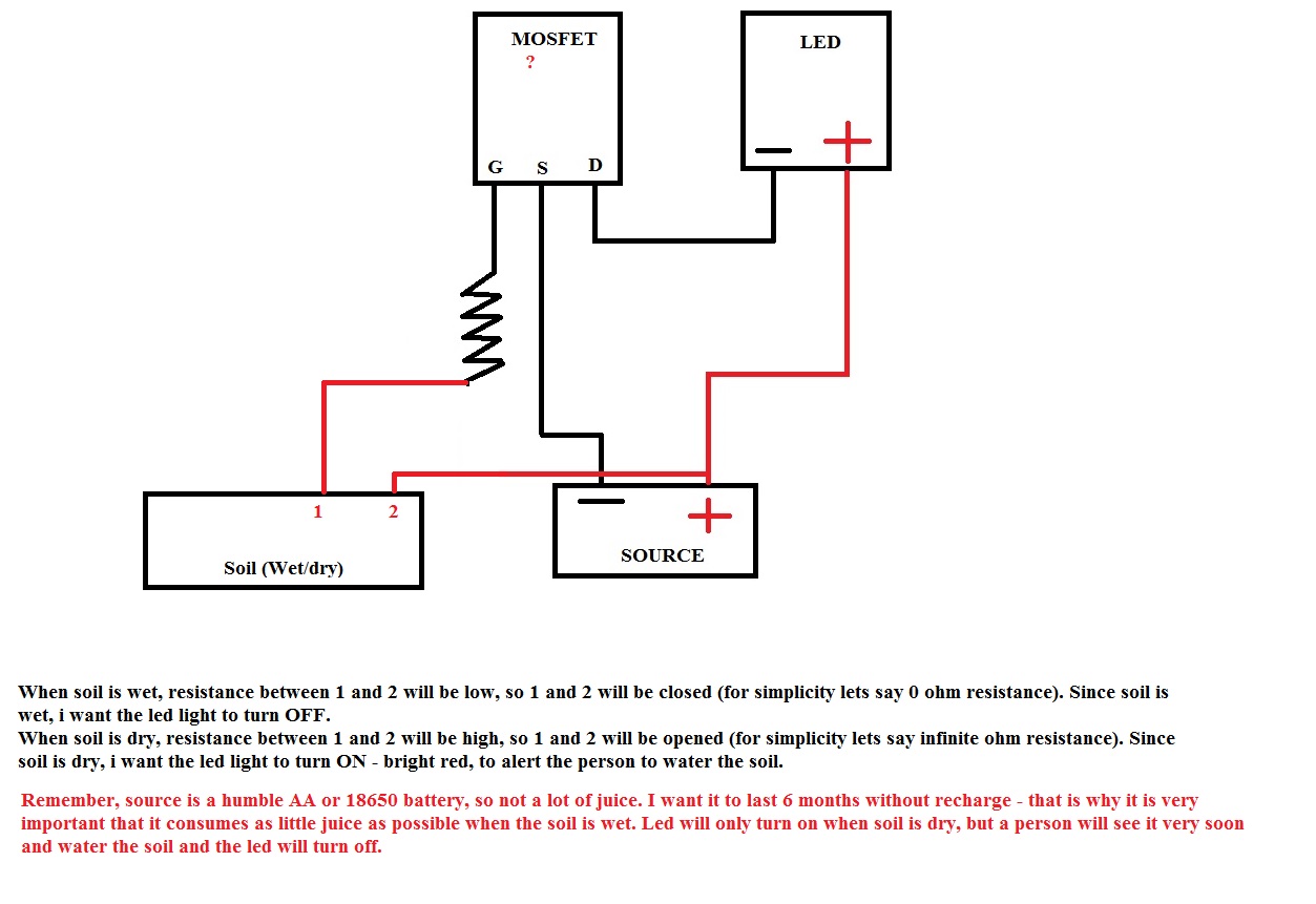

Ok, since no one responded to that simple idea i will ask about mosfets now. Kerim, you mentioned the mosfet for this job. I did some searching and i understand kind of how mosfets work now. If chatgpt is correct, the switching action of the mosfet is insanely low cost as far as energy consumption goes, it can do many switches on a single battery (though i doubt that is correctly calculated ... chatgpt said if a mosfet would switch every 3 minutes, it would take it 273 years to use 2000mAh of juice. That seems excesive). Ok, so here is the text and scheme. Now i need to pick the correct mosfet and understand how long a 2000mAh battery will last.

MOSFETs do not work like that.
To do what you want, connect the source of a FET to power (battery) negative, the drain to the negative of the indicator or sounder, and the positive of the indicator/sounder to battery positive.
Add a high value resistor between gate and battery positive, so the FET turns on with no other connection.
Connect the electrodes in the plant to the FET source and gate. The electrodes should be stainless steel wire, to minimise corrosion.
The MOSFET must be a type that will turn fully on with a gate voltage less than the battery voltag.
If the moisture (and conductivity) is enough to keep the gate below the threshold voltage, the FET will stay off.
As the moisture level drops, the gate will go more positive and the FET start to turn on.
Try a one megaohm resistor between gate and power to start with & see if that is OK, too sensitive or not sensitive enough.
To reduce power consumption and electrolytic effects, you could add a CMOS oscillator to generate short pulses every few seconds, and feed the gate resistor from that instead of positive power.
That would also then give a flashing or pulsing alarm signal rather than a continuous one.
