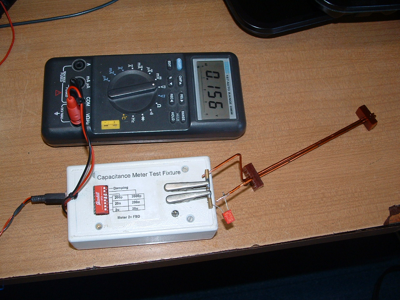

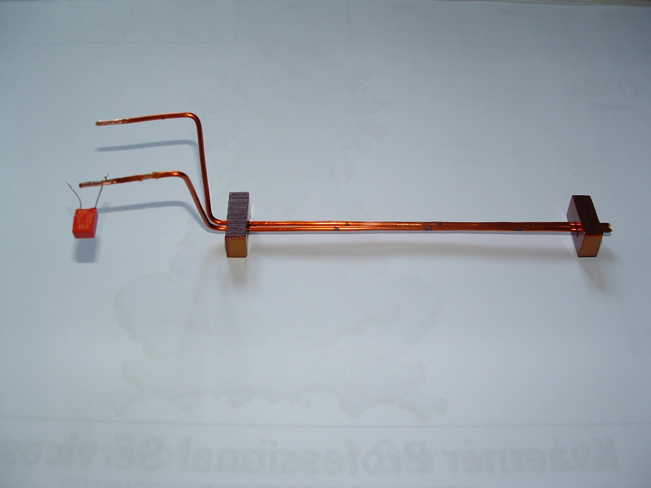

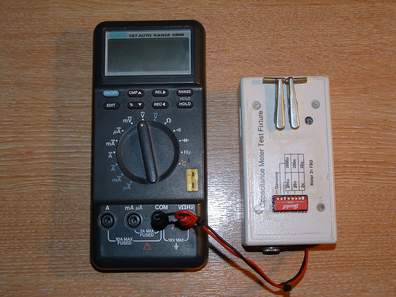

My interest has been awakend by this thread and I thought that I would try to measure the change in capacitance caused by various fluids.
I made a probe which would lay in a shallow plastic tray.
The probe consists of two enamelled copper wires, 2mm daimeter and about 240mm long, bent into a Z shape.
The wires are supported by two paxolin blocks, the wires pass through holes in the blocks, the holes are spaced 3mm apart.
I connected the probe to my capacitance test jig, the capacitor in the photograph is there because the enamel on the wires is damaged and there is a DC leakage path between the wires. My test jig has a small polarising voltage between the terminals, and the electrolytic effects can be seen as a drift in the readings when the probe is in water.
The results I got are as follows:
Probe disconnected      4.7pF
Probe in air                16pf
Probe in tap water      416pF
Probe in sunflower oil  25pF
Probe in mineral oil    21pF
So we see there is a big change in capacitance between oil and water.
I dont have any soluble oil to test this out any further, but as a basic concept for a measuring system, I think that it is in with a good chance.

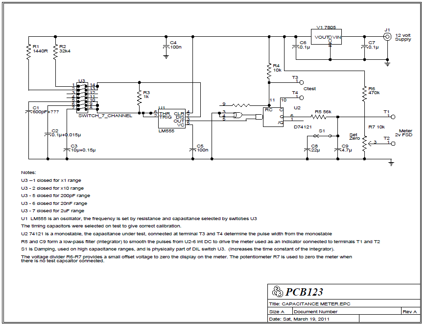

Hi Jim,
I have found this thread very informative and your method does seem to prove the difference a capacitive levels in fluid. If one is to measure the capacitance on new fluid then when a change occurs it can be shown. My mate owns a cnc machineshop and he did or still does have a major problem with rust forming on his machinery. He has had the coolant rep around and the last time I saw him the problem was still there.
With your experience I feel both myself and the OP will benefit if you could draw a schematic of a circuit to measure the capacitance of fluid it would be great.
Regards Bryan

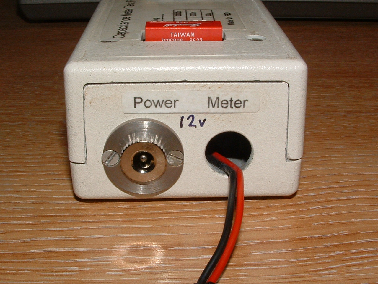

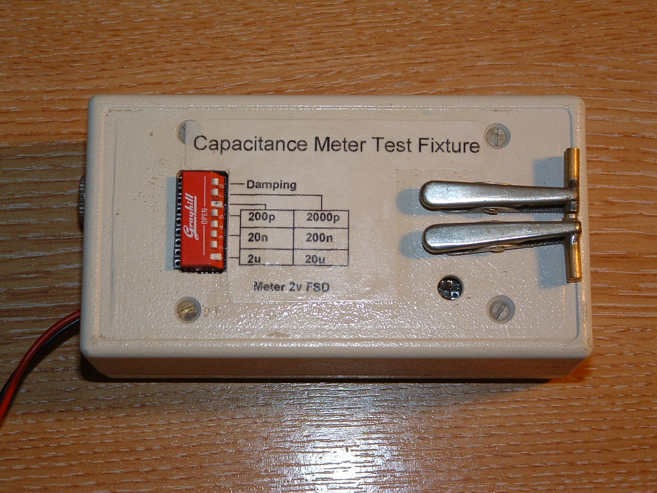

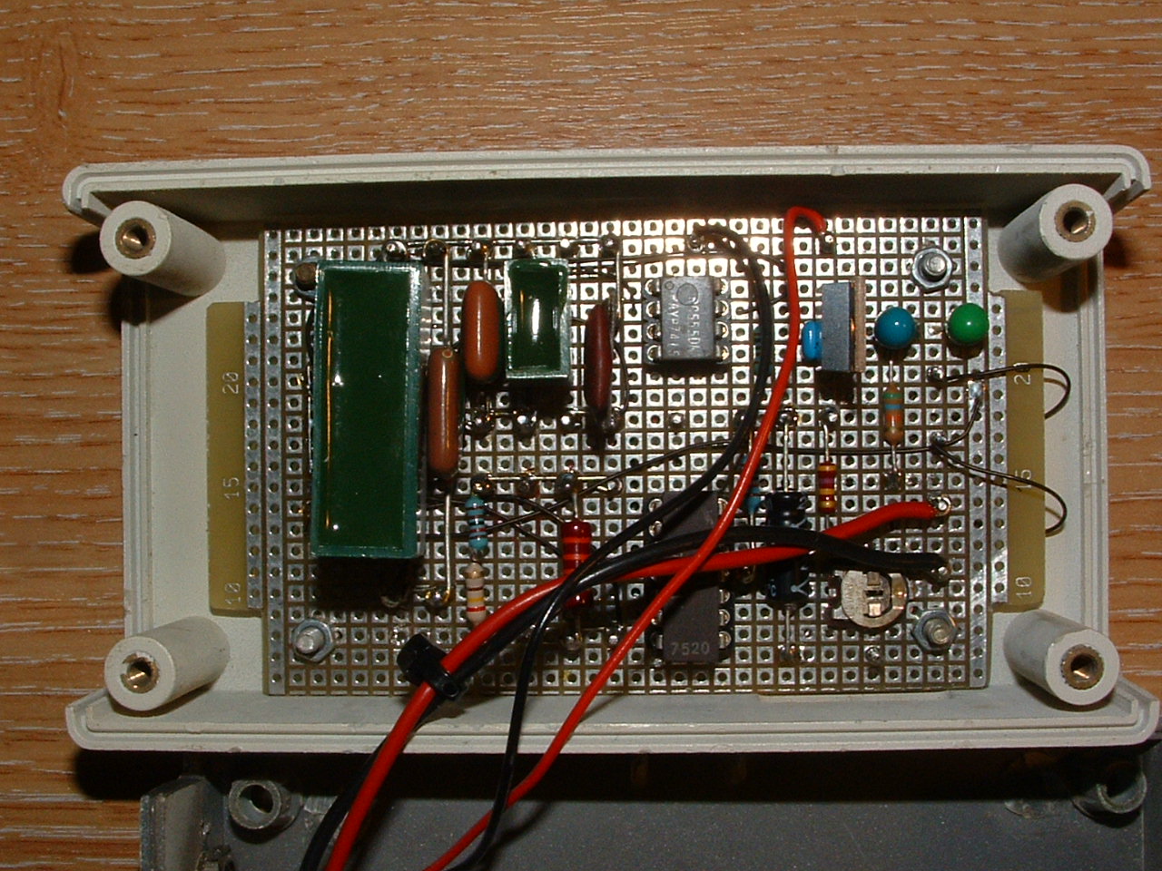

Fastline contected me by PM and after a few exchanges I agreed to show details of my capacitance meter test fixture which could possibly be adapted to feed one of the analogue inputs of his PIC which he is using to deiplay various parameters.
So, here goes...
JimBs Capacitance Meter
Most of the detail is as per the attachments.
The output voltage seems to saturate at about 2.1 volts which is OK as I normally use a voltmeter on its 2v range.
When there is no test capacitor connected, there is a small output voltage, this is backed off by the potentiometer circuit R6, R7, which means that the -ve side of the meter is floating above circuit ground.
This is OK for me as I use an isolated DMM, but for a PIC this may be a problem as the input is probably referenced to PIC 0v.
However it may be just as easy to forget the backoff circuit and sort out the zero with a calculation in the PIC.

Is there an alternative for the 74121? I have a hard time finding this monostable multivibrator with Schmitt-trigger input. Would the 74hc4538 be a possible stand-in? Anything else?
EDIT: old thread, sorry, I wil post as a new thread
